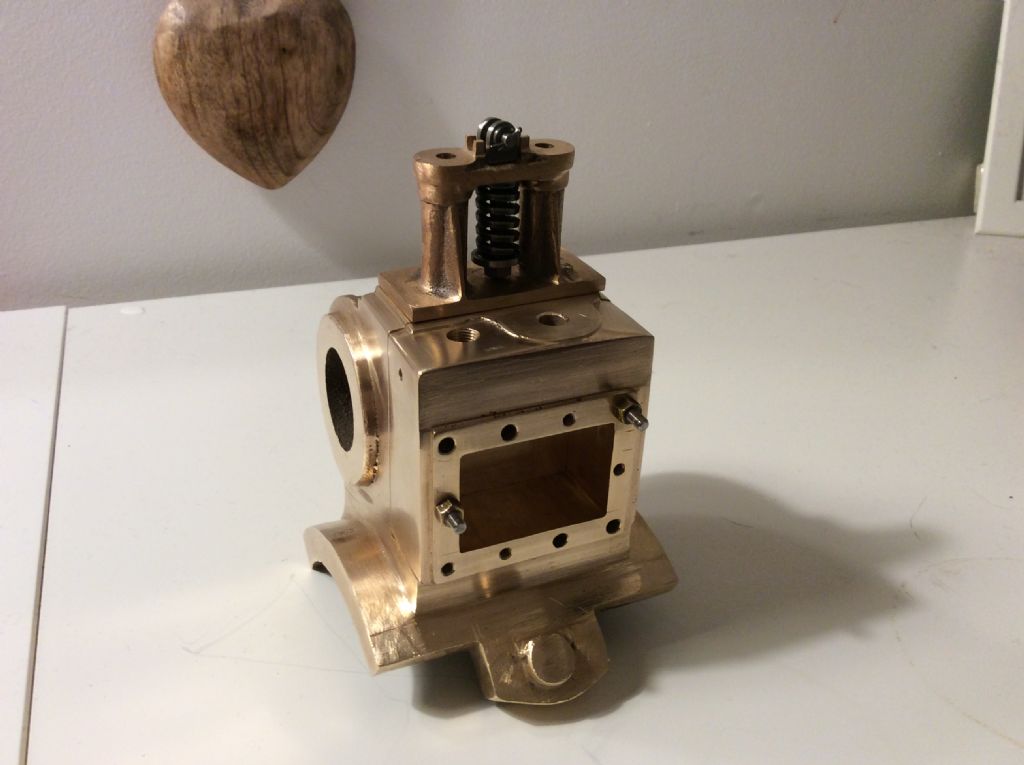

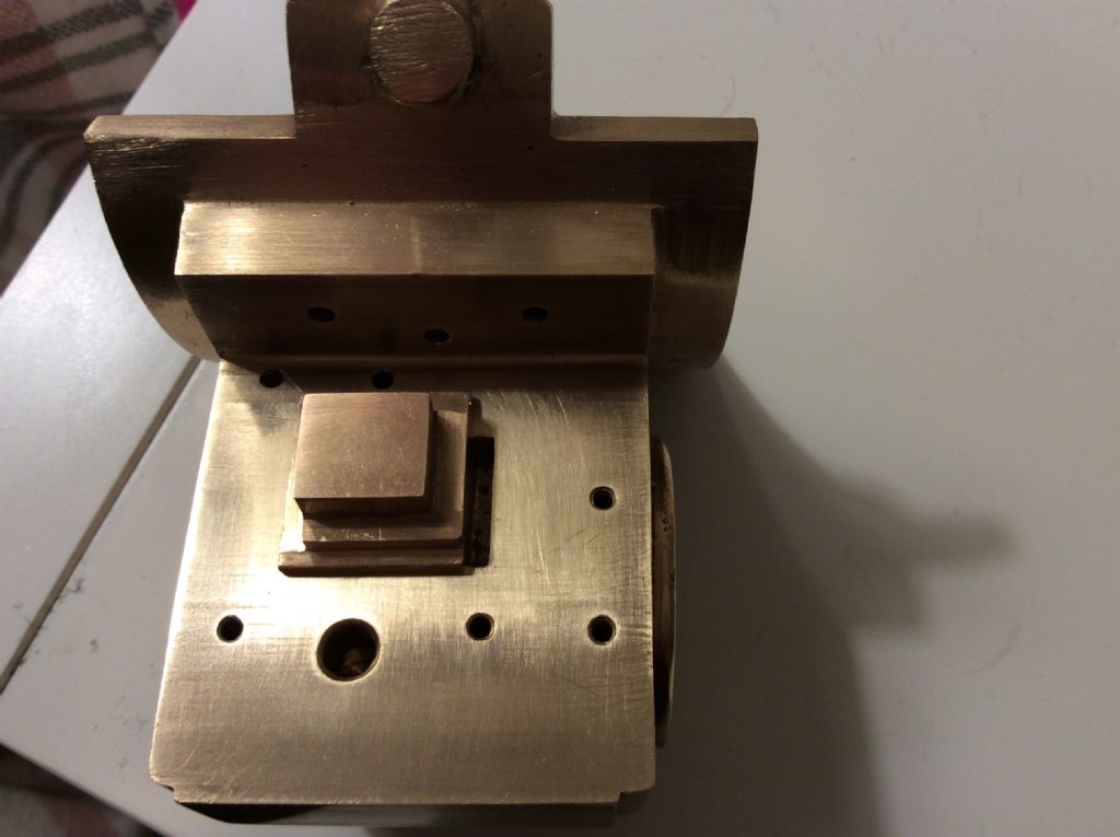

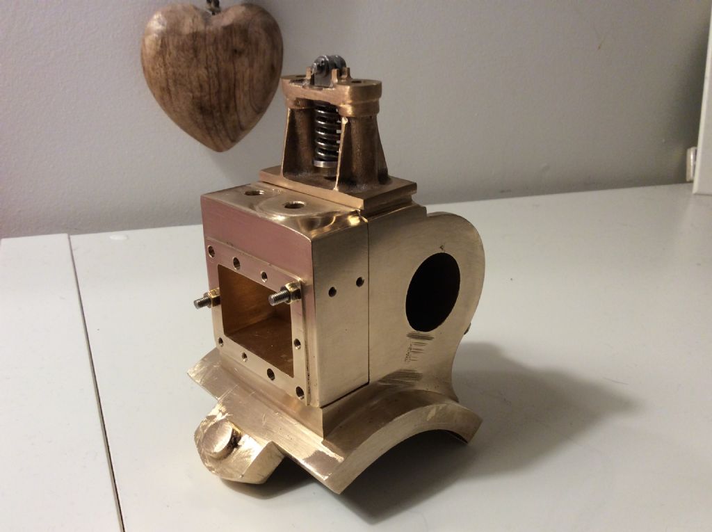

            Hi
            Just a couple of cylinder pictures today, clean up and drilling’s so far going well thanks to everyone’s help.
            Pleased considering I have no milling machine
            #391223
            Brian H
              @brianh50089
              That's looking very good Derek, well done!
              Brian

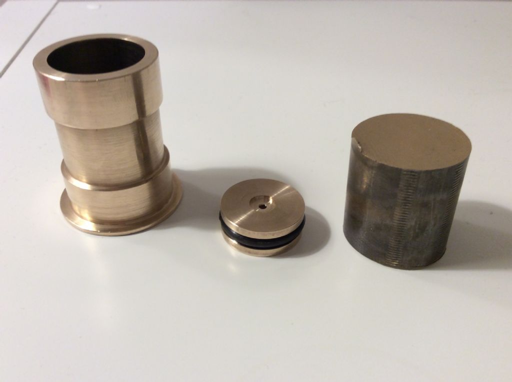

                #391757
                derek blake
                  @derekblake72550
                  Happy weekend all.
                  So I’ve had a go at the piston, please bare in mind I’ve never done any of this before so if you see an obvious mess up I won’t take offence if you tell me.
                  Piston is a sliding fit in liner and with O ring fitted I can hear a suction noise so I’m hoping I’ve made it correct.

                    #391761
                    Paul Kemp
                      @paulkemp46892
                      Derek,
                      Sounds about right. Couple of off the cuff comments; previously when making pistons I have roughed out the blank including the centre hole / fixing arrangements and ring grooves and then mounted the piston on its rod and held the rod true in a collet or clocked in the four jaw and finish turn the details to make sure everything is concentric and square with the rod. Good test is mount the piston on its rod, put your hand over the end of the liner, pull the rod / piston and release, the piston should return to the initial position or thereabouts if there is no or minimal leakage.
                      Paul.
                      #391762
                      derek blake
                        @derekblake72550
                        Hi Paul
                        Thank you for your comments, I’m pretty sure I’m all square but I do need to attach every when I get a 5ba tap to attach rod.
                        If I’m wrong at least I know what I’m doing next time, when rod is threaded on I will try the suction test to see if fitted well.
                        Many thanks Derek

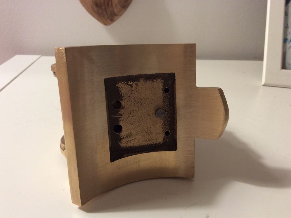

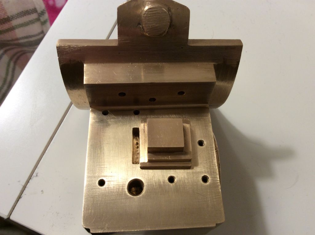

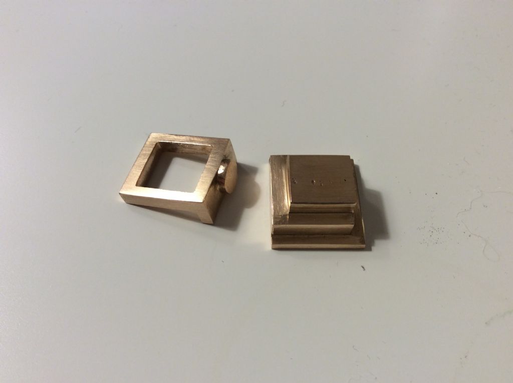

                          Slide valve and buckle hand filed, 5 hours work but not 100% sure I won’t need to start with a new one as there is a tiny amount of twist if you rotate the two pieces when together.
                          #392126
                          derek blake
                            @derekblake72550

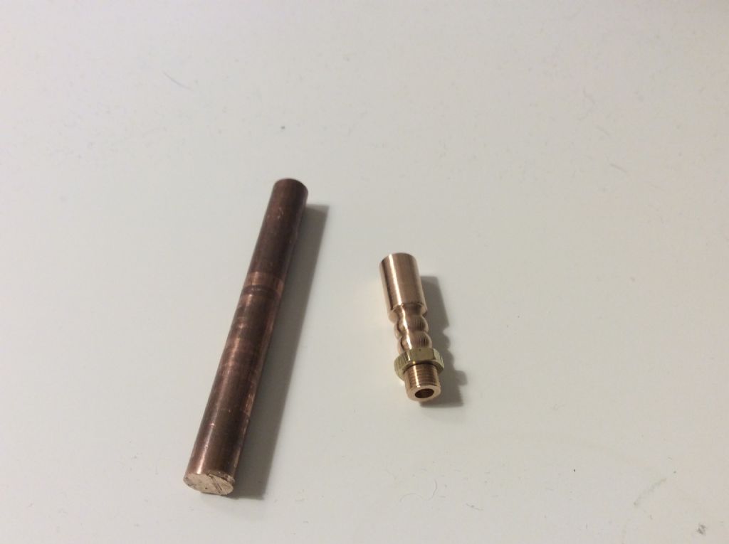

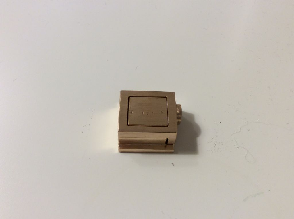

                                    #393248
                                    derek blake
                                      @derekblake72550

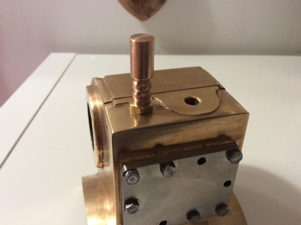

                                      Abit more work done, couple of failed attempts but got there in the end.
                                      Oil lubricator turned with files, saddle machined to shape by hand filing away the mass of material and finished to size by rubbing against boiler barrel with wet and dry glued on.
                                      Has worked great from what I can see, no lathe to flycut so this was my way of working around the lack of machine.
                                      5 hours work instead of 1 but got there in the end, I’m sure some will say I’m mad and it’s not the correct way which of course I agree but it’s the way I could do it.

                                          #393284
                                          Paul Kemp
                                            @paulkemp46892
                                            Derek,
                                            Well done. The only 'wrong way' to do something is the way that doesn't work! We all have to make compromises at some point even with a reasonably well equipped shop! The use of hand tools and hand fitting is much under rated!
                                            Paul.

                                              derek blake
                                                @derekblake72550
                                                Evening all.

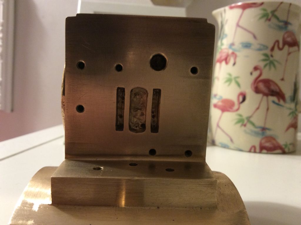

                                                Well I’ve gone from proud to feeling very sad and stupid, looks like I’ve ruined the cylinder after all the work.
                                                I had to chain drill and Dremel and file steam ports as I have no milling machine, however in doing this it’s not as accurate as it should be and the middle two section is thinner than it should, the separating splines for a better work should be 3/32 but mine come in at 2mm each, add that to the undersized 1/4 hole and my valve when sat in the middle covers exhaust and leaves open the side ports by half way.
                                                Looking at the drawing and what I can others have done this valve when central should cover exhaust and the side ports but only allow steam into the valve steam space.
                                                The way mine is steam could get down the side ports as my valve hangs over them half way each, I feel abit sick and disappointed in myself today.
                                                Only thing I can think of is to get someone to machine a slide valve in the future with a thinner exhaust space so that it will only cover exhaust port when central, but not sure even that a fix, one positive is the width of all three ports together is correct st 15.87mm this part is fine, but the two spacing being undersized has left less material for the valve to sit on when central.
