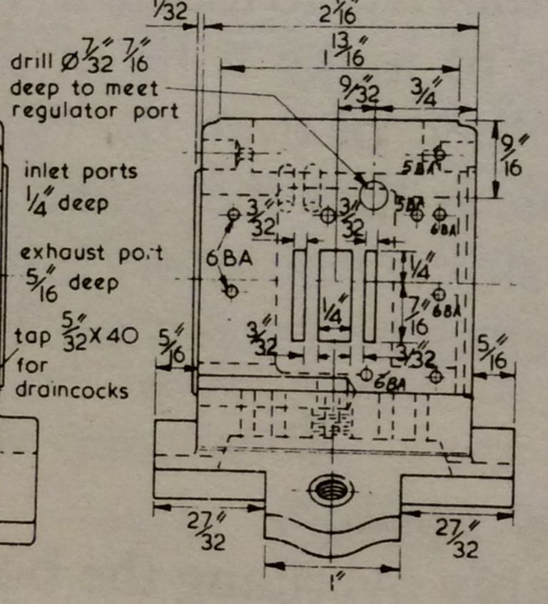

        Hi
        I have a quick question if that’s ok, I’m not sure if anyone has the Allchin drawings but I’d like to fix the valve chest to the cylinder and I’ve drill the through holes in the check marked A but I can’t see how deep into the cylinder I need to drill ready for the tap and 6ba stud.
        Can anyone assist on depth?
        Thank you in advance.
        Derek
        #390747
          I would say you could drill 5/16 and that would allow 2 x diameter of thread without trying to get right to the bottom of the hole, 1.5D would be OK into a 1/4" deep hole.
          #390749
          derek blake
            @derekblake72550
            Hi Jason
            So I understand are you saying drill around 7-8mm deep on the A holes?
            #390757
              Yes that looks OK for the top and bottom pairs, probably 6mm for the two closest to the centre line but check what thickness you have now that the main casting has been bored out larger.
              #390759
              derek blake
                @derekblake72550
                Thank you Jason, I’m normally good with drawings but I can’t see any depths for these holes and even others.
                That’s strange to me, but I maybe mis-reading it.
                I will drill the 6mm deep ones for now, many thanks

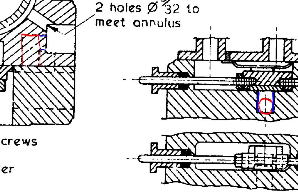

                  Hi All
                  So I’ve drilled holes to hold valve chest, all went well except when drill snapped but managed to remove.
                  I’m a little stuck on next move and I’m afraid I’m may have to ask before drilling too many more holes, the attached drawing shows a 7/32 hole to link up with regulator port, now my question is I guess this must not go into the annulus?
                  Kind regards Derek
                  #390888
                    Only needs to go in far enough to meet the small rectangular regulator port, it's the hole I have marked in red with teh port in blue
