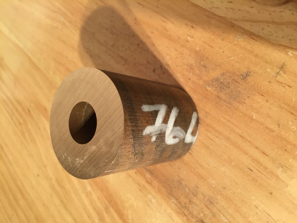

      Ooops! Sadly a hazard of the hobby. I don't think I would bother with another casting but get a lump of cored bronze of the right proportions and chew it out of that. You can get cored bronze in various O/D – I/D combinations and it will almost certainly be cheaper than a casting from a model supplier. I have bought from metals4u in the past, they sell by the inch. Doubtless there are other sources. I think I would bore the block first and then turn the liner to suit, needs to be a good fit so steam can't leak from the anulus, you probably need around a thou to thou and a half interference fit on that size.
      Paul.
      #389925
      derek blake
        @derekblake72550
        I think Jason said Sa660 is a good bronze to machine, so I will look to get a piece ordered.
        Thank you
        #389940
          Agree with Paul it will be better to use hollow bronze, M-machine are another source and Macc who advertise down the right of the screen
          #389946
          derek blake
            @derekblake72550
            Thanks Jason, will the SA660 be ok as I’ve found sound.
            Regards
            Derek
            #389948
              Yes that's fine for cylinders and liners as well as your other small items, the LG2 from M-machine is OK for the liner

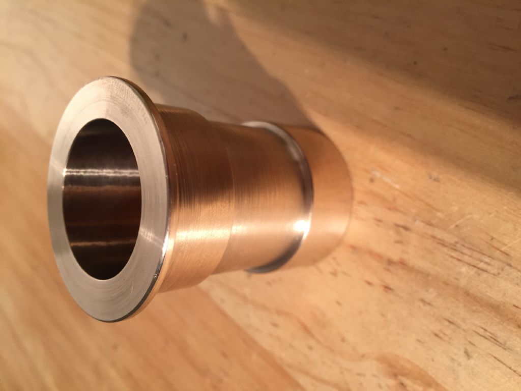

                Just a thought after reading this thread that might help Derek.
                As you've now got to machine a liner from scratch, would it be feasible to machine the cylinder casting right through at the bore of the designed annular space, and then machine the liner with ends that fit the larger bore but with the centre part waisted down a bit to make the annular steam space. Having a uniform bore through the cylinder casting would be easier than trying to machine the recess and machining the liner od down locally is just straightforward turning.

                  I think I'm with you, basically put the annulus onto the liner.
                  the width for the liner should be 1 1/4 inch so increase this by 1/16. then turn a annulus in the liner 3.1750 approx. deep all the round obviously.

                      But it does mean the cover stud holes are being drilled right on teh joint line rather than going into solid metal.
                      Annulus is 1/16" each side so would need to be increased to 1 3/8" which is the same as the PCD of the studs

                        do you think this would weaken anything? id imagine as the liner is a tight fit in cylinder the fixture would be pretty tight.
                        #389992
                        derek blake
                          @derekblake72550
                          Hi Jason
                          So are you saying liner would need to be 1 3/8 wide instead of 1 1/4 but with the 3.2mm deep annulus.
                          I would them bore the cylinder to 1 3/8 to match liner ends.

                              Ends of liner would be 1 3/8" diameter, middle of liner 1 1/4" diameter so it is no thinner than original Cylinder bored 1 3/8". It is just the stud postions on the joint that are not ideal

                                  Would it be safe to use Loctite 638 on the liner to assist the screw fixings?
                                  its temperature range is way above what the cylinder would ever get to i think.
                                  The liner material will be here soon, so id like to be sure i know which option to machine.
                                  Many thanks.
                                  #390195
                                    I tend to use 648 for liners, bit higher temp to be on the safe side.

                                        The new idea and larger liner I will increase from 1 1/4 to 1 3/8 and into the liner I add the annulus at a 1/16 depth all the way round? For some reason I was thinking I’d have to double the 1/16 but that’s not the case looking at the drawing.
                                        I just need to leave both ends of the liner 1 3/8.

                                          material arrived so tonight is the night, I've drawn up what needs doing so hopefully all goes well.
                                          i will post a picture of the finished liner hopefully.
                                          Thank you for everyones help and the idea to machine this way.

                                            Evening all.
                                            Liner finished, hopefully new improved version.

                                            Jeff Dayman
                                              @jeffdayman43397
                                              That's looking great Derek! well done.
