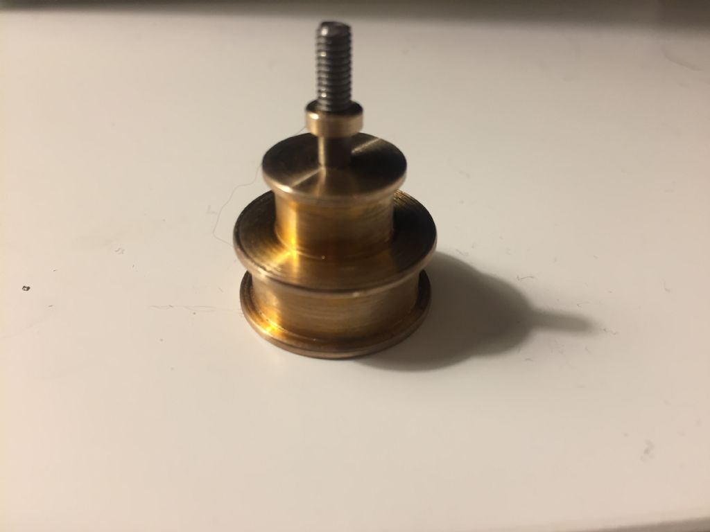

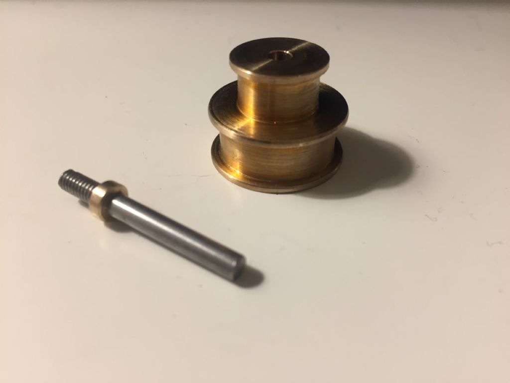

          #443037
          derek blake
            @derekblake72550
            dcbb95fa-3560-4a79-8963-04336d075d5d.jpegPulley wheel made, a lot of hand shaping as I had no tool to cut the recess but not looking too bad,
            still trying to source the correct size bevel gears but struggling.

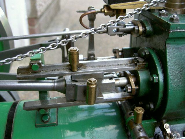

                              #456510
                              MichaelR
                                @michaelr
                                Are your bearings the spilt type ? if so you will be able to take up that very slight play, another area that can cause a knock is the cross head pin bearing, my D&NY engine always had a knock in that area until I fitted a lubricator as photo.

                                  #456514
                                  Clive Brown 1
                                    @clivebrown1
                                    Can you tell if it's once per revolution or twice? If it's once, could it be something like the piston rod gland backing off slightly to be hit by the crosshead? That might explain the sudden onset..
                                    #456516
