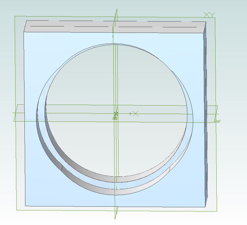

            Unfortunately mounting on the cross slide and using a between ctrs bar won't really work in this case as the anulus needs to be bored out larger in the middle so that steam can pass around the liner and up to the regulator, apart from that it is a good way to do it.
            If it can be done on a vertical slide then it is possible to move the casting up, down and sideways while the bar in spinning in the casting and produce a lobed anulus but needs care to not put too much of a cut on in one go. Or a boring head can be used as per the book.

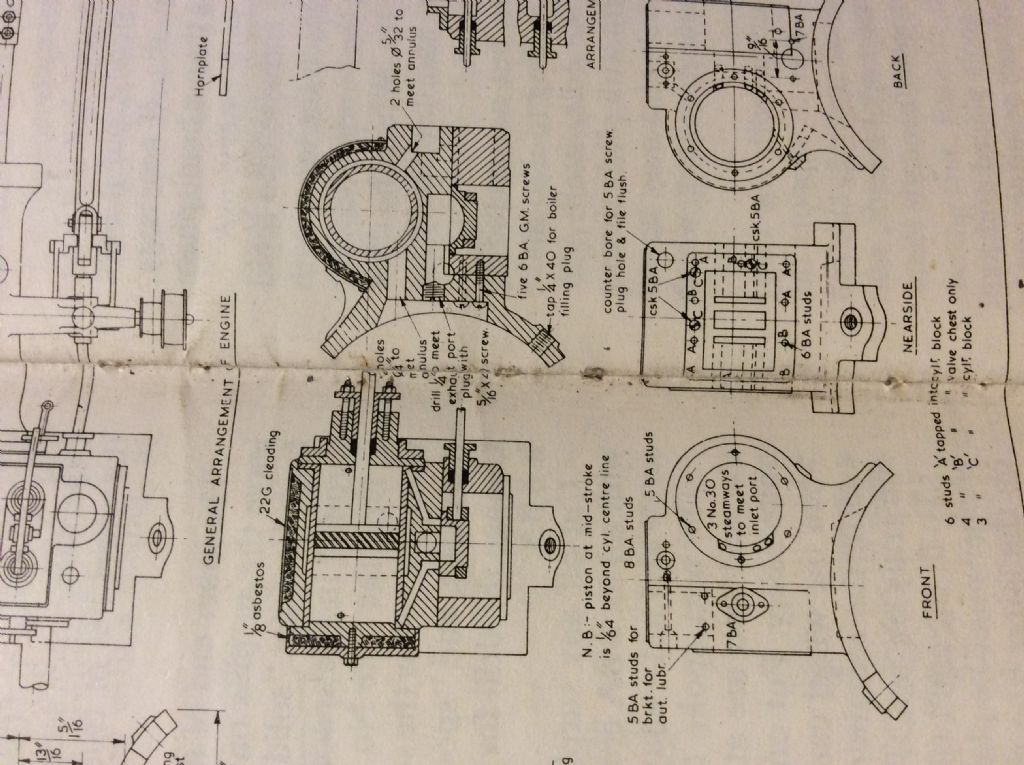

                just a quick question, if I decide to try and bore the cylinder myself I’d at least like to understand how it’s to be done, looking at the attached drawing and the annulus, would some of you drill the steam port with the liner left out? I would imagine this would be safer so you don’t drill into it.
                im not sure I will be able to set my lathe up to do it yet but it’s still interesting to know how things should be made.

                    I would drill it after the liner is fitter as the holes pass through both, as you will need drilling in from the ends you should not have any problems with the drill going astray.
                    Mill the ports before drilling then you can feel/see when the holes meet them rather than risk drilling too deep and joining up with the exhaust.
                    The hole up from the saddle and the angled hole to the regulator should be drilled before fitting the liner

                        I understand how to bore a basic through hole but how do you bore the bigger hole down inside the core of the cylinder, is the adjustment made on the cross slide when at the correct depth?
                        Many thanks

                          What method of boring are you intending to use?

                            I think I’d have to clamp the cylinder to the crossslide I guess with the small lathe I have.
                            #389743
                              If you set it op with what will be the rear of the cylinder facing the chuck then you can do the main bore with a between ctrs boring bar and also fly cut the end of the cylinder so that the cover goes on nice and true to the bore.
                              To do the annulas really needs a change to a boring head where you can put on a couple of thou cut and rotate the cutter round by hand then start the lathe and traverse along and back and keep repeating that which is the way Hughes suggests doing it in his book.
                              #389770

                                  I've just thought of another way it could be done.
                                  If you change the boring bit of your between ctrs boring bar to a more pointed one you can gradually offset the tailstock a bit at a time which will make the tool swing a slightly larger radius. Then just proceed as with the boring head little tailstock feed, cut back and forth then put on another cut and so on
                                  If you can't offset your tailstock or don't have a boring head to fit it then a home made centre in the 4-jaw can be offset instead of the tailstock as Paul describes.

                                    The other method I mentioned earlier if the cylinder were on a vertical slide so that after boring to 1.25" you just move it up, down, in and out by 1/16" to get a 4 lobed cut would work quite well. I have sketched it out and there is very little loss of cross sectional area so a viable option. I suppose if you did not have a vertical slide you could do front and back at the same set up on the cross slide as the main bore and then rotate the casting 90 degrees and repeat to get the 4 offsets.

                                        Given the 'non critical' nature of the annulus if you used Jason's 4 lobed method you could always use a small rotary burr carefully and gently after to clean down the high spots if you are concerned re any reduction of CSA.

                                              Regarding the 4 lobed method restricting flow, you will get 68% of the original area but as this is almost twice the combined area of the two holes up to the regulator chest it should not be a problem
                                              #389859

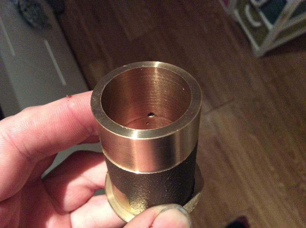

                                                    I’m not ignoring your message but want to show you all this annoying flaw in my casting, spent 3 hours machining and a hole appeared in the liner, I guess it’s scrap?
                                                    There’s a valley in the middle I guess from this hard spot but possible I could take bore slightly bigger to take this away but I’m guessing there’s no way around the hole which will open up completely once the outside is machined.
                                                    #389918
                                                    derek blake
                                                      @derekblake72550
                                                      There is actually 5 other little pits inside the bore, sadly this was a casting from an online auction so I will have to buy another new on sometime.
