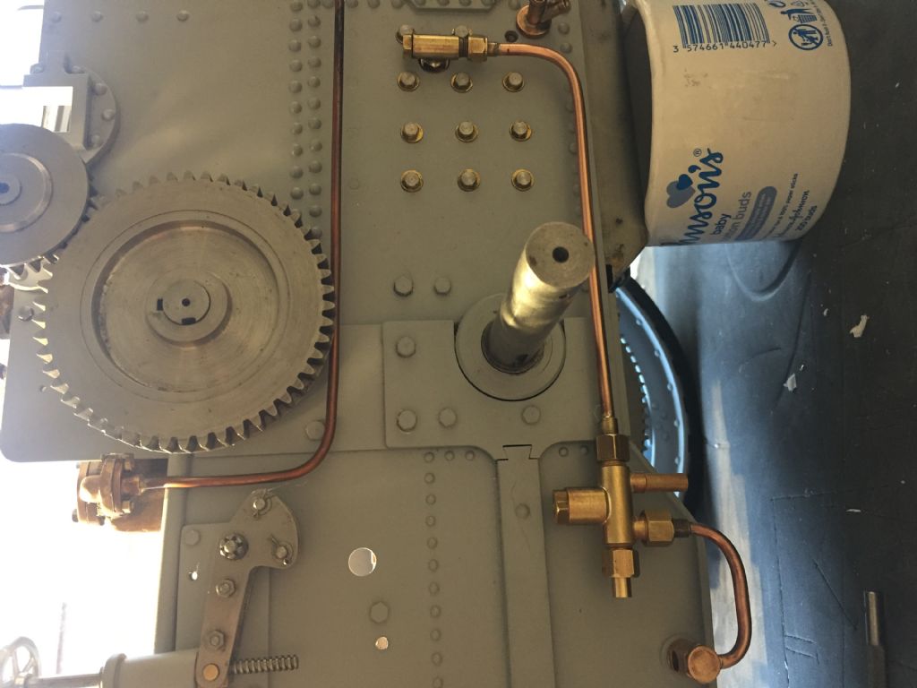

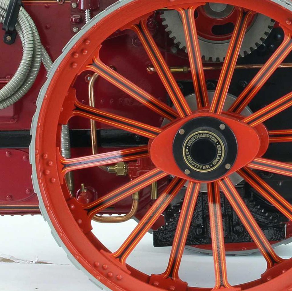

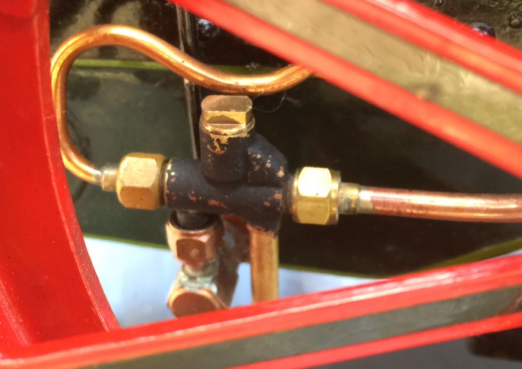

                I’m also looking to plumb in a commercial injector, the water fitting in the bottom on the commercial is obviously different from the side fitting on the drawing.
                this would mean some sort of adapter or to make a pipe work join maybe placing the injector slightly forward.
                Do you require the injector to be in a certain position for the water to flow, it’s hard to explain but could I do a pipe from the end of the water valve in a down loop and up into the water inlet.
                one idea is like the below picture, someone has made a commercial fitting into the original drawing water valve.
                Derek

                        Here’s my idea for the injector fitment, to copy someone else’s design…
                        #437189
                        John Baguley
                          @johnbaguley78655
                          Hi Derek,
                          Steam Fitings also do smallish globe valves that you may be able to adapt:
                          Globe Valves
                          I bought a couple of the 1/4 x 40 size for an injector testing boiler. I can measure the diameter if it would help.
                          Your idea for the water feed for the injector should be fine.

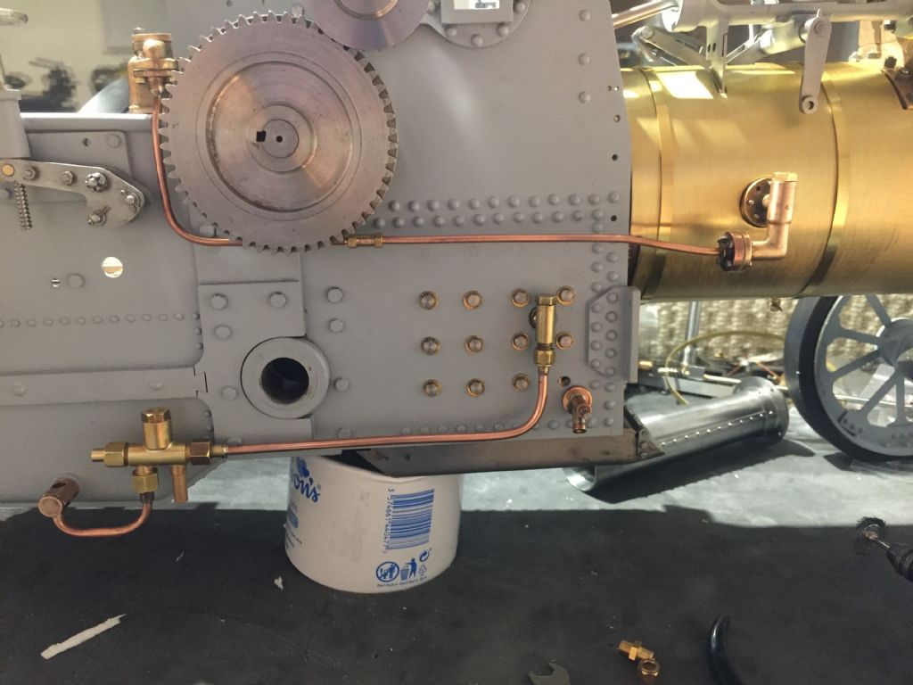

                                  So I’ve done some plumbing the same as the previous picture and another builders idea so I’m guessing it should work.
                                  hopefully the water will run into the injector OK. Not sure how to turn the picture.

                                      Pipework for the injector has been done with 5/32mm pipe, 1/8th for the water pump.
                                      hopefully this will be ok, I checked other models and they seemed to do the same.
                                      im going to fit just one globe valve for the steam feed to injector, as I don’t need the other globe valve as I’m not fitting the water lifter.

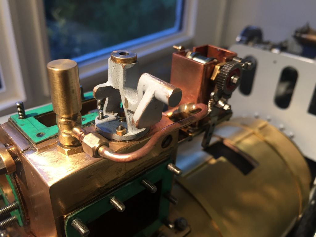

                                          Small update today, I’ve been concerned that the exhaust plug in the base of the cylinder wasn’t steam/airtight as I had air god up the chimney on its test with the ports closed.
                                          i did think I could remove the cylinder but thankfully all went well and this plug is now secure.
                                          on the next air test, possible reasons for leak up the exhaust as suggested kindly by John is likely the valve or regulator.
                                          i had no control over speed on my last air test so I think I need to concentrate on lapping the regulator against its face and see if I can get a better seal.
                                          its possible that I have a leak from the valve chest to exhaust I’ve used gasket and liquid gasket so I’d be surprise, hopefully the work on the regulator will solve the leak.
                                          other than taking the engine apart no real step forward, however I do have more pipe coming to plumb in the globe valve to injector.
                                          that will be the plumbing sorted after that’s done, and next air test will be due.
                                          updates soon…

                                            So I was unsure if I had sealed the exhaust blanking plug well enough so to make sure I was OK, I removed the cylinder this week.
                                            i was scared to death it would cause issues but I was lucky and it removed well, while it was off I replaced the three bronze studs and changed them for stainless as per the other fixings.
                                            blanking plug was hard to remove so I think it was actually ok, but I added new steam seal loctite and covered the hole with Jb weld just to be 100% sure.
                                            cylinder refitted this evening, what I’m struggling with is the oil lubricator the pipe as per drawing is tiny so is this the correct pipe? I’m also struggling to make the fixings as well as actually getting the oil to enter the cylinder.
                                            i think it’s to do with the ball and spring which maybe too strong, so I’m going to have to start fresh and make a new parts and try again.
                                            has anyone any info on pipe size or how to make the fixings for these pipe ends as I’m assuming you can’t buy bits that small.
                                            i appreciate explaining in a message is difficult so no problem if no comeback on the questions, weekend work involves finishing pipe for the steam valve to injector which I’ve positioned next to the pump.
                                            i couldn’t find the correct size valve for pipe so this position should be fine for now, it’s not to drawing of course but I’m more for making a working engine over a 100% to real engine model.
                                            as I become more skilled I hope to make these valves in the future….

                                              after this fiasco I worked on the plumbing again and have pretty much finished the injector, so other than get the water pump setup on the eccentric and fully working I think it’s close to sealing every steam joint and trying again on air.
                                              i will add some pictures in due course for anyone who maybe interested.

                                                Been watching but not logged in much to reply! On your horns I can't think of an easy way of correcting the stay holes, there are ways of doing it including welding them up and re-drilling but that is likely to introduce distortion. You could machine up stepped bushes and counterbore the plates to suit but again will be time consuming and won't be invisible to close examination so unless anyone else has any bright ideas for a simple fix I think you are stuck with what you have unless you want to make a new pair. Hindsight being a wonderful thing there was another way to mark those holes for drilling using a threaded point screwed into each hole in turn and a whack with a hammer to transfer the mark. Careful measurement for the first hole, secure with the first bolt and a dummy crank and axle to get the alignment with your screwed point in one stay, whack with hammer to transfer a mark, remove plate, centre punch mark proper and then drill, refit for the next ad finitum till you have them all! The way I did my half size was mount the boiler up on the horizontal borer, locate spindle over centre of stay, clamp the plate on lined up with the dummy crank and axle, drill the hole tapping size, remove plate and open hole to clearance, refit with the bolt having centred up to the next stay and repeat ………. Took me about 4hrs a plate but they were all in the right place bang on the centre of the stays.
                                                Injector plumbing looks fine. Small lubricators well made are usually capable of producing quite high pressures when dead headed so I doubt the spring is too strong. NRV's are a bugger to seal usually so I doubt that is your problem either they are more likely to leak back than block the flow altogether. Start at the lubricator making sure that delivers oil at its outlet (remember steam oil is thick, thin oil in the lubricator may not give the best performance!). If you have oil at the lubricator outlet, put the pipe on it without the valve and see you have oil through the pipe, then connect the valve and confirm it passes the valve. The most likely cause is the pipe blocked by silver solder when you have soldered the fittings, easy done with small bore pipe!
                                                Can you not tap that stripped thread out to 5ba and fit a stepped stud? Would be more secure, will hurt if it blows out! Sounds like you have eliminated any potential leaks under the block now so you will need to make sure the regulator seals next.
                                                Overall from the pictures it looks like you have made a cracking job of the engine generally, that boiler cladding is excellent. It will be quite a buzz when you get it lit up for the first time!

                                                    Small update, I’ve made a new dummy lubricator with 3/16 x 40 fixing for pipe.
                                                    i made a 5BA to 3/16x 40 adapter the other end for the lubricator itself as seen in the attached picture, oil pumps into the valve chest so I’m pleased with the result.
                                                    admittedly not 100% to drawing but it work oil wise, hopefully the ball will work and no steam come up the other direction.aa9f2ce4-d0e3-4200-9be0-749d703b09ba.jpeg
