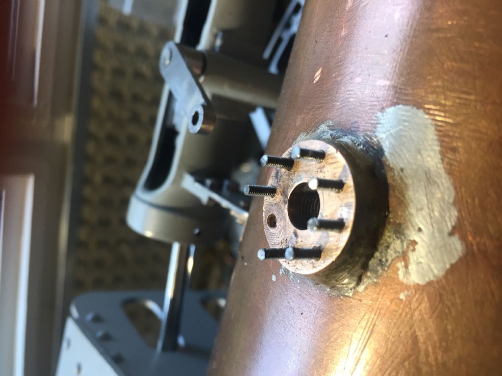

        Sorry Paul, what I meant was the stub is a push fit into the bush and then I will add the four fixing studs.
        what I meant was I couldn’t see a part in the drawing that says you need to make it a screw in fixing.
        the bush hole was over 1/4×40 already so I machined the stub to fit into the bush.
        i will then fix with the suds, I just wondered how well it would seal.
        Regards
        Derek

            #434870
            derek blake
              @derekblake72550
              Anyone who’s how to remove broken 10ba tap? I was tapping fixing and it snapped in the bush angry

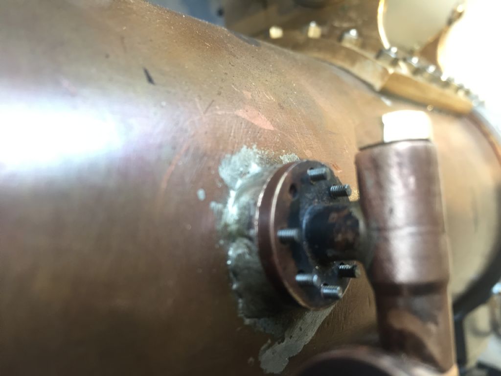

                  I removed to section of tap but piece stuck down the hole and you can’t drill taps especially this size, I will have to use 3 fixings and make one stud a dummy, pain in the bum, first tap broken in the whole build.

                            Unfortunately you will have to persevere here and get the tap out as 3 studs on a 4 stud PCD will equal a leak! The diamond dental type burrs come with some very small points but you will need a steady hand! If you can nibble the centre section away the threaded sides usually drop out. 10ba is a bit tiddly though!! Good luck.
                            I tried Alum once didn't touch the drill I broke, obviously the wrong sort of Alum!!
                            Paul.

                                Half hour with the dremel and no luck whatsoever, it’s like a solid plug down there so I can’t see a way or removing this tap tip.
                                so that opens up how I solve the fixing issue, I have three good studs inserted but will need to try and think how to solve the forth.

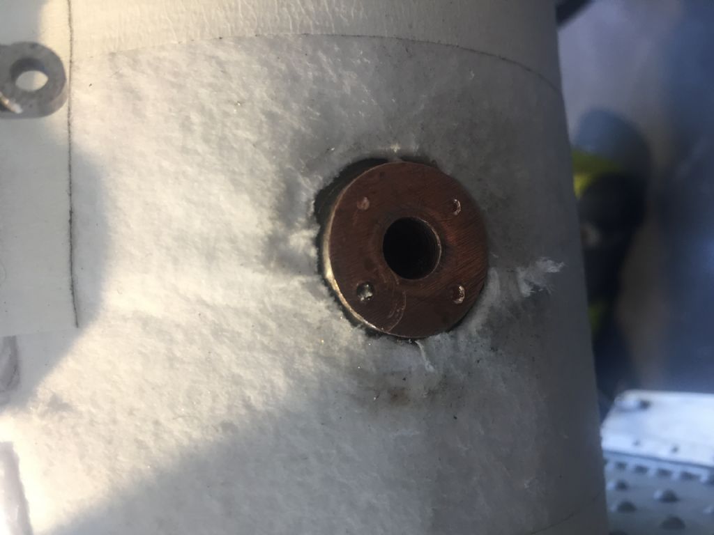

                                                So I did try the Alum but I felt that it just wasn’t working in the situation I had so I decided to take the next step and that was to drill more fixing holes, not to drawing but functionality is what I require now.
                                                hopefully this will keep it water tight, the hole with no stud will have a dummy fixing in the steam fixing,

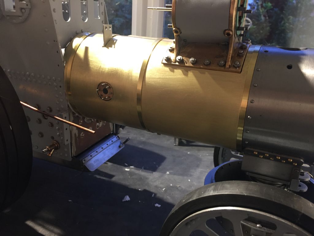

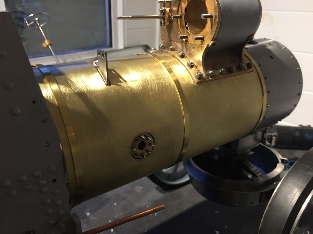

                                                    So pump clack valve made and seems to work, still some fettling to do so will post picture soon.
                                                    boiler cladding worked on today, pleased with the outcome as I found it very tricky to keep it neat.
