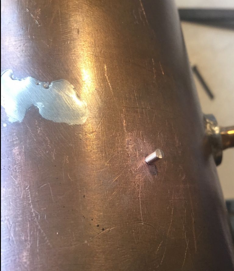

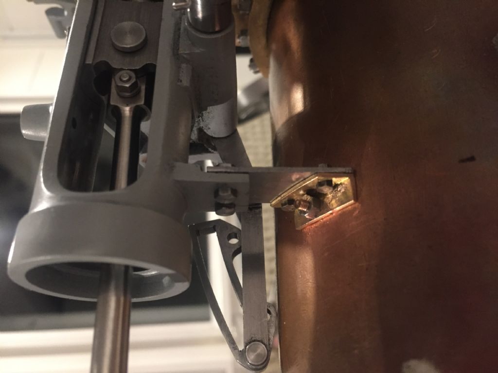

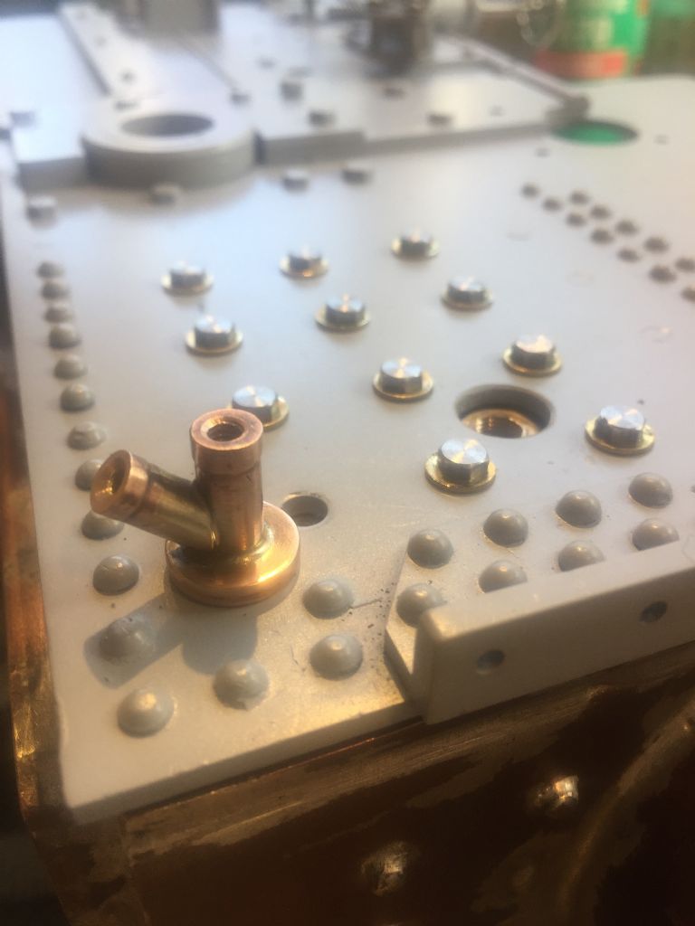

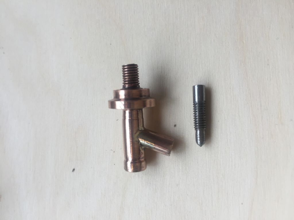

                      Evening all, I hope all well.
                      today was a bit more engine work after week off with a kidney infection but blowdown cock made the best I can and trunk guide bracket made and fitted.
                      i was in two minds about drilling a hole in the boiler but looking at all the other holes your supposed to drill I thought one would be OK.
                      and guess what strengthening plate not where it should be so fixing only into outer shell, however the trunk guide is fitted very strongly to the cylinder so I can see that there is much force on this fixing, hopefully that’s correct anyway.
                      as you can see from the picture I added small stud, 6BA into boiler and 7 on the bracket this was to try and get a tighter fit in the shell, it’s sealed with 543 sealant so hopefully no leak.

                              So no one screamed I’d made a mistake with the stud fixing so I will take that as it’s OK 😉
                              so next move will be to make the steam fittings, I have the blow down cock made but looking to purchase the injector for reliability reasons but trying to decide which one I think a 2oz one would be fine but please say if that’s wrong as they are not cheap.
                              I will then make the pipe work and we won’t be far away from a steam…
