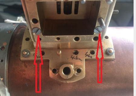

                              #430345
                              Jeff Dayman
                                @jeffdayman43397
                                Hi Derek, did you use some silicone sealer or other gap-filler at the screw heads shown in the pic below with the red arrows? If not air may be getting by the heads or the screw slots out the side, under the gasket. You could add some sealant by removing only the valve chest cover. Some socket head capscrews or philips head machine screws would be better here than slot heads, because with those there is no leak path across the head. There may still be a gap above the head though, needing extra gasket or some sealant, or both.
                                #430347
                                derek blake
                                  @derekblake72550
                                  Thank you Jeff, on these screw head I actually added some JB weld as the counterbore had made a gap under the chest cover and I filed off level.
                                  is it actually possible that air could be creeping up the fixing studs then, I assumed as they were under the plate it would be sealed.
                                  i haven’t tried sealant yet, but that’s only because the valve isn’t fully set yet.
                                  a leaking valve cover isn’t an issue that can’t be fixed from your suggestions, I was trying the air route to put my mind at rest about the valve chest itself wasn’t leaking and worse still the cylinder saddle as both can’t be removed now.
                                  as the sealant can be easy cleaned off I will try a thin layer tomorrow and see if it’s a fix, I did add some washing up liquid around the area and it does seem to be out the top where valve chest cover fits.

                                    #430350
                                    derek blake
                                      @derekblake72550
                                      Looking at your suggestions Jeff, I didn’t add JB to the top fixing screw for some reason and that’s where it leaks so I shall do the same to that one tomorrow and try again. I think you may have just hit on the reason for the leak! 🙏

                                        #430608
                                        derek blake
                                          @derekblake72550
                                          Small amount of work done, screw heads sealed and new gasket added and valve chest leak seems sorted but still small amount of others to do but looks like none on cylinder saddle or valve chest itself yet but only running on around 20psi presently.
