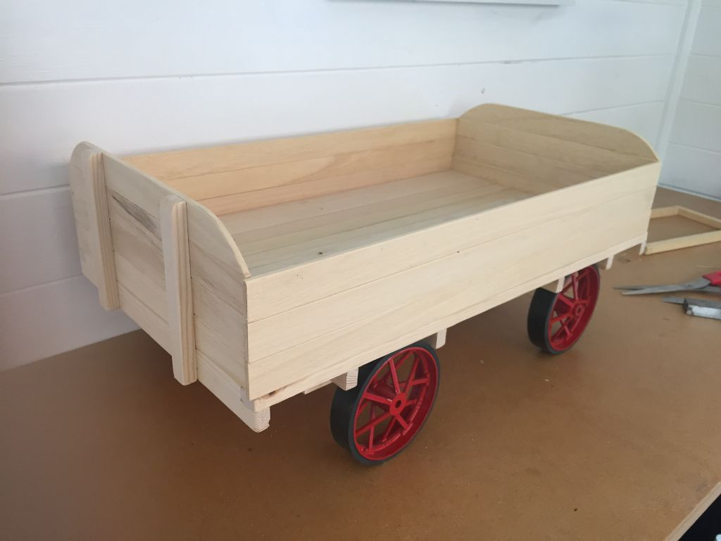

                                                  So to add a little variety to the engine build I’ve decided to attempt two extra model, a living van and trailer scratch built from pictures.
                                                  very early stages but a bit of fun, if they end up looking half decent I shall sell them to fund engine parts.
