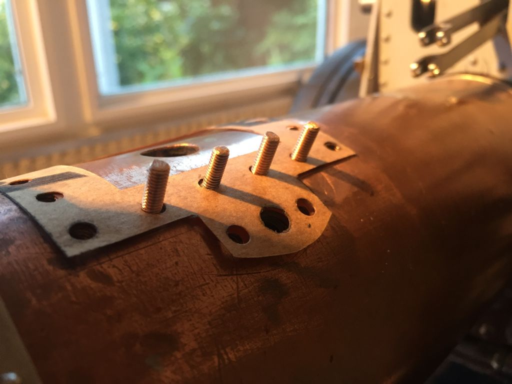

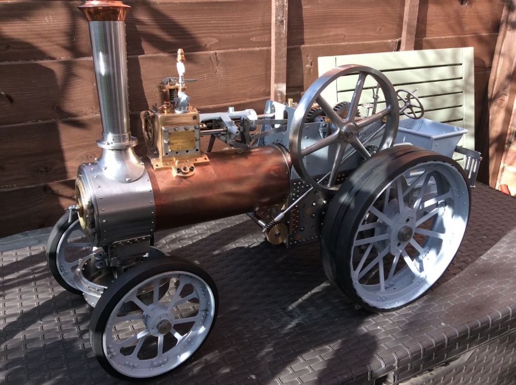

                                      Engine fitted together in the sun, still plenty to do and the new 4BA studs to make which will hopefully hold in the troublesome fixings.
                                      Hopefully the previous owner will be glad to see it getting close to looking like an engine.

                                                No real work tonight but played around with the stud issue, and opted for what I was advised and that was to loctite in the studs, unfortunately one of them is 5BA but that was before I realised going up to 4BA would help.
                                                i was going to just screw in the studs but no matter how many studs I made I couldn’t get a good fit that wouldn’t make the hole bigger, another skilled engineer like yourselves could of done it easily but this option for me seemed the best idea, I also very gently tapped with a punch to close around the thread, only gently but this helped even more to stop and wiggle.
                                                i will let the loctite set 24hrs but I have to say the studs feel very snug so fingers crossed all’s well.
                                                i now have to decide the best time to do final cylinder lockdown, so that I don’t need to remove again.

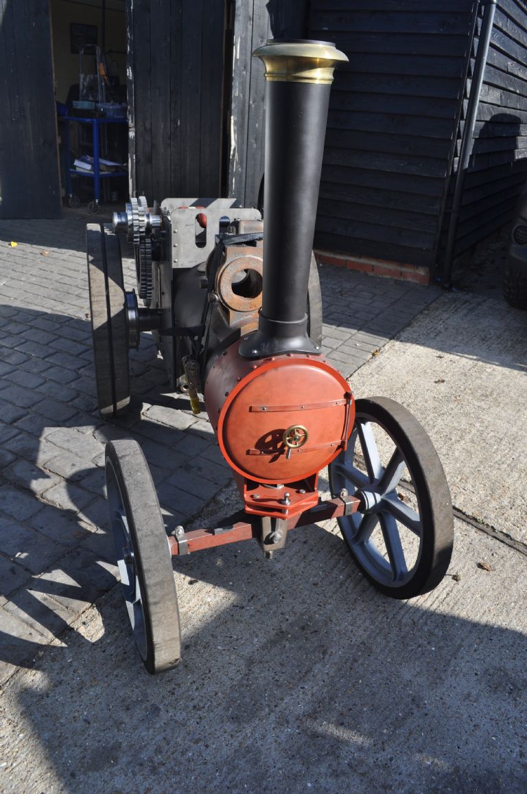

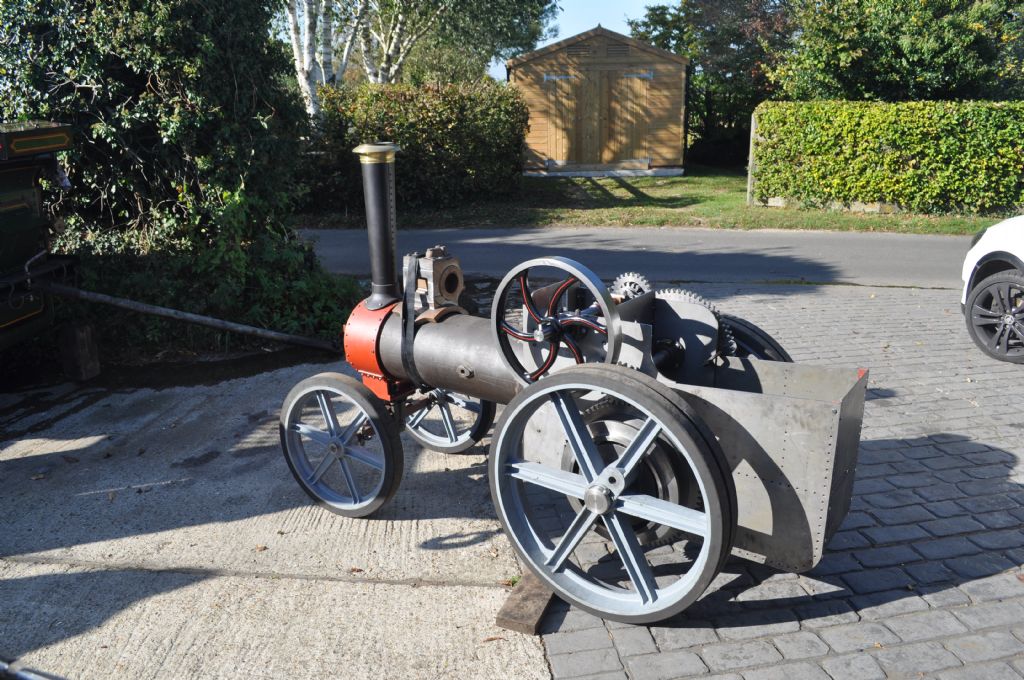

                                                Terry Jessop 1
                                                  @terryjessop1
                                                  I've recently acquired a part built 1.5" allchin so watching this thread with interest. Yours is looking really good so far

                                                    Jeff Dayman
                                                      @jeffdayman43397
                                                      You are doing great Derek, the pic you posted looks fabulous! Studs and gasket in last photo also look great. The technique you mentioned re closing up the holes a bit is one you will often use if you repair or refit old stuff, especially if someone ham fisted has been there before you! seen it a lot on cars trucks and agricultural equipment……
