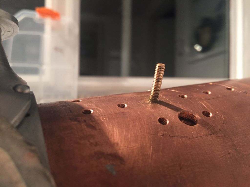

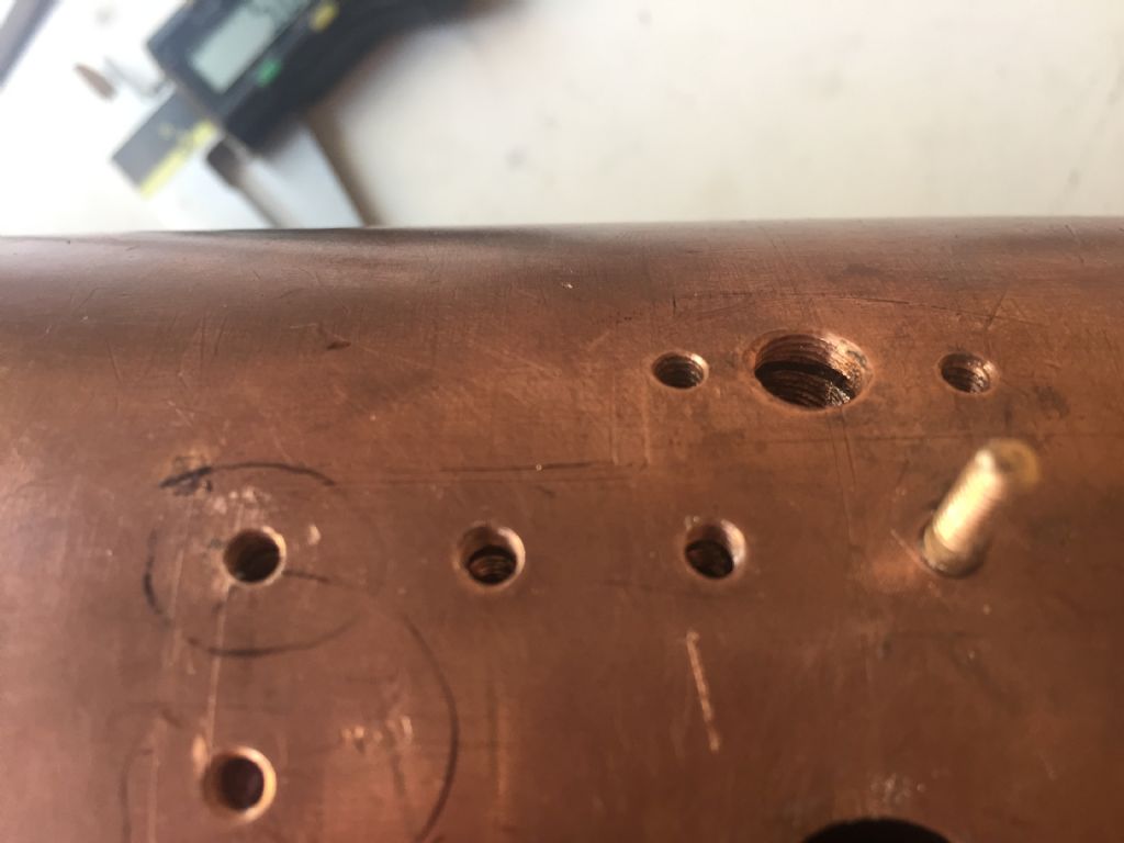

      Hi All
      i just wanted to say thank you for everyone’s help, I must found very despondent.
      i waited a year for the boiler, and I managed to drill the stud holes without problems all fit this strengthening plate to be in the wrong place and ruining what was great.
      now I have 3 holes that MAY strip and one that has, and I know you have all done your best to help but it’s still very disappointing.
      i did try the inside out fixings but dropped screw three times which took an hour to get out, and when did get one in it went at such an angle it ruined the threads.
      so I’m sorry if I’ve sounded a right misery but I just feel downhearted after a year of waiting and I’m worried boiler is ruined. sad

        Derek, the boiler is definitely recoverable and since a kit alone costs nearly £700 it's worth a good try. I've indicated my suggested solution, which I still favour, although I realise that you will have to arrange the work with someone who can silver solder. The job, to such a person, is not demanding. Even a local engineering fabrication shop might have the expertise.
        You'vealready shown some good work with limited resouces. If you carry on this track you will end up with a lovely model.

              Can't help feeling there is some "over thinking" going on here. Obviously what you have now is not the design intent in terms of depth of thread but;
              i don't know the thickness of the boiler barrel or the intended operating pressure. Given that when a screw thread is tightend the majority of the load falls on the first two threads I assume the thickness of the barrel alone will give 2 threads engagement? If you take the area of the cylinder exposed to boiler pressure (12mm hole?) and multiply the operating pressure by that area and divide that by the number of studs you will have the approximate tensile force on each stud. I think you will be surprised by how low that is. Any mechanical forces generated by the piston against the crank will be mainly shear forces so for the purpose of this question can be disregarded. Back in the days of LBSC several of his designs had boiler fittings attached just by a couple of 6ba screws tapped into the wrapper!
              So, ideal? No, Compliant with the design? No. Probability of failure? I would say just from the info in your post, low.
              Talk to your intended boiler inspector first.

                Paul, maybe I fix strip thread and shut up about the other 3 holes.
                they are probably fine if I don’t overtigten!
                #425993
                  As I also said earlier they should be OK with tight studs
                  For the stripped one tap it out to 4 or 3 BA and make a stepped stud with one end to suit the enlarged hole and the other to match the rest of the 5BA fixings.

                              Internal stud fitted as suggested, only on the stripped thread, the other 3 I will risk and see how we go.
                              Internal stud

                              derek blake
                                @derekblake72550
                                Hopefully this will be ok, there was slight wobble so I had to loctite in but if fails I will send boiler away in the future when I’ve saved up.

                                            I think just good fitting studs from outside will suffice.
                                            The boiler is 13swg so about 2.5mm thick and with 5BA having a pitch of 0.59mm you are getting 4 turns in the barrel and a bit more in the partial thickening plate.
                                            I don't know what size you have drilled the filler plug hole into the barrel but for added holding power you could open up the threaded hole in the cylinder saddle to clearance size and then tap the boiler so the plug also has holding power.

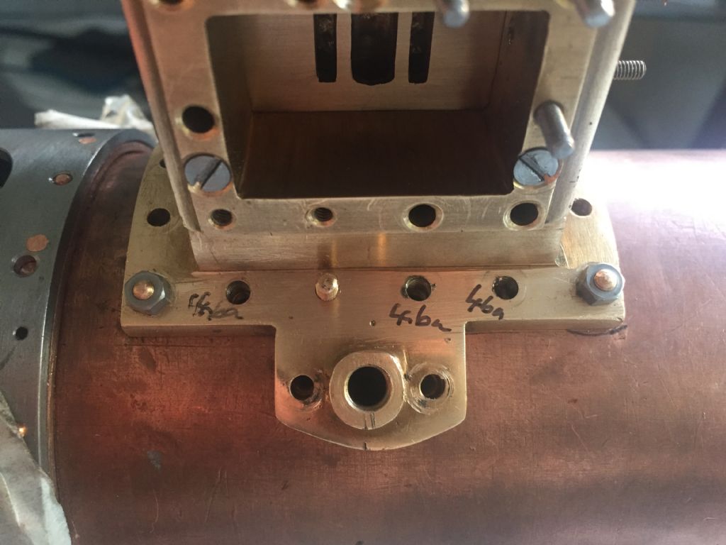

                                                so new day means new feelings, the stripped stud hole I put a stud from the inside, and the other three holes as they were pretty loose even when I made new 5BA bolts I tapped 4BA.
                                                i used a 5BA nut and tapped them 4BA so everything will look the same, however I don’t have a 4BA Die so I’m going to have to make some bolts.
                                                could I just double check what size bronze bar I will need to make these?
                                                I will try and make them a good snug fit in the holes, the threads do look good in the holes and I have tried to take a picture so you can see the side of the strengthening plate and it’s half threads.

                                                      You will probably have to turn something down unless you can find 9/64" bronze, if turning your own 3.6mm dia is what you need.
