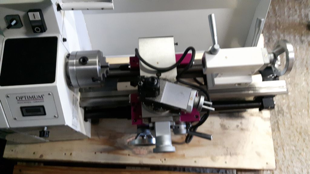

      Hi complements of the season.
      Please can someone advise. my new metal lathe (114 x 450) has a taper, runout of 0.07mm carriage versus the center line of the spindle.
      The smaller diameter the worse taper becomes. The carriage cuts in towards the chuck.
      Please can someone advise on how I can correct this. The manufacturer has tried to correct it by replacing the chuck jaws which has not corrected the issue.
      Many thanks Cedric.

        #626327
        Bazyle
          @bazyle
          Which actual lathe is it? Seems more than a mini-lathe.
          You should never change the chuck jaws, they (should) be made to match the body. Just putting a round bar in a chuck whatever the conditions of the jaws does not by any means result in it being in line with the spindle. If you put a dial indicator on the end of a bar and tap the bar it will move even when it has been moderately tightened.
          If turned between centres, and tailstock on centre then non parallelism is normally attributed to twist of the bed, which is corrected by 'levelling' which is nothing to do with being horizontal.
          However it can also be due to the alignment of the spindle wrt the bed if the bed has been levelled and the work truely aligned with the spindle, when turning without the tailstock.

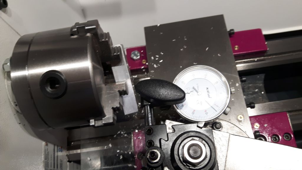

                                      Cedric
                                        @cedricblaver37709
                                        Thank you for all your replies, it certainly helped.
                                        The lathe is an Optimum 2406V with a 100mm 3 jaw chuck.
                                        My location is Andover.
                                        Yes Howard i do need a face to face/hands on assistance. Having seen the video from Chris Mate was just what I needed. I went and did just that.
                                        i got a 0.03mm difference.
                                        So am I correct in saying either the headstock is off or the carriage.
                                        Using a 50mm length18mm steel bar and making a 0.10mm cut shows a taper towards the chuck.
                                        To answer John Haine, I recieved the lathe (new) on the 8th November contacted the seller on the 21st for tech assistance about the taper issue. The seller collected the lathe on the on 28th November for repair (replaced jaws). The seller returned the lathe on 12th December. I still have the issue.
                                        Many thanks everyone.

                                            Hi Howard, I dont have a alinement bar but have ordered a Praztech MT3 with 12mm tapping at the MT end. Would this be ok?
                                            Do you know anyone close to Andover that may help.
                                            Many thanks Cedric.

                                            Huub
                                              @huub
                                              According to some foto's I have found, this small lathe can't be bolted to the table. That won't mean the lathe bed can't be twisted (due to inaccurate grinding or metal relaxation).
                                              You found a facing misalignment of 0.03 mm/100 mm. Causing a taper towards the chuck that can explain the turned taper.
                                              The facing misalignment the sum of the headstock misalignment and the carriage misalignment. The next step will be measuring the "headstock alignment" using the method in the first video.
                                              Edited By Huub on 28/12/2022 15:52:20
