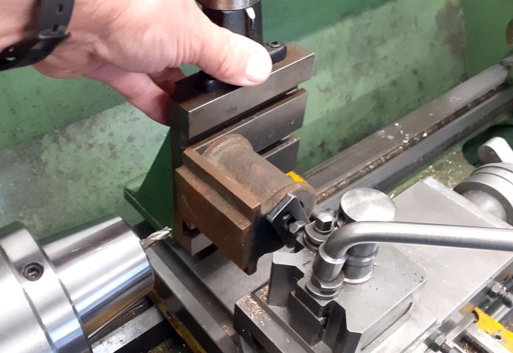

      Good morning all,
      I'm a little way further on building my Stuart 10v, and one thing that has come up is that I don't really have a solid solution for bringing work away from the chuck or the rear of a vice on the vertical slide, while maintaining parallelism.
      My usual method is to add packing around a part, and slide behind something of known good (ish) flatness, such as flat rod. I tap it home using a soft hammer and then tighten up the jaws. Inevitably, this means that the packing piece becomes trapped behind the work.
      On the 3 and 4-jaw chucks I can't afford to leave the packing piece behind the work while the spindle is rotating, and since it may require some effort to release it may move the work piece.
      On the vice in a vertical slide, I am constantly on the hunt for packing pieces which are shorter than the width of the piece being clamped, and the correct thickness to bring the work out beyond the jaws.
      Any thoughts or opinions gladly taken.

          Just a bit of nomenclature – "rod" is generally understood to be of round cross-section, so "flat rod" is a contradiction in terms. I think you mean strip or bar?
          What you need are PARALLELS which are a standard item used in milling and many other operations. Ideally they are ground flat and parallel. You can buy sets, but they would probably be too wide for a vice on the vertical slide. You can actually often use a bit of ground rod such as silver steel but getting a bit the right size could be tricky. Alternatively buy some bits of thin (say 3mm) MS strip which could be sufficiently accurate of various widths – and you could mill them down to make a set covering the various dimensions you need. IIRC Harold Hall describes making parallels on his website? It is good practice to tap the work down against the parallel AFTER tightening the jaws. In the vice it shouldn't be possible to move the packing when the jaws are tight.
          If you use a packing piece behind the work in the chuck as you describe, if the jaws are properly tight it should be possible to tap it out using a small hammer and a drift to help make sure the force is in the right direction not to shift the work.

              Further to Johns post steel parallels are commonly 1/4" or more thick which makes holding thin components difficult without supplementary packing. Thinner ones can be found down to 1/8" or so thick but these are quite tricky to use as the tend to tilt. You should use the thinnest parallel that can be fitted commensurate with leaving enough msterisl above the jaws to machine.
              For thinner parts normal practice is to use spring (wavy) parallels which are spring steel strips made with several waves along their length. Typically around 1/2" wide across the waves so the stand up nice and stable. When the vice is done up the waves splay out allowing the parallels to compress until the part resting on them is gripped.
              As John says normal practice is to beat the part down when the vice is quite tight to ensure that it is properly seated on the parallels. Generally tightening and beating needs to be done in stages with typical home shop equipment due to accuracy limitations allowing tiny movement during the tightening process. Considerable restraint is needed when beating on thin parallels. When more on way ones as these are easily damaged.
              Beating down is an acquired skill. You need a resilient striker to avoid bounce back.Historically a lead hammer was the historical weapon of choice for the professionals. The vice jaws need to be both smooth and quite tight so the part slides down and stays down. Firm hitting, hammering a nail style, is frustratingly unproductive. I use a 16 oz, nylon faced, Thor dead blow hammer held loosely and strike with a flicking motion so the haft bounces gently in my hand on strike. All the work ins don by the momentum of the head. Usually works.
              Larger parts are best done with two parallels. Theoretically you should be able to get the part firmly seated on both but in practice the accuracy of affordable vices and the component being worked on is rarely good enough to get both dead tight. The slightly loose one ensures the job hasn't tilted so its still important.

                          Thank you all, I managed to mill some T-nuts and a few other bits without major issues, and have some parallels on the way.

                            I noticed that the port face of my cylinder was sloped about 10 tho on the longitudinal axis. It's my understanding this isn't a critical issue, but I decided to see if I could fix it.
                            I used flat packing on the bottom (entry point of boring tool) of the cylinder , and rod above it incase the cylinder top wasn't parallel. I placed a mandrel into the cylinder and pushed that hard against the vice jaws. In this arrangement, the bottom of the cylinder was parallel to the ways, and the bore was vertical.
                            I used a dial indicator and the vertical traverse of the vice and determined there was about 10 thou out. Clearly the cylinder top was slightly out of parallel, so when I clamped it using that side to an angle on the faceplate – instead of the cylinder bottom which was fully parallel with the bore, it was skewed.
                            It was a fairly straight forward job to skim that off with the slot drill, but the finish was nowhere near as good as holding it on the faceplate, as although it was flat there were some chatter marks which needed polishing out.
                            Just incase I'm doing something horrifically wrong on that note:
                            • I used a 3/8" HSS slot drill in a collet, running at the fastest lathe speed.
                            • The work was held with aluminium strip below and rod above in the vice, quite tightly.
                            • The vice was mounted to the compound vertical slide (my obvious thoughts as to a lack of rigidity)
                            • The carriage had the lead screw engaged and using a lead screw handwheel to advance the carriage (maybe I should have locked between each pass?). The vertical slide, and cross slide were nipped up much as I could while still being able to move them.

                              I would not bother with the vice as it can introduce more errors than needed.
                              Set the vertical slide up with a dit to get the table parallel with the lathe axis. Put a tee nut in the middle slot and screw a stud into that. Slip cylinder over stud and with a bar or heavy "washer" and nut clamp cylinder with true face against table.
                              You can now machine the port face by raising/lowering the vert slide to get the cutter stepover, carriage to set depth of cut and cross slide to move the job back and forth to actually make the cut. Only cross slide should be unlocked.
                              Also keep "slot drills" for slots or plunge cuts, a sharp 4 flute cutter would be best for this say 1/4" stepping over 3/16" per pass.

                                At the time I was machining it, I couldn't be sure which side of the cylinder was perpendicular to the bore. I guess I could have tried both ways and seen what the DTI said…
                                It certainly= seems more straight forward your way!
                                I should probably, for my sanity re-face the cylinder top to be perpendicular to the port face and bore, and parallel with the cylinder bottom. I guess for that arrangement I DO need to use the vice?

                                            Thank you Jason – triple checked and it is the cylinder top that was not perpendicular, so in this specific case I thought I would use what else I learned from this thread regarding milling rather than setting up an arbor. I wil review that thread though, it looks like it will come in very useful!
                                            Either way I got a MUCH better result by using a 1/4" end mill with 3/16" passes and locking the cross slide:
