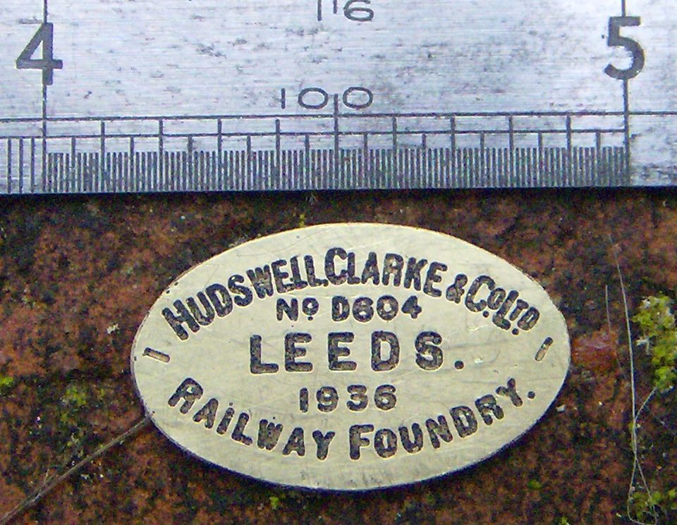

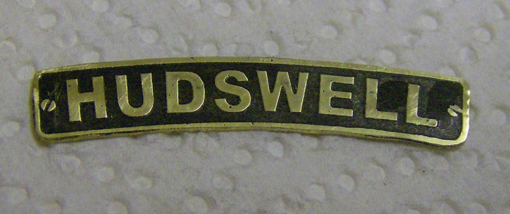

                                          Ferric chloride etches brass as well as it does copper PCBs. I did these using PCB making UV resist spray and ferric:
                                          I hadn't realised at teh time, but yes thathumbrol black enamel adhered really well to the etched surface!
                                          Makers PlateHudswell Clarke Locomotive Plate
                                          #101962
