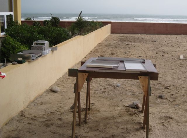

                If you dig through my numerous posts and photos of my machine refurbishments you will see I ended up painting many aluminium parts, panels, etc, and these have to stand up to lathe and mill swarf, coolant, cleaning fluids, etc – and they do! These were all acid-etched first before priming and painting, after trying many other of-the-shelf 'solutions' that simply did not work.
                If your application is decorative rather than hands-on functional, that spray can of stuff may just do the job!
                The Phosphoric acid I use is actually a drain cleaner from the local hardware store – A 30% acid solution, and I put some in a plastic spray bottle – the kind you use to mist plants leaves, or spray liquid insecticides or whatever, and spray the metal surface till wet. Don't spray with too fine a mist setting – rather have large droplets , else the mist goes everywhere and burns your skin and clothes…
                I first clean the metal with a liquid soap, a sponge, and water. Rinse, let dry a little, and then spray the acid on. The surface goes a milky white – leave for about 5 minutes – if any surface still shows shiny, add more acid – if the shine persists, then that area is oily so scrub it with a pot scourer for a few seconds. When all milky, rinse with clean water after 5 minutes, and dry – compressed air works well, or with lint free towels. Now an acid etch primer is good..PRIME RIGHT AWAY!
                Use nitrile, or latex gloves – I use Housewives dishwashing gloves, the type that goes almost up to the elbow.
                If the job is small, you can just dip the part in the acid container, keeping mess to zero, and no spray mist.
                If parts are large – DO THIS OUTSIDE, unless you want the rest of the workshop to rust from the deposited acid mist and wear goggles or a face helmet, like those used by Grinders..
                Here's where I did the acid etching…

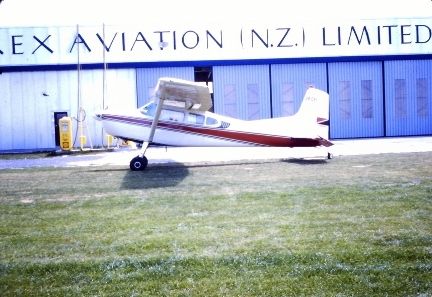

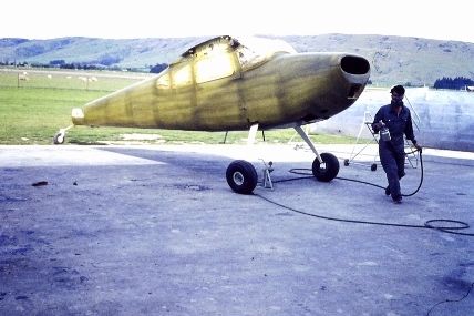

                        Cessna 185 B ZK-CFIZinc Chromate primer then two pot epoxy top coat was our most durable paint sceme for agricultural aircraft, mind you that was 50 years ago. This Cessna 185 was a topdressing machine owned by Rural Aviation the topdressing branch of the firm I worked for, and rebuilt for the Gore Aero Club in Southland NZ.
                        These two photos about a week apart.

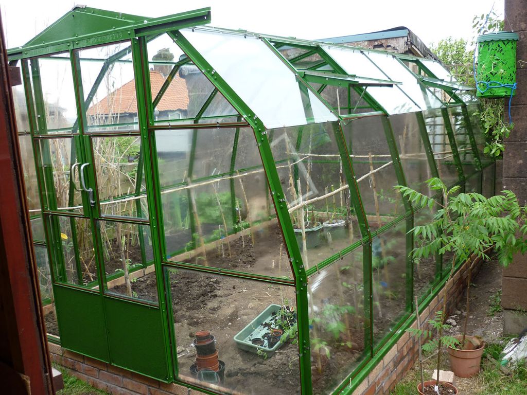

                          I bought a vintage 1940s Hartleys Botanic  aluminium greenhouse (10` x 16`) for £50, the frame was all chalky and discoloured , i used a two pack chrome based acid etch primer straight over the chalky surface ,followed by 2 pk epoxy and 2pk polyurethane . This was 10 years ago, the paint still looks like when i put it on . No sign of the paint film lifting or chipping at all. (hell of a fiddly and tedious job to do though).
                          I believe you had to apply the following coat as soon as possible after the etch primer which dried pretty fast.
