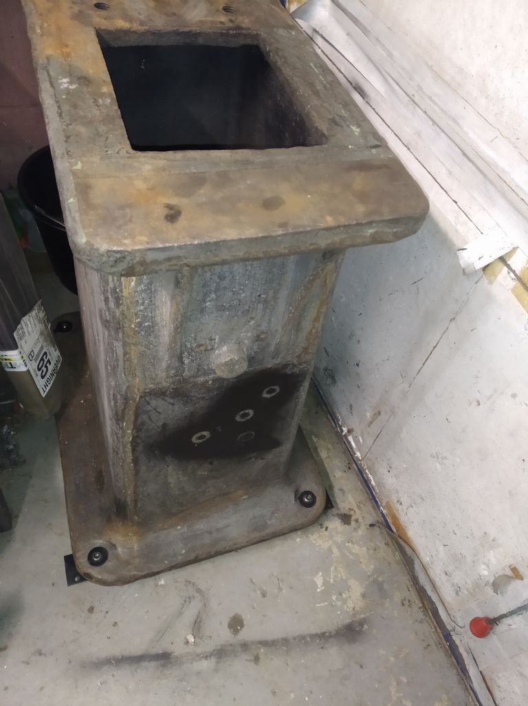

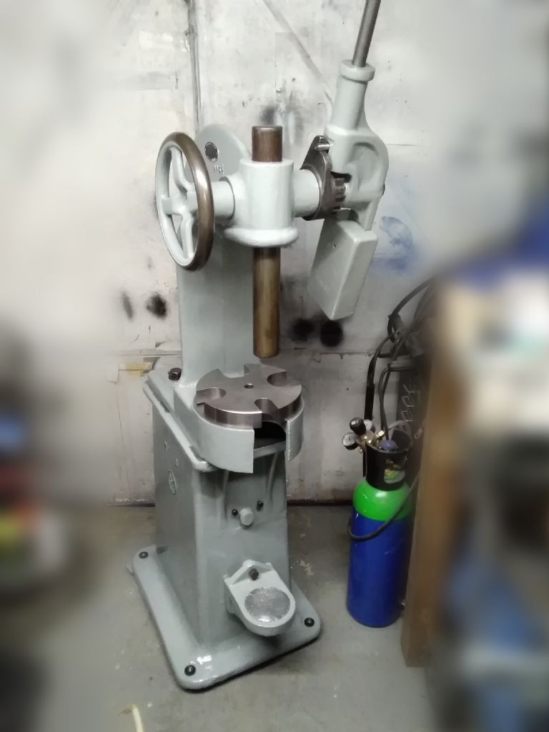

                          Posted by Pete. on 07/10/2021 22:39:43:
                          Not paint stripper, but Bahco Tungsten Carbide scrapers are now my go to for paint removal on cast iron, the 625 is probably the most useful, you'll wonder how you got by without one when you use one.
                          I removed a few layers of paint from these castings with ease, it comes off in one scrape, as it comes off in dry chips it's probably one of the least messy methods of paint removal.

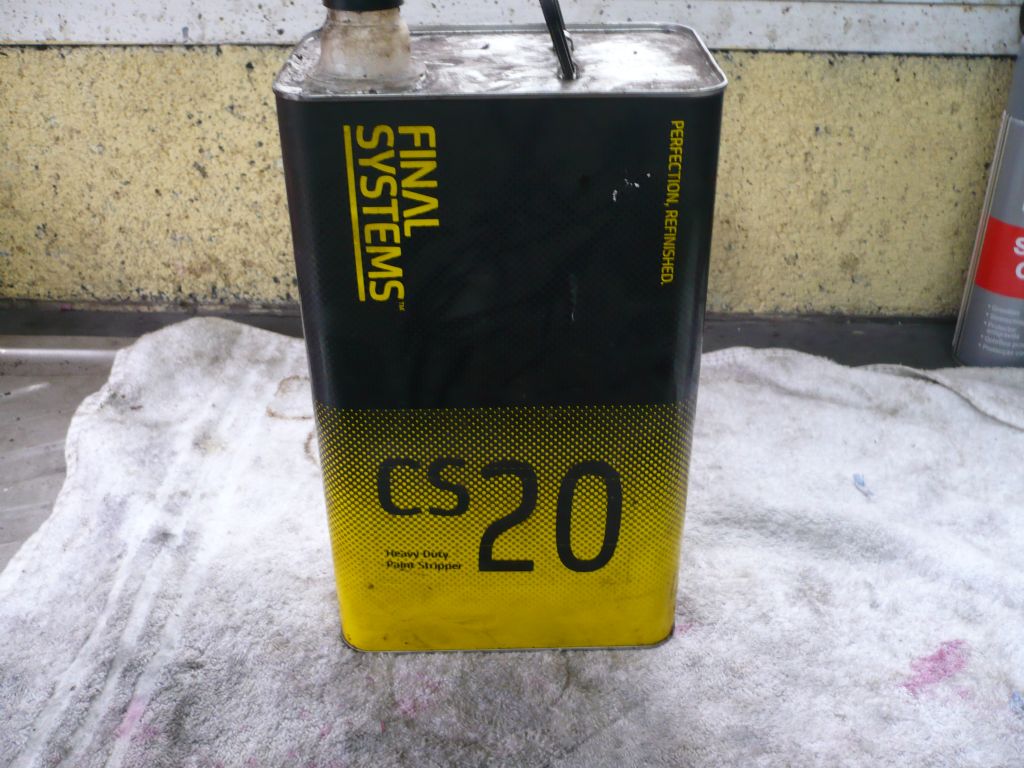

                            colin brannigan
                              @colinbrannigan54160
                              I can recommend Final Systems paint stripper, it's available at your local auto paint shop but it's not cheap at £40 for 5L but it does work. I use for stripping paint off motorcycles and one tin will do about three to four machines, it is nasty stuff so take care.
                              Kind regards Colin
                                    Pete,
                                    That press looks very nice!

                                      Posted by colin brannigan on 09/10/2021 08:44:43:
                                      Kind regards Colin
                                      I guess it's no worse than the "good ol' stuff" I used as a kid with absolutely no PPE at all. Thanks for the suggestion.
