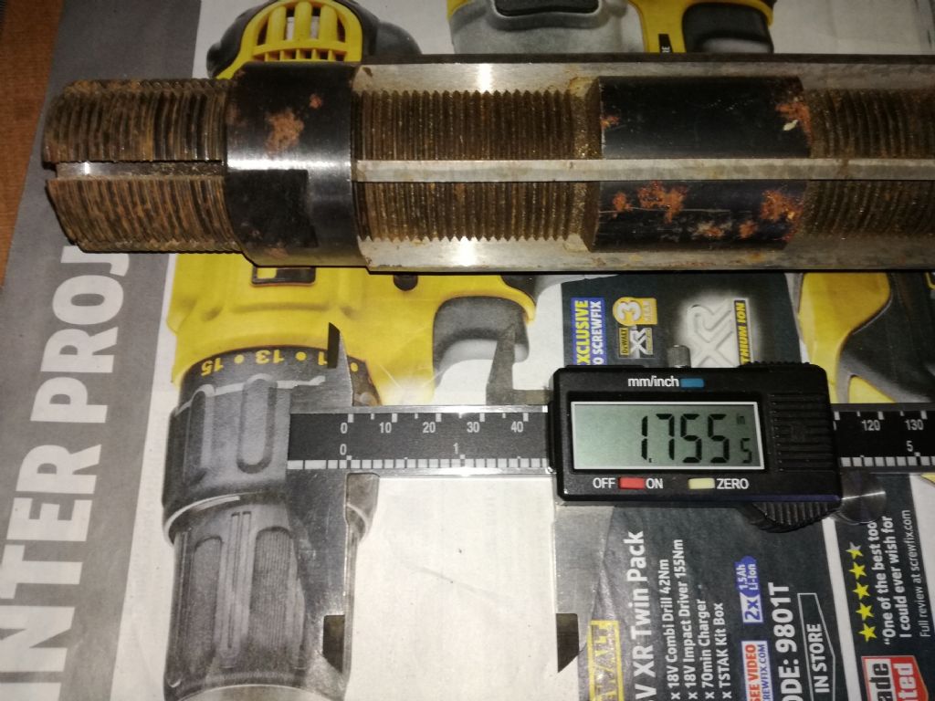

                            #655533
                            Nicholas Farr
                              @nicholasfarr14254
                              Posted by Dennis Pataki on 07/08/2023 15:23:05:
                              Thanks all. Lots of good ideas here to consider.
                              For the example cited, the bottom of the stuffing box bore has a shaft sleeve hole of slightly more than 1.5", so the expanding adjustable hand reamer may be worth a try.
                              In any event, while it would be nice to clean out the entire stuffing box bore, what is really needed is to clean out the first 1/2" of depth so the compression gland will enter freely.
                              Thanks again.
                              Hi, Dennis, before you rush out and buy an adjustable reamer, which are not exactly cheap at the size you will need, I have a 1-13/16" to 2-7/32" one, and the bottom adjusting collar is just a shade over 1-3/4" in diameter and a little over 1" long, and the screw threaded portion is 1-1/2" in diameter.
                              Of course there is a very slight taper towards the bottom end of the blades.
                              Regards Nick.
