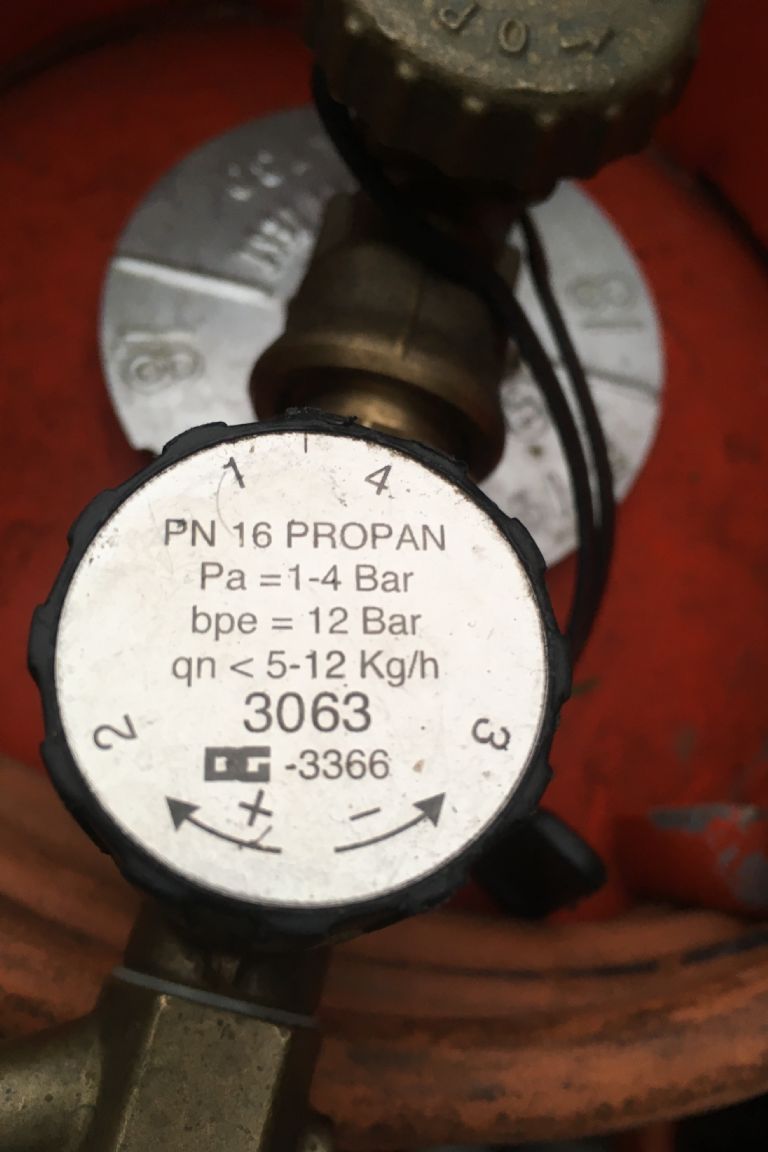

                            Like Brian H , I am contemplating putting together a Oxy/Propane kit .
                            I have a Sievert propane set up currently which has the regulator shown below . The regulator has a hose failure system built in but does not have a gauge of any sort on it .
                            Would some kind person , who has the knowledge and experience , inform me of what is required . Do I bin the regulator in favour of one with a gauge ,or even use an acetylene gauge , and what pressure range is best adopted .
                            Likewise , with the Oxygen side of things , gauge advice would be appreciated.
                            I understand that flash back arresters are required , is it the same acetylene type which is used for the propane supply ? .
                            I have read the posts above , I have looked at the links , watched YouTube and searched the web , but I just can’t seem to get a clear picture of what exactly is needed.
                            I fear that if I go to one of my local welding equipment stores , they will sell me what they have rather than what I need , if you understand me , whereas, I know that in this forum , I can get unbiased, and genuinely helpful guidance.
