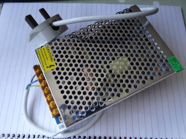

                        A couple of pictures may help with the enclosure requirement, I offer two 12Vdc switch mode power supplies.
                        First, a domestic in-lead power supply sold with a computer monitor:
                        The power supply is double insulated inside a more-or-less completely sealed box, and it came with a suitably fused lead made with a moulded plug and socket. This is very safe, and spilling a mug water on it is unlikely to be lethal. However, it's not suitable for use outdoors.
                        Second up, an LED power supply popular for powering rotary tables and other home motorised workshop equipment:
                        Although this type of power supply has lots of cooling holes, it's not intended to be air-cooled in the open. It demands a suitable enclosure. The user is meant to protect it and himself by shielding it inside another enclosure, The cooling holes leave the electrics highly vulnerable to liquids, dirt and swarf. Further, the mains and DC output connections are made via an exposed terminal strip with no provision for strain relief. Again, both problems are addressed by mounting the power supply inside something else.
                        Most VFDs are closer to the LED power supply than the computer monitor PSU.   Exposed terminals, flimsy box, no built-in strain relief etc.  VFD's are almost always components, meant to to be protected in the same way as switches and contactors, not user facing.
                        EMC is a complex issue not well understood, least of all by electricians. Many switch mode PSUs and VFDs are dirty dogs, incontinently spraying the neighbourhood with electronic crap. It can interfere with nearby equipment, and telecommunications. As electronic excrement is invisible and odourless, offenders often poop off in blissful ignorance. EMC can be harmless or serious, ranging from zapping a tired mum's Baby Alarm to disrupting an Airport.
                        Several ways of tackling EMC. Putting the power supply inside an earthed metal box. Careful attention to RF earthing as well as safety earths, Minimising cable lengths, and routing to avoid cross-coupling. Shielded cables, steel mesh helps, copper is much better, and heavy copper braid over copper or aluminium foil is best. EMC filters. As it's a difficult subject, the usual approach is to implement 'best practice', which often means following apparently pointless instructions. An unshielded, unfiltered VFD on the end of a long cable isn't EMC savvy.
                        Pero says '… systems should be installed after a consideration of all relevant issues – as long as you understand them.' Absolutely right! If you don't understand read the manual! The hard part is recognising we don't understand everything.
                        I regret people make mistakes and aggressively defend them! Despite the blow to my ego, I'm pleased to have the forum put my mistakes right; it's how engineers learn and improve. Pride is a deadly sin!
                        There's something else wrong with the way I wired the LED PSU to test it, and I didn't notice when I did it. Award yourself a Gold Star if you can see my mistake, it would be obvious if the photo was properly lit. Not the end of the world exactly, but don't imitate my bodges.

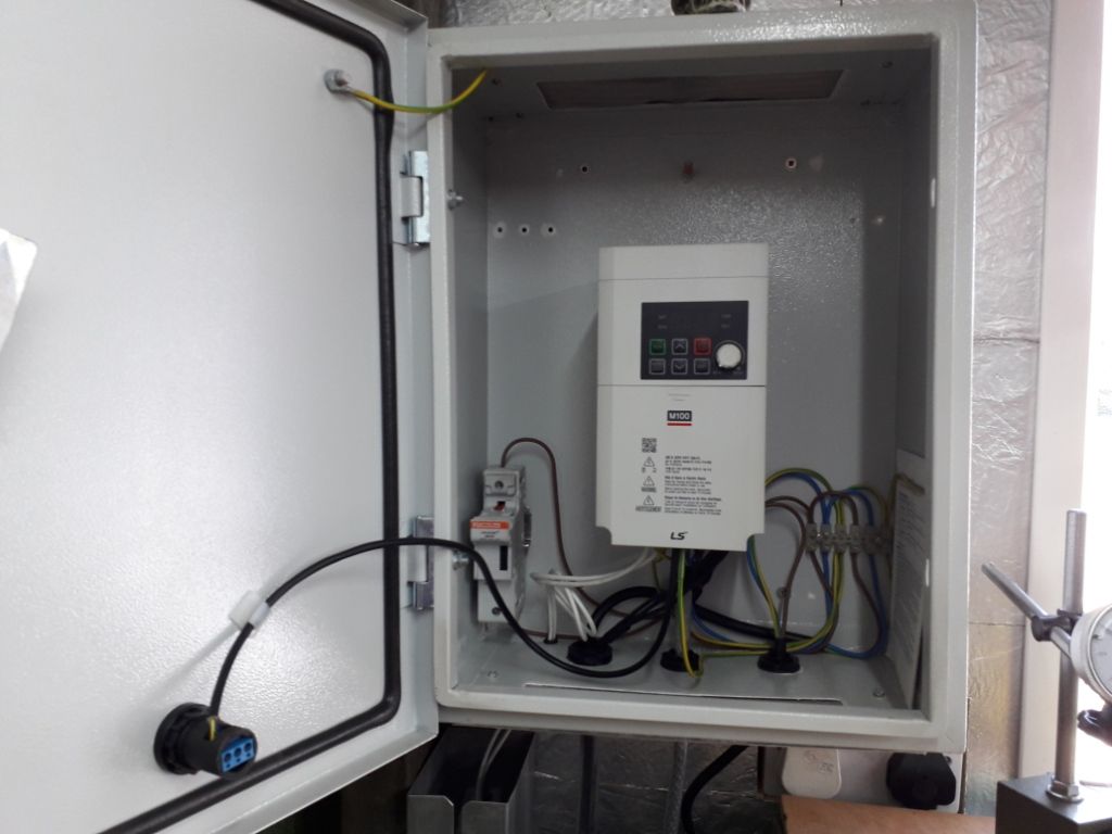

                          Henry Brown
                            @henrybrown95529
                            Not wishing to be involved in any of the above shenanigans here is my inverter installation. I was guided by Peter at Inverter Supermarket and a friend who was the works electrician where I used to work in the choice of mounting and the enclosure.
                            Hope this is of interest…
                            The enclosure sits just above my lathe and is spaced 25mm from the wall. There are rearward facing louvers at the top and bottom with some fine mesh to stop most particles that can get that way. When I took these pictures today it obviously works as there is only the merest hint of dust in there.

                            Robert Atkinson 2
                              @robertatkinson2
                              SOD,
                              Using a plug without insulating sleeves on the live and neutral pins?
                              While this old style plug is considered OK if already fitted. they should not be re-used on other equipment or if the power cord is replaced.
                              I strongly recommend that any of this type of plug used in an electronics or engineering workshops are replaced. There is a chance of a wire off-cut or bit of swarf getting trapped beteen plug and socket, touching the un-sleeved pin and becoming live. It can then be touched as you reach to remove the plug or operate the switch on a switched socket resulting in a shock, possible injury or even death, Old plugs should be destroyed to preveent re-use.
                              Robert G8RPI.
                              #486890
                              Robert Atkinson 2
                                @robertatkinson2
                                Posted by Henry Brown on 21/07/2020 11:53:59:
                                Very nice!
                                #486903
                                  Posted by Robert Atkinson 2 on 21/07/2020 12:01:34:
                                  SOD,
                                  Robert G8RPI.
                                  Gold Star to Robert.
                                  More obvious it's a wrong 'un if I brighten the image up.
                                  So, despite knowing the plug shouldn't be used, and understanding why not, I somehow fitted one earlier this year. On the plus side, not completely negligent – I put a 3A fuse in it.
                                  Action required: follow Roberts advice and destroy any old plugs found in my spares box.
