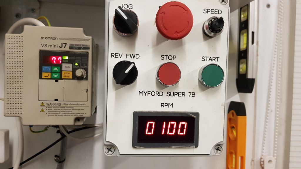

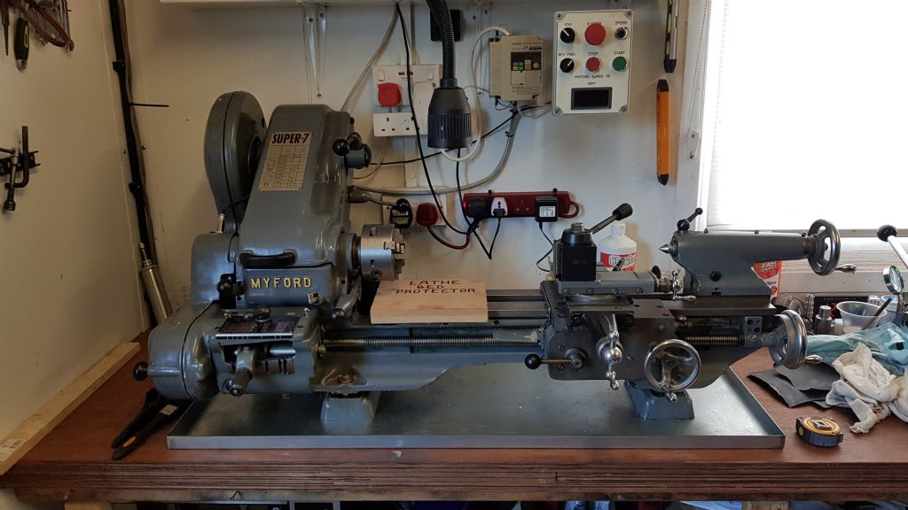

                                Posted by Steviegtr on 02/07/2020 23:47:14:
                                The 3ph motor on my S7 is from Clarks machine mart. There is a cooling fan & guard, but the motor is sealed. The fan is only blowing on the casting. A few times a bit of swarfe has found it's way in there & rattled about before getting spit out. I now have a bit of hardboard bent around the back to stop this. A bit tacky, i need to make something better. When i fitted this setup it was not too expensive. From memory the whole thing with my own made panel / inverter & motor was around £250. Picture of my setup.
                                Steve.
                                That is not an example of correct installaton To comply with good practice, the installation manual and current regulations the inverter drive needs to be in an enclosure and cables should have proper strain reliefs as a minmum. It should probably have EMI filters too . I alse note the use of an unsafe and illegal adaptor with a 2 pin european style plug in it on he lower power strip. Cut the two pin plug off, smash it and the adaptor and put a proper 13A plug with a 3 A or 5 A in it on the lead.
                                Having sockets, adaptors and leads directly behind the working area of the lathe is poor pracitce too, They can be contaminated by colant, dust or swarf or hit if something gets flung out of the chuck.
                                I know this may seem picky but having seen it I have a professional obligation to make you, and anyone who might use it as an example, aware of the issues. If you wish to carry on like that it's up to you.
                                Robert G8RPI.

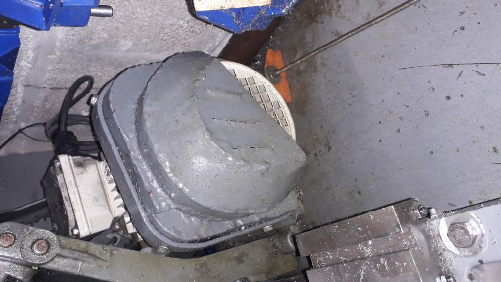

                                  Myford 3ph Motor Guard om my ML7.  Slightly dodgy gas welding but does the job.  Motor now 6 years old, nothing ingested that has made itself known.
                                  Andy
                                  Edited By JasonB on 17/07/2020 13:36:37

                                          Posted by Robert Atkinson 2 on 17/07/2020 12:18:47:
                                          Steve.
                                          Robert G8RPI.
                                          Well here goes. Robert Atkinson you are a miss informed individual. You keep posting on this site as if you are some sort of Oracle. I know all. I guess you read too much. I have in my career as an an industrial electrical contractor, fitted somewhere in the region of 300 inverters & built some 200 control panels, including designing them with approval from the the engineering departments that ordered them. Nestle, / Fox's biscuits,/Terry's York,/Harrods biscuit manufacturer (cannot name. NDA. Trebor Bassets,/ Haribo. All blue chip companies.
                                          Having worked in the industry all my life i have come across people like yourself a few times. What am i talking about you may ask.
                                          You should fit a inverter VFD in an enclosure. It is in an enclosure. There is no requirement to fit a inverter inside a box. It is in a box. Strain relief. Strain relief from what. It is a fixed appliance. My god you get worse. I take it you do not travel around the world as i do. The euro adaptor is from Boots. Fitting sockets behind a spinning lathe chuck,,, disaster. No actually i removed the swarf shield to show the equipment.
                                          I think you may only have 7 fingers & 2 thumbs. I am guessing where the missing finger is.
                                          You should maybe also have an EMI filter fitted. ?????? Why. We only fitted filters in panels that had PLC equipment in them, or sensitive electronics, like RS 232 interfaces or sensitive encoders. You really need to stick to flying model planes. You have NO PROFFESIONAL OBLIGATION or knowledge to be making the recommendations or assumptions that you are doing.
                                          If someone puts a post on this forum requiring help. If i have the knowledge i will reply & try to help. Some folk seem to think they know everything & reply to things that maybe they should not. That is why a lot of the very experienced forum members do not reply any more. I have quite a few private mails from some of them.
                                          I do not know why this keeps happening & can only assume that there are some sad individuals , or may be envious individuals who cannot afford some of the toy's that others have.
                                          If a member of this site asks about a depth of cut, Or a way of soldering the tubes in a boiler, i would not reply because i do not have the knowledge to do so.
                                          Steve. & proud
                                            As shown, that inverter is not "in a box" or an enclosure, it is just mounted on a wall, unprotected, in a vulnerable location.
                                            Omron describe that inverter as being an "open chassis" in the drive manual & say that it should be protected from (amongst other things) dust & metallic particles, oil mists and not in direct sunlight. That suggests to me that it should be mounted in a suitable enclosure – same as other inverters I have used. The manual also suggests the use of an input line reactor to improve power factor & a suitable input filter to reduce interference "if required" – which suggests that appropriate testing of the installation is required to determine if a filter is required. Presumably you did suitable testing & found that these were not required in this case ?
                                            The above is not an opinion – it is all in the Omron VS mini J7 installation and operating manual. Did you really just screw inverters to the wall like that for Nestle etc. ?

                                              Posted by mgnbuk on 20/07/2020 09:23:13:
                                              Nigel B.
                                              The VFD is contained in an IP20 enclosure and there is no instruction in the makers manual to fit in any further enclosure. The picture was taken with the chip guard removed from the back of the lathe for clarity.
                                              The output cable to the motor does have some support and most likely the supply cable is in a TRS gland but not showing in the picture.
                                              If anyone wants to fit the VFD in an enclosure make sure it is fan ventilated, and make sure the air intake is filtered to protect the VFD from dust. If you are using the controls on the VFD for control you may find it a bit of a chore to keep opening and closing the cabinet door to operate the stop/start and speed pot.

                                                Robert Atkinson 2
                                                  @robertatkinson2
                                                  Hang on a minute guys,
                                                  Steve,
                                                  You may have made control panels, but that does not mean you are correct. Before posting I specfically checked the manual for the VFD you fitted and it states it needs to be protected in an enclosure and that EMI filters may be required. Strain relief? ANY flexible cable that is accessible and connected to a termnal block should have a strain relief. These drives are COMPONENTS not finished products. They need to be properly integrated with approprate fused, isolators filters etc. Unless it is part of a fixed installation it has to comply with the EMC and Low Voltage Directives (Yes even if it is not for sale). From the companies you say you did work for the machines may have been fixed installations which have different requirements particuarly for EMI/EMC. I cannot believe companies like those would allow this type of VFD to be installed unless it was inside an enclosure or at least in an inaccessibled area e.g. behnd interlocked guards.
                                                  You say you fitted EMI filters when PLCs were used. This proves that VFDs need them (some are internal) to meet the EMC emissions limits. Just bcaus it's not interfering with your kit does not mean it is not affecting someone else. It takes specialist equipment to check that equipment meets the requirements, but it is a legal requirement to do so. I have the equipment required (HP and R&S spectrum analysers and assocated equipment) and know how to use them. I do travel a lot. Last year I travelled frequently to North America and the Middle East to witness or carry out EMI/EMC tests. I have designed and built equipment that included VFDs and Servo drives and was responsible for ther compliance to UK, EU and North American electrical, safety and EMI standards. There is a big difference between designing something and constructing something following the typical diagrams in the manual. When Rockwell automation introduced their 2nd generation Ultra Draive we were the first company to use it in the UK. The machine would not pass EMC tesing due to the drive. This was despite all the required filtering. Rockwell were struggling and paid my employer for me to consult with them and identify the problem with the drive and design a solution.
                                                  Buying the travel adaptor from Boots does not make it OK. There has been a bit of a clap down since the BS for travel adaptors was published but certainly before then the majority of adaptors sold by Boots were unsafe.
                                                  I don't fly model planes. I have all the toys I want including a fullly equipped electronics workshop, I'm certaily not envious of you Super 7. If you were showing others how to do it properly you should have showed the splash guard in place. Having to reach over the lathe to operate the controls or emergency stop is very poor practice too.
                                                  I am a Chartered Engineer and the our professional standards oblige me to make the user aware of any safety issue I identify. I have many years experience designing and working on electronic equipment, industrial and laboratory equipment, aircraft, and aircraft equipment with the odd diversion building and running the worlds fastest car.
                                                  1/ Emgee hvave you visited Steve's workshop and examined the installation? If not how do you know what he has done? Note that I have restricted my comments to issues that are clearly visible in the photos.
                                                  Where do you get the information that the OMRON VS Mini VFD is in a IP20 rated enclosure? The manual clearly lists it as "open chassis".
                                                  As for opening the cabinet to use the controls on the front of the VFD, this shows your ignorance of how these devices are desined to be used. The front panel controls are designed for set up and troubleshooting, not the primary means of operating the drive. They are not robust nough for frequent use.

                                                    Like you my comments were based on what is included in the picture and the fact that it was mentioned the chip guard had been removed for the photo.
                                                    My VFD information came from the Omron mini J7 Manual that is available on line, also there is no recommendation to mount it any additional enclosure, just the usual warnings re location.
                                                    I did have to search fairly deep into the manual to find the IP rating but it was as stated on the ID plate shown.
                                                    The manual also mentioned that a filter may be needed if the unit is found to interfere with other equipment.
                                                      Robert G8RPI
                                                      Robert
                                                      Do you really have to stoop to calling people ignorant to make a point ?
                                                      FYI this is the correct spelling for "designed".
                                                      If you believe the controls on the front of VFD's are not fit for purpose you should state that when replying to posts, not wait until it suits your argument.
                                                      Of course they are are fit for purpose otherwise why would manufacturers continue to provide the facility when it would be cost effective to leave them off as they do if you want a skeleton VFD to fit within a control panel.
                                                      Major component suppliers like RS and Farnell have them for sale but don't state the controls fitted are not fit for purpose.
                                                      Robert, I could add much more but will not stoop to your level to make my point.
