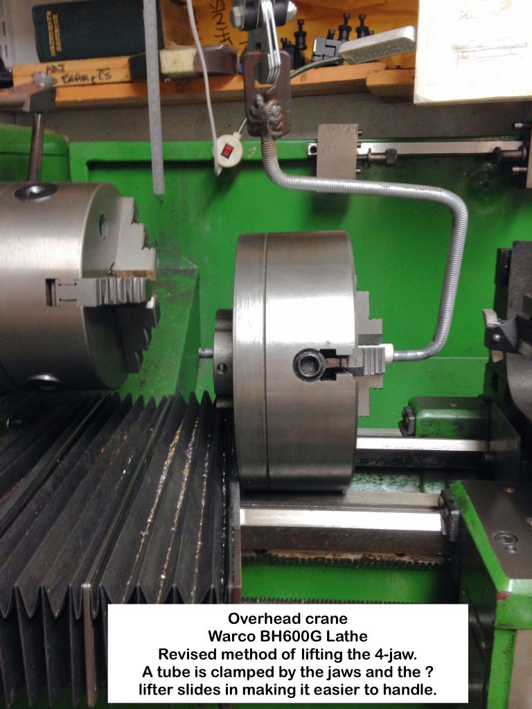

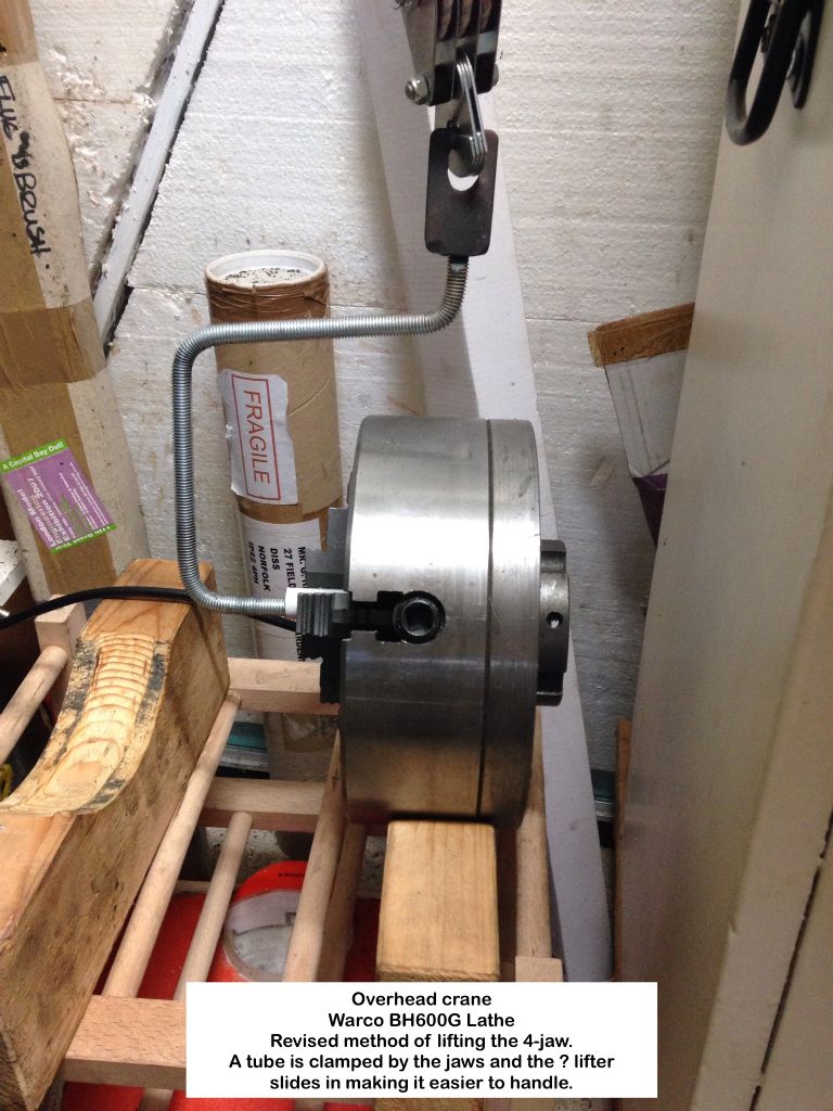

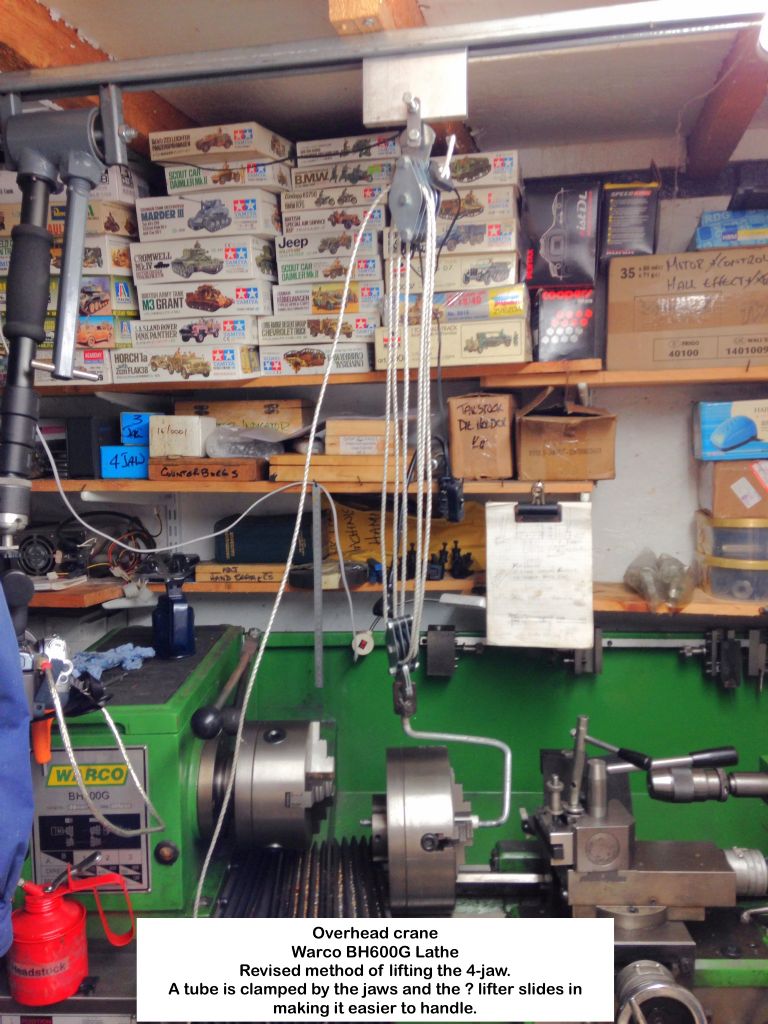

            My first method of lifting the 4-jaw left a lot to be desired so soon revised that, but forgot to post as an update.
            4-jaw chuck
            4-jaw chuck
            4-jaw chuck
            So much easier to slide it onto the spindle now as no longer need to rest the chuck on that special piece of wood first, in order to remove the sling.

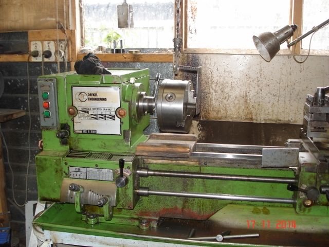

              Here is my 8" three jaw chuck suspended on my hoist, it is basically the same as Geoff's method, although the jaws are just closed on the bit of tube that forms the bottom portion of the lifting hook.
              Ian S C
