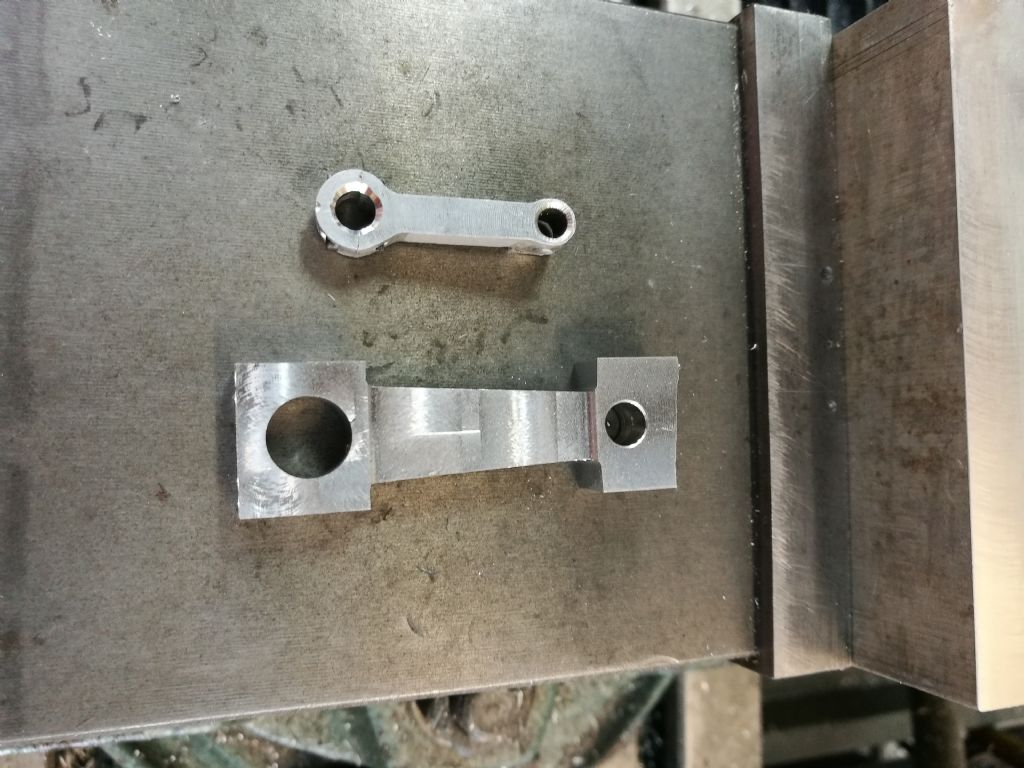

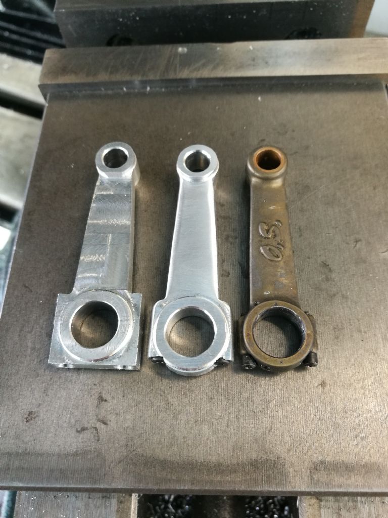

      So here's a quick photo update to show the comparison of the OS Gemini rod to one from my latest Supercharged two stroke V8 project
      So anyone know the torque settings for an m2 big end bolt or perhaps the torque setting for the 0/80 bolt used on my V8 rods, I generally just use the torque setting of T.E. but not the F.T or E.F.T. and I've found that using the tightening instructions of " tighten till it shears and back off half a turn " doesn't really go to well either. i'm fairly certain that foot pounds and inch pounds torque on either of these bolts would result in the sheared off torque setting and that would be a bit of a waste of time. so anyone got any bright idea's. LOL (i'm kidding of course, no-one torques small model engine bolts, you don't have the same distortion when machining as in full size practice, well nothing that's actually measurable anyway.)
      cheers
      Dean

            #340122
            dean clarke 2
              @deanclarke2
              O.k. here is the latest on these rods. below shows the progress
              And…. all finished
              You may want to polish the crankshaft mick to ensure a good running surface, also double check the diameter before I post them back to you and let me know, should be a nominal 10mm or 9.98ish. Oh and also don't forget to torque the big ends down to the correct setting, which is 0.35nm
              cheers
              Dean

                      I just got a O.S.FT-240 Gemini that I'm thinking in converting it to petrol and it has the infamous aluminium (bronze coloured) old conrods.
                      I read about them failing but I'm not sure how serious the issue is. I do have a small milling machine and some (very little) machining experience so I wonder if I should get some 7075 Al and try to machine a pair or just run the original ones??? I'm afraid that if they fail the damage could involve other parts that are also extinct.
                      I saw a video from a guy in Switzerland (very professional looking job) also the pics here from Dean that looks like he took a slightly different approach to it so is nice when you see things made in different ways, at least makes me feel more encouraged to give it a try.
                      I'd appreciate any input from anyone with experience on either these engines or machining these. I don't know how precise my mill is (just blame it to the machine) coupled to my limited experience. The biggest brake I find is that I might be missing some very precise measuring tools, I do have the basic stuff (calipers, indicator, regular 0.01 micrometer, and that's about it)
