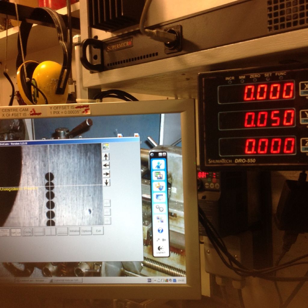

                                        Peter Spink
                                          @peterspink21088
                                          This is my version of the Centre Cam made a few years ago. Wouldn't be without it!
                                          Centre cam
                                          Delrin cone housing perspex ring diffuser, home made PCB with surface mount LEDs underneath. Another PCB mounts the USB socket and a pot for setting the LED brightness. Mounted on a 2MT arbor.
                                          Centre cam
                                          LEDs are quite bright but AGC in webcam software copes most of the time.
                                          Centre cam
                                          Set up for edge finding/location.
                                          Centre cam
                                          Screen showing 0.050 holes drilled at .050 centres on test piece.
                                          #281844
