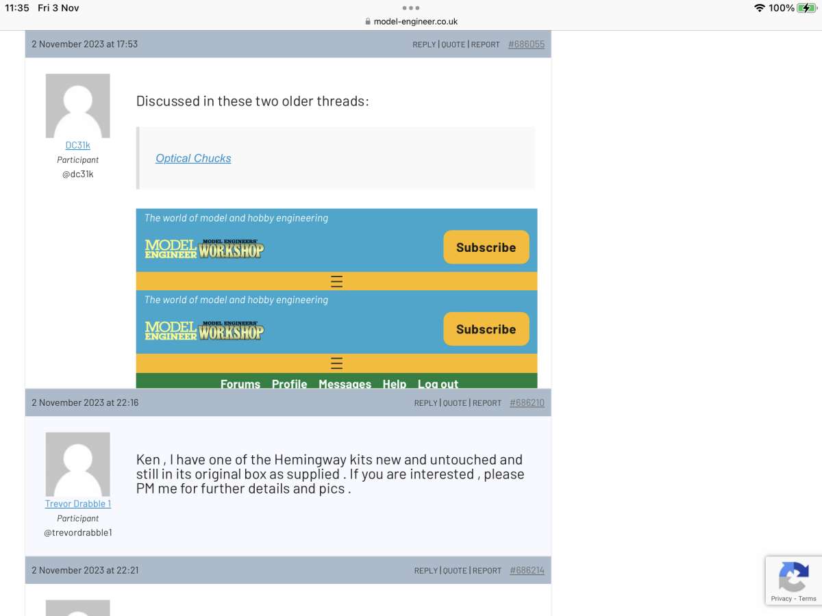

                  Something very odd occurring on this new forum !!
                  … in your post, the second link is not visible, but there are adverts banners
                  … when I quote your post, the second link [plus text] becomes visible.
                      It displayed OK to me, though something odd happened when I tried to edit out some of the block quotes post for this reply, to try and prevent Bloat-Quoting.
                      The second link is an excellent example of why it would be advantageous for the old member’s albums to come over here as well.
                      I appreciate that we were told it wouldn’t happen at launch, but that they may arrive later.
                      Good examples of where members linked back to their own album, rather than filling a thread directly with their own photos. There are some photos on the post, but mainly links to one or more non existent album(s).
                      I’d always though a good practice, so folk could view lots of detailed photos if required, but not be swamped with them if just passing through.

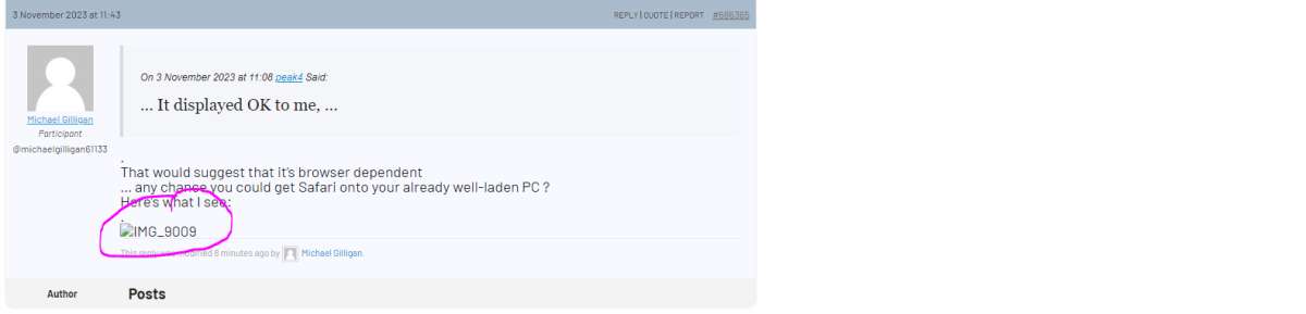

                        On peak4 Said:
                        … It displayed OK to me, …
                        That would suggest that it’s browser dependent
                        … any chance you could get Safari onto your already well-laden PC ?
                        Here’s what I see:

                          I used to have it on for testing a friends website creations, but removed it when it was causing stability problems.
                          I’ve just checked and apparently it was discontinued for Windows about 10 years ago.
                          Your post however displays like this; until I submit, I’ve no idea how the quoted part in this post sill show
                          image_2023-11-03_120247237
                          I’s taken a long time to dawn on me, that the white area to the right of my screen is quite useful when taking screenshots.
                          If I include it as above, then the forum re-sizes to width, making the requites part of the screenshot both narrower, and more importantly less tall, thus taking up less space.
