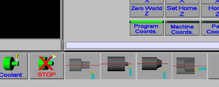

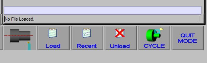

                @martinconnelly55370
                I have used Machscreen to modify the screens for Mach3 Turn to suit my needs. I put new buttons on the manual screen in place of the blank ones at the bottom of the page to take me directly to the wizards for turning, facing boring and tapers. I also modified the button that posts the code to take me directly to the Auto screen after it is posted. I have a manual data input line on the first Auto screen as well and used the blank space on that screen to add a button to go to the turning wizard.
                I have corrected an error in the facing wizard, see the current thread regarding fitting an ELS.

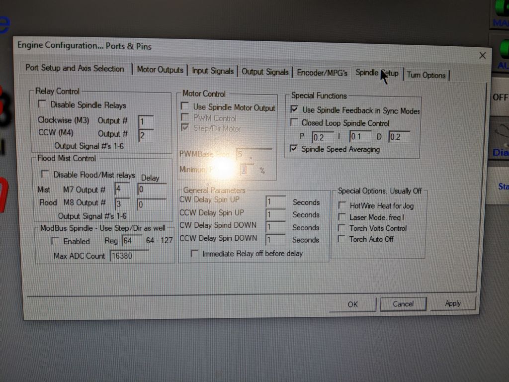

                        Tick use spindle feedback in sync mode. And r3.043.062

                              I did have the right boxes ticked on the general config screen but I think Martin's comment re motion controller may well be correct. I have found virtually no information on the card that's in there so it's hardly mainstream; I did find the Mach3 plugin to install but that is about all the data I have on it. Everything else has been trial and error, with quite a lot of the latter. Probably intended for mill/router use so no lathe function support.
