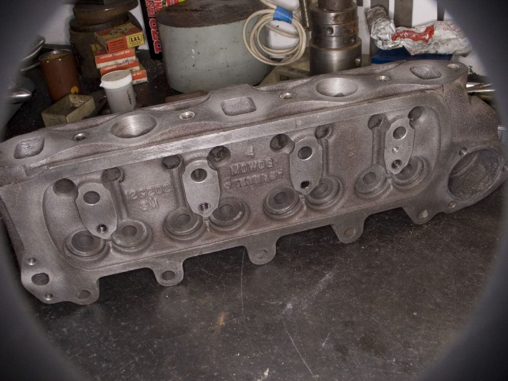

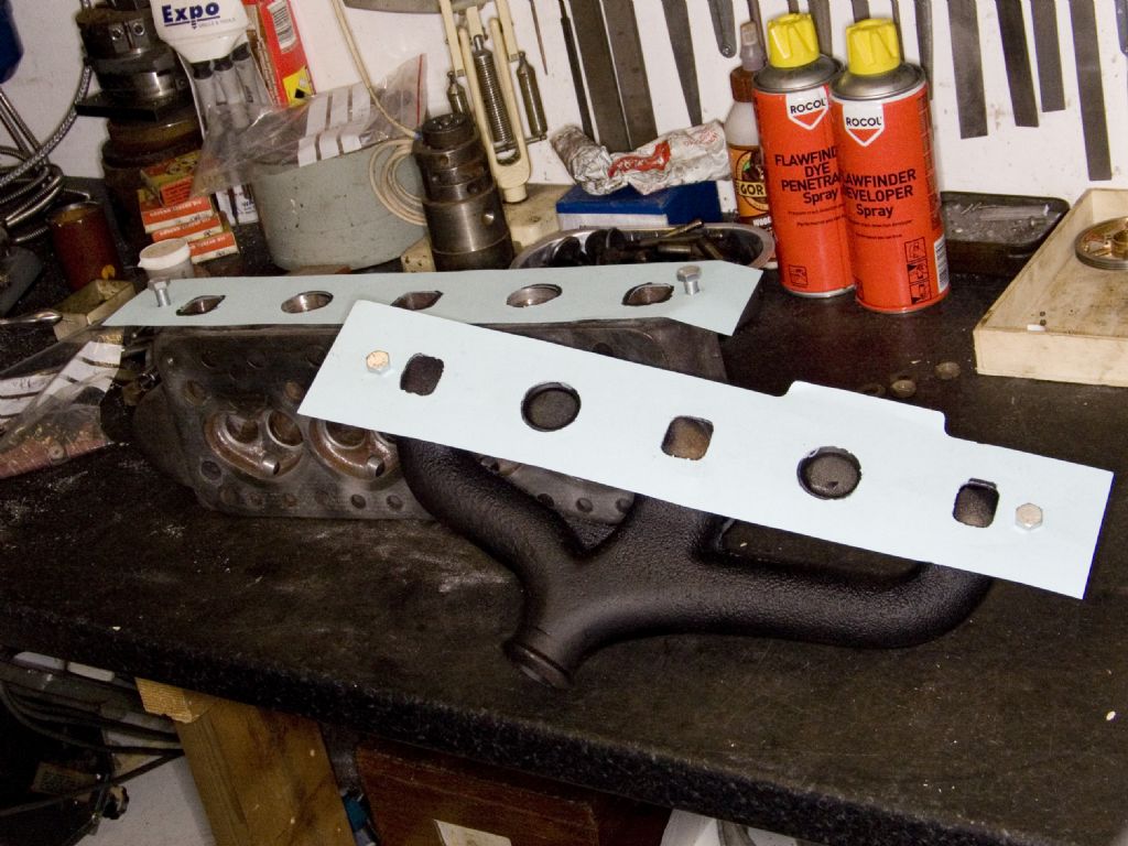

                        I have just done a port matching exercise on a spare 1098 A series engine for my Morris Minor.
                        It was surprising just how bad they were when I took templates form each part.
                        I used a solid carbide burr in a die grinder on mine, and it was very effective and quick to do the job.
                        **LINK**

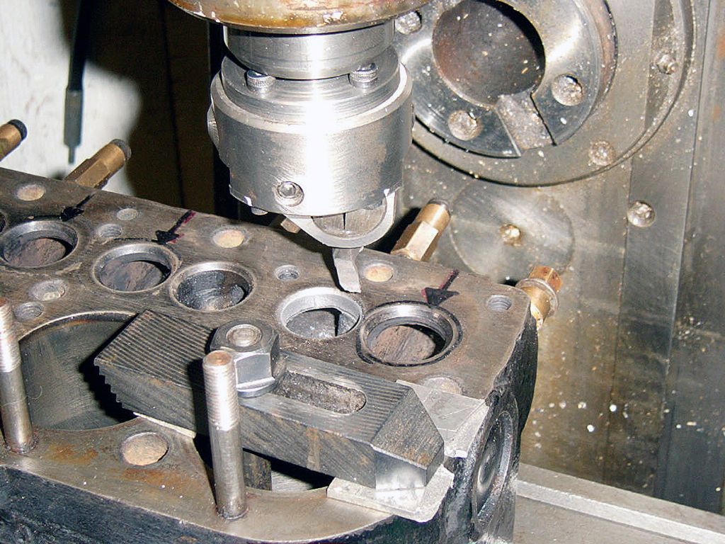

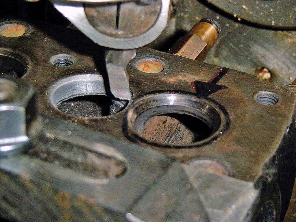

                              Opening out the inlet valve throats is well worth doing on an A7 motor. A simple pilot cutter can be made on a lathe very quickly; you can use a reground broken centre drill as the actual cutter. Also, there is no radius on the roof of inlet port where it meets the valve throat. It has been proved again and again that the bulk of the gas flow in an inlet port is in this area -the so-called "short side radius". As it left the factory this area is a sharp right angle rather than a radius. A bit of work here with a burr or mounted grinding point will have good results.
                              The improvement in the inlet ports can be seen in this photo.

                                Plus the removal of the sharp corner at the top of the cylinder bore near the valves which I forgot to mention.
                                Mine had unleaded exhaust seats fitted which precluded fitting larger inlet valves, but enlarging the throats is an excellent way of getting better gas flow.

                                      You just reminded me that I took a photo of that process.
                                      The red aerosols in the background are a crack detection kit, the A series heads are prone to cracking so I thought it best to check before doing a load of work on it.
