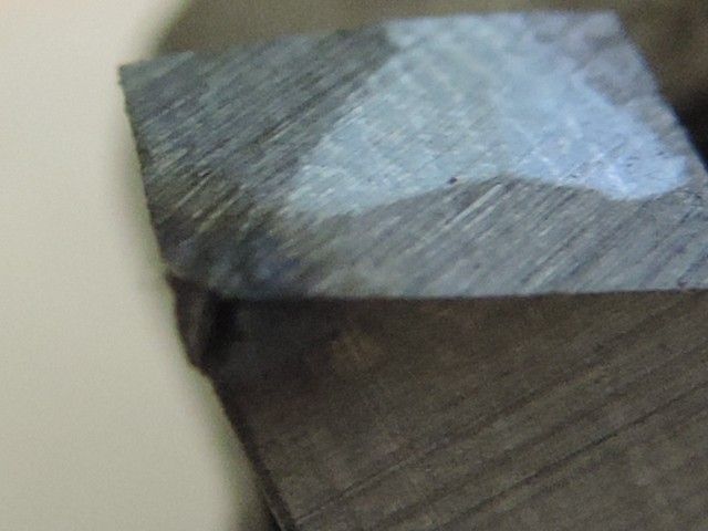

Hi Andrew,
A 180 degree turn would mean extra grinding, because the angling of the toolbit is about 10 degrees, the top needs to be ground at about 20 degrees (that one isn't really ground at enough of an angle).
Indeed, I may remake this (version 4…) with 12 degree clearance angles.
