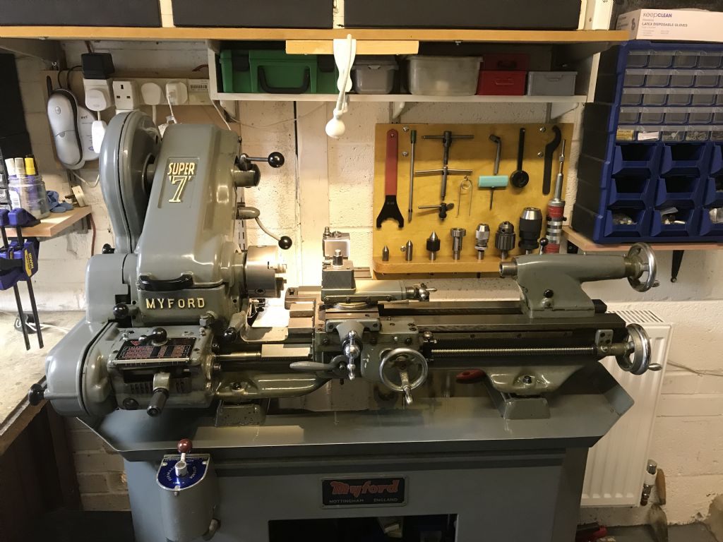

                              Alan Hopwood
                                @alanhopwood63369
                                Could someone answer a little question on the Super 7? the one shown in the photograph is of the same vintage as the two 7's I have the use of, but I believe them to be Super 7's and not Super 7 B's. I understood that the B indicated that it had power cross feed, which the one shown (and mine) are not so equipped.
                                Am I right?
                                #450759
                                roy entwistle
                                  @royentwistle24699
                                  I thought the B indicated a gearbox. I have known to be wrong cheeky
                                  Roy
                                  #450769
                                  Hopper
                                    @hopper
                                    In Myford parlance B = gearbox. Usually. But I'm no expert either.
                                    #450770
                                    Cornish Jack
                                      @cornishjack
                                      The 'B' annotation is for gearbox fitting, whether ML 7 or Super 7. (That is the thread selection gearbox, not the power x-feed, which is only available on the Super)
