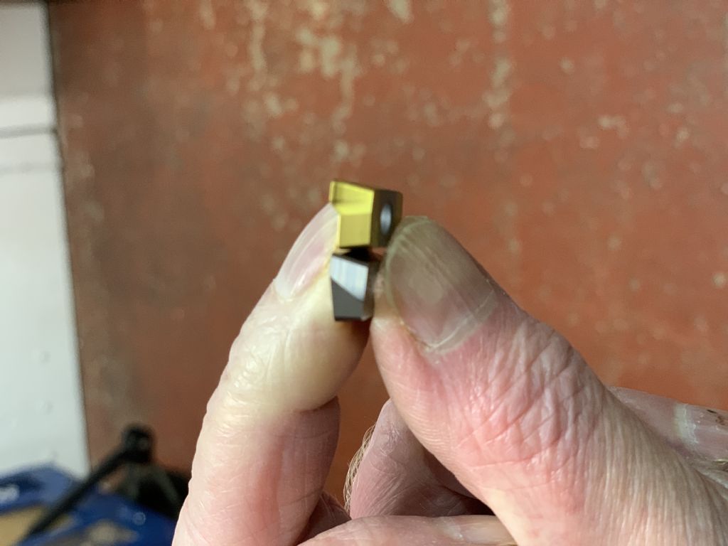

                    #444296

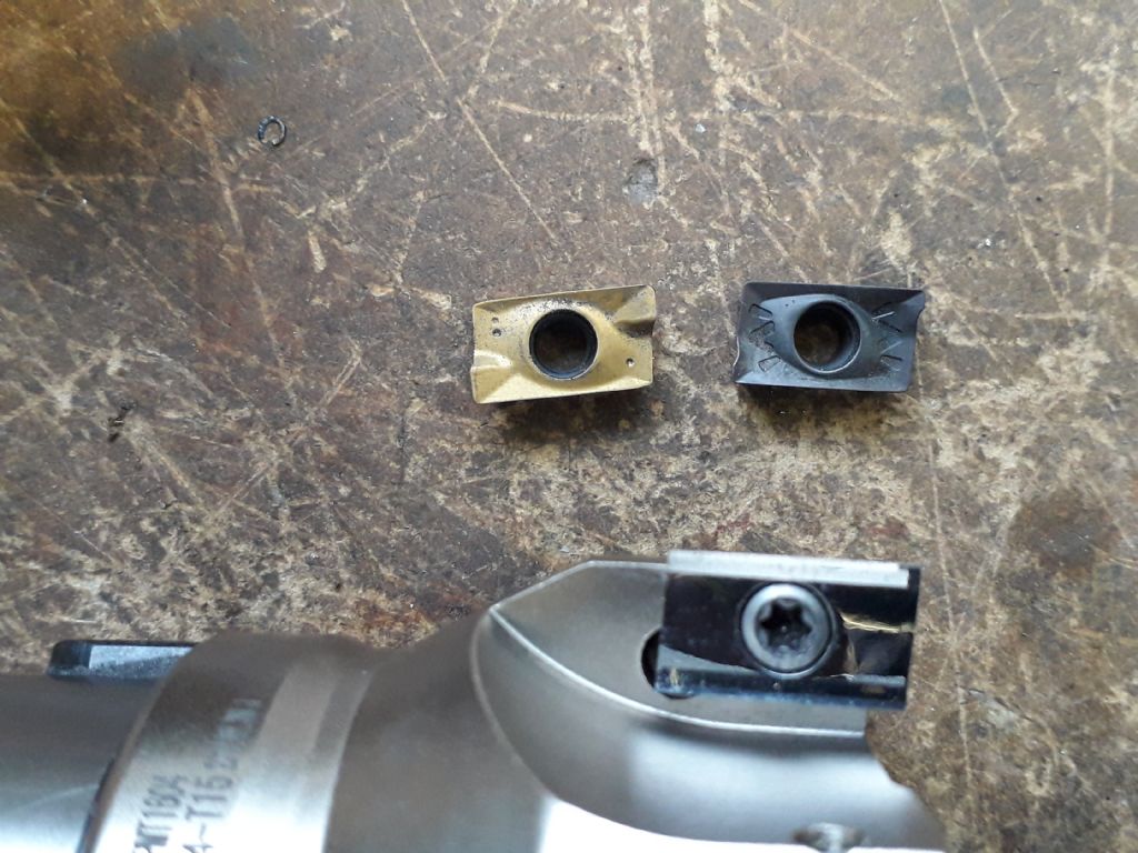

                      Funny enough having seen your earlier post this morning I tried some inserts by both YG-1 and Korloy via Cutwell and they fitted OK, possibly taking a little more pressure on the screw to seat then down into the pocket but no visible sign of any gaps. I've only got 4 of each type so not easy to try in the 63 and 80mm heads but could try three in the 80mm to see if they cut OK.
                      Those 4 letters may describe shape of insert for a particular metal (angles, chipbreaker etc), the bright Aluminium one in the head from YG-1 is PDFR as are the ones from ARC. The grey Korloy is PDTR and a different shaped cutting edge to the ARC PDER
                      Edited By JasonB on 02/01/2020 13:06:51

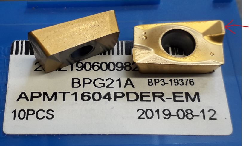

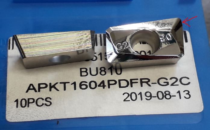

                        I have just compared the PDER and PDFR inserts I have with the 25mm end mill (both from ARC) and the front face (cutting edge) to rear face (seat) dimension is greater by 0.52mm on the PDER. The sides and ends of the inserts taper inwards down to the rear face where they must be the same dimensionally as they both fit the pocket perfectly. With the inserts having a different thickness and the same tapered sides the length and width dimensions at the front face differ, the PDER being thicker having the larger dimensions.
                        Well thats how I see it.
                        #444330
                          Well spotted that man, there are also other differences such as the length of the lower cutting face as arrowed and the Korloy ones certainly come with different angles too
                          #444332

                            Ha ha, you are not the only one Andrew. I was put off buying for two to three years!… It has been difficult to find a reliable and consistent source… especially for the inserts. Add to this, every manufacturer of shell mill wants you to buy inserts only from them for their holders… as explained before. I have gone through this several times, even with Sumitomo. To get a shell mill from them costs a small fortune… although it is high end CNC production stuff.
                            On our website, the dimensions given for the APMT and APKT inserts relate to the cutting edges, not the back of the insert (or pocket size).
                            Any variation in the geometry of the insert, i.e. relief angles, chip-breakers etc., as you would expect from inserts designed to cut different materials, would result in different dimensions. Still, all classed as ISO generic.

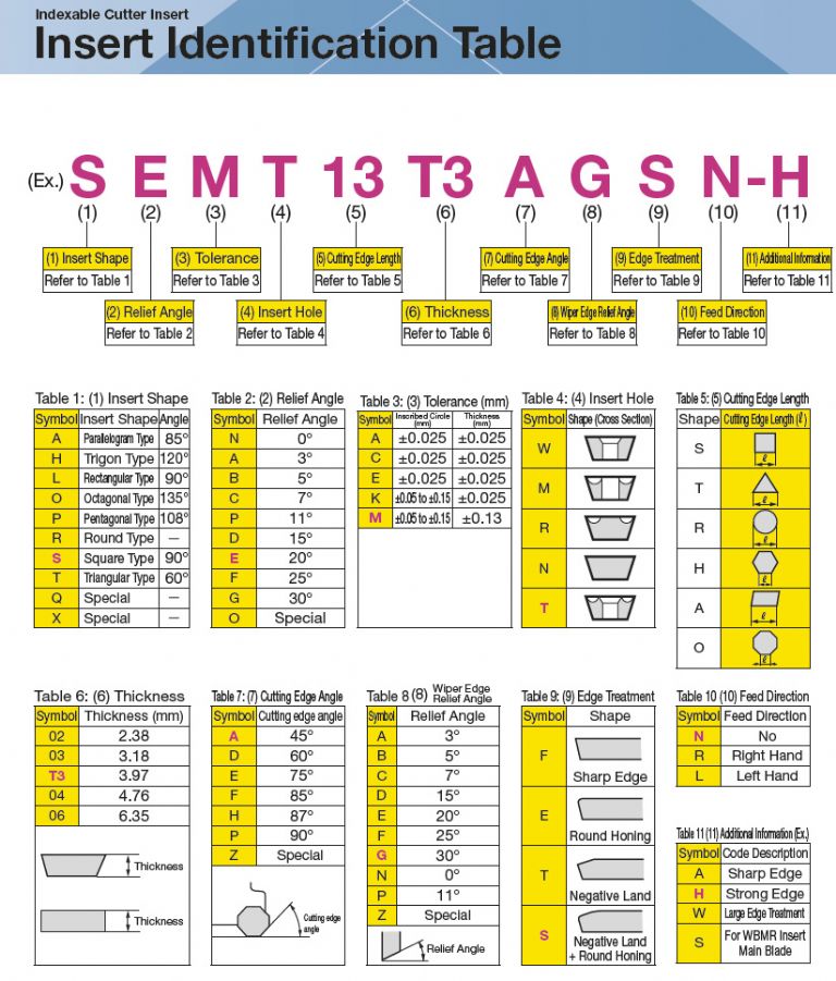

                            PDER – PDFR (ISO codes):
                            P = 90°
                            D = 15°
                            E = Rounded
                            F = Sharp
                            R = Right hand feed direction
                            The thickness can and will be different as you can see in this picture:
                            Ketan at ARC.

                              Anonymous
                                Jason/Ron: Thanks for the information and practical results.
                                I'm not worried about variations in thickness, but inconsistencies in length/width do worry me. It's good to know that the inserts fit anyway. Looking at professional tool suppliers the insert side angle seems to be 11°, although I don't think that's set in stone.
                                I looked up the coding for inserts. The PDER and PDFR decode as follows, basically in accordance with what has been previously posted::
                                P – cutting edges are at 90°
                                D – Wiper relief angle is 15°
                                E/F – Cutting edge condition, E is rounded, F is sharp
                                R – Cutting direction, right
                                Man, this stuff is complicated. I'm concerned because I got done on the 80mm face mill I've previously alluded to. It was very expensive but the range is now obsolete, as are the inserts. I've been buying up inserts on Ebay. I've got about 50 now, and with 4 edges per insert that should see me out.
                                The Arc part number misses out the corner radius, although that's not an issue as they only supply one value.
                                Andrew
                                Beaten to it again – must learn to type quicker!
                                Edited By Andrew Johnston on 02/01/2020 16:15:10

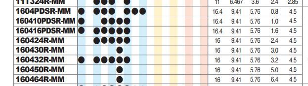

                                  Posted by Andrew Johnston on 02/01/2020 16:14:12:
                                  Andrew, when I was looking at the Korloy catalogue earlier they do the same, only adding the corner radius code to anything over what seems to be the standard 0.8mm so possibly an industry standard way to write the insert codes?

                                    I was looking at the Cutwel site. Oddly the Korloy specific inserts don't include a radius, but the ISO inserts do include a two digit radius size, after the insert code.
                                    Andrew

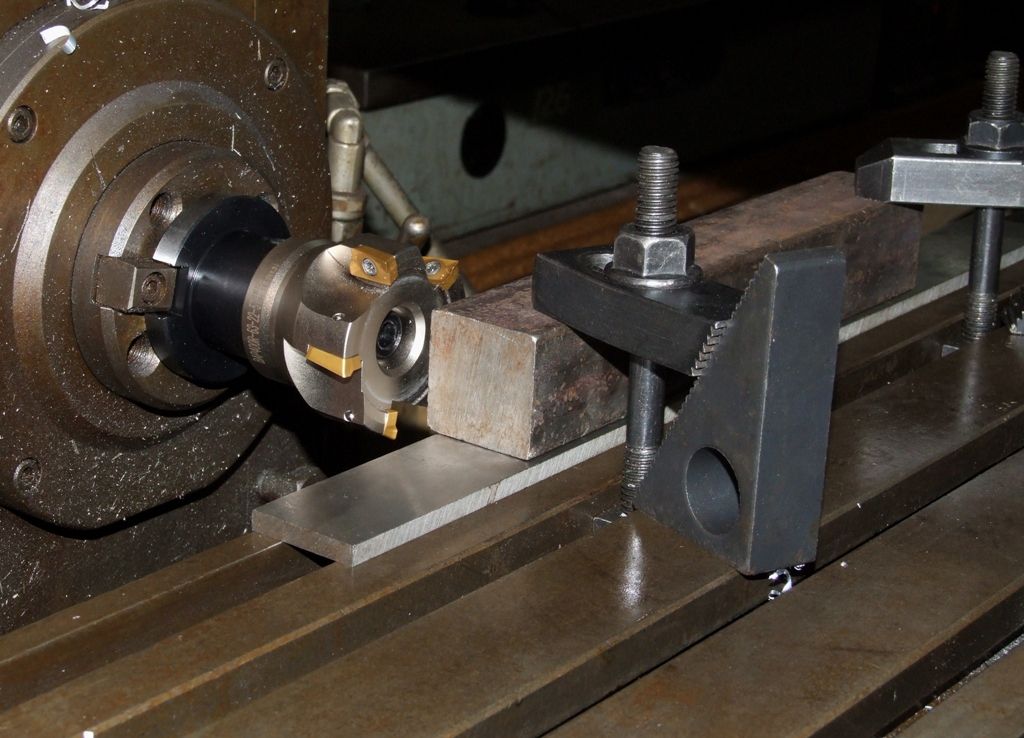

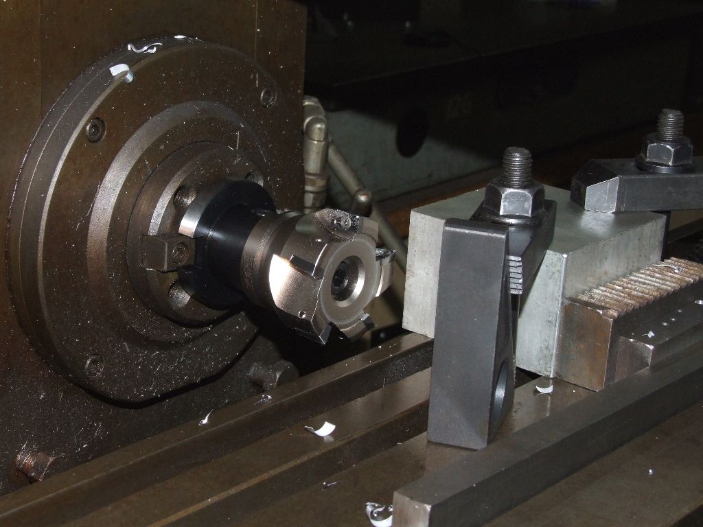

                                      The arbors I wanted are finally in stock so on Thursday I ordered a 50mm and 63mm facemill, a R8 and ISO40 arbor and 10 off of each insert type. The order was delivered on Friday morning.
                                      The facemill and arbors are a nice slide fit and the inserts sit snuggly in the pockets. I haven't been able to try the 50mm face mill as one insert screw is missing, but I have been experimenting with the 63mm facemill this evening.

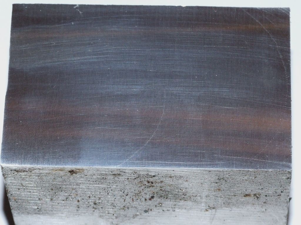

                                      I used the ISO40 arbor on an Adcock and Shipley 2E universal horizontal mill. This is a solid mill at a bit under 2 tons with (in the high speed range) a 5hp motor driving through a geared spindle. First I tried 6082 aluminium with the ground and polished inserts. Here's the setup:
                                      My mill is limited by feedrate, the maximum being 430mm/min. I wanted a chip load of about 0.1mm per tooth so (wiht 5 inserts on the facemill) I chose a spindle speed of 900rpm. I started cautiously with a cut of about 60mm wide and 1mm deep. The finish was good as shown here:
                                      At one edge the surface roughness measured 1.04µm, in middle 2.07µm and at the other edge 1.05µm, all Ra. One would expect a variation across with width as the teeth cut at different angles across the width relative to the measurement. Next I went for broke with the same parameters except for the depth of cut which was now 4.5mm, as per the maximum recommended for the inserts. Roughness measurements at edge, middle and the other edge were 1.22µm, 1.66µm ad 1.06µm respectively.

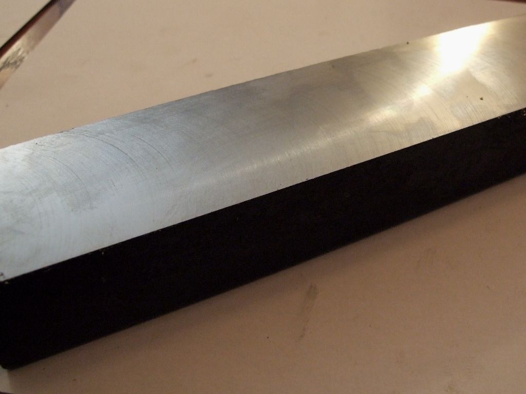

                                      Next I tried hot rolled steel with the ordinary pressed inserts. Spindle speed and feedrate were the same, with a total width of cut of 40mm. Again I started with a depth of cut of 1mm. A similar setup was used:
                                      Another good finish resulted, seen here:
                                      Surface roughness measurements, specified as before, were 0.93µm, 1.49µm and 1.40µm. Finally I gave the facemill a run for it's money using the same cutting parameters as above, but with a depth of cut of 5mm. Surface roughness measurements were 1.15µm, 1.11µm and 0.91µm respectively.
                                      Initial impressions of the facemills are excellent. in all cases the surface finish was good and very uniform. Surface roughness measurements are also consistent.
                                      All cuts were very quiet with no discernable cutting noise and not a hint of chatter. Of course the milling machine is in the brick built outhouse category, which helps. But I'm beginning to wonder what  on earth I have to do in terms of cutting parameters to test the mill to anywhere near it's limits.
                                      Andrew
