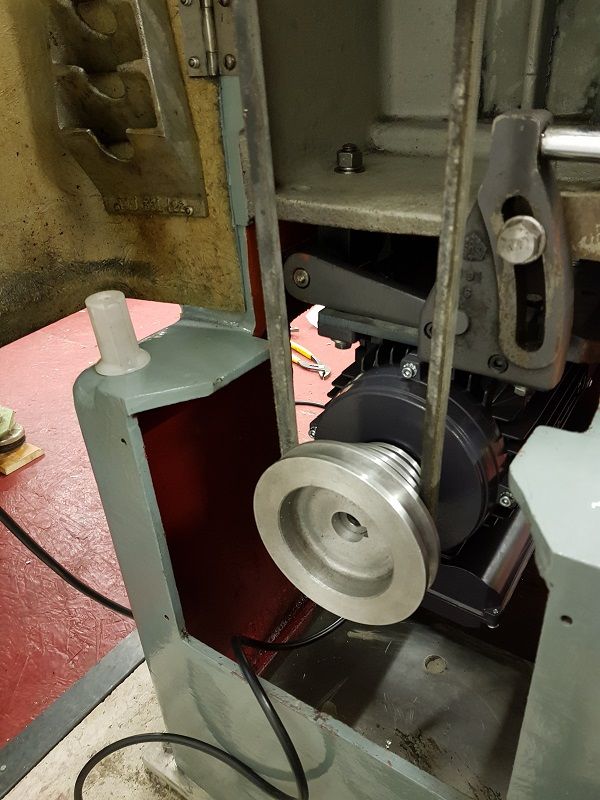

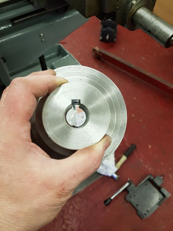

        Second attempt at this post. VM are apparently having issues which are intermittently shutting down the Internet connection. Keyway cutting went rather well with the home made tool.
        Horizontal motor has been fitted. Bit of a pain fitting it in on my own. Had to put the motor in and prop it up on some wood then bolt on the fitting plate inside the base.

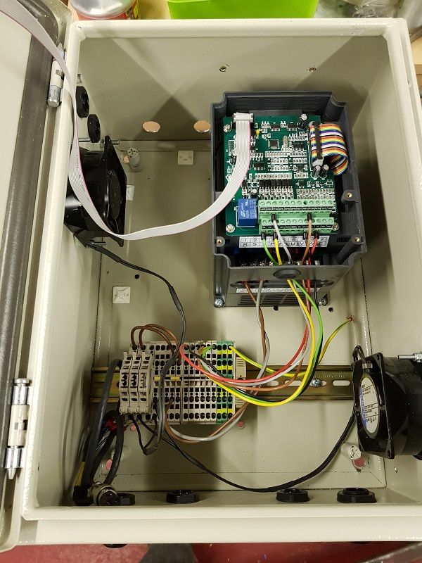

        I have the inverter and enclosure I used on my old cnc mill so I intend to use it for this mill. The inverter will used for the table drive and I should be able to crowbar in the psu, contactors and overloads for the drives.

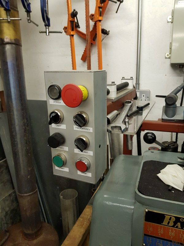

        Also have a spare box the same as I used for my lathe so going the same way for the mill.

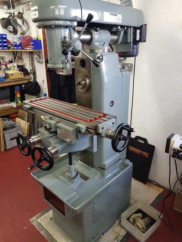

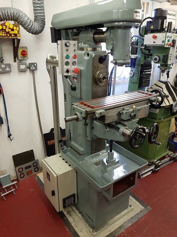

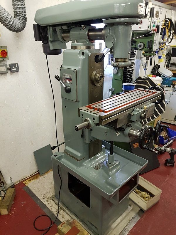

          The mill has mostly been reassembled now, just a couple of covers to finish off.
          Now its time to get started on the electrics and sort out the new motor for the table drive.

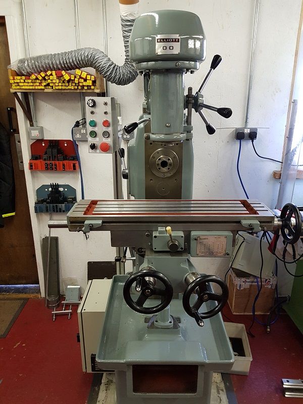

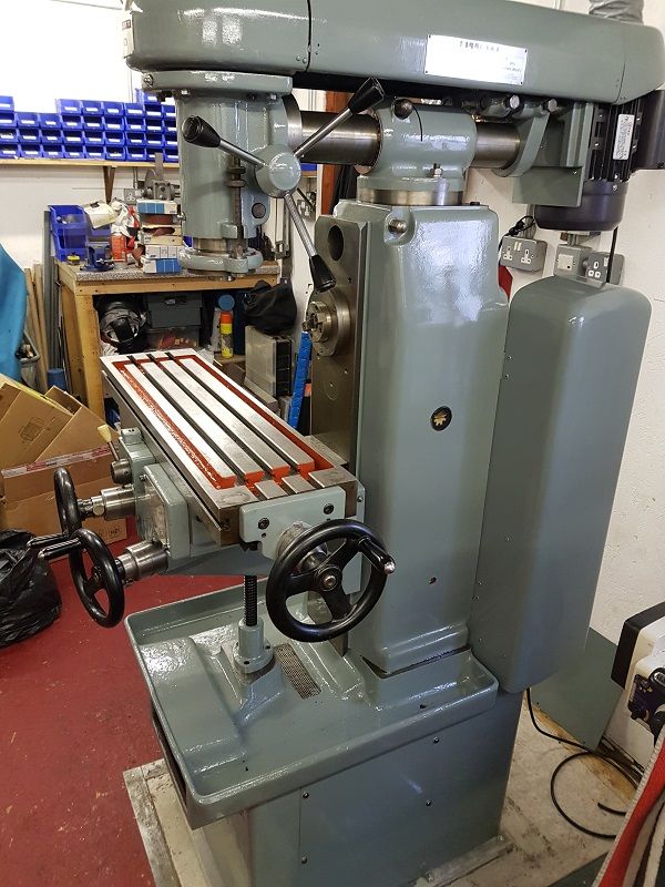

            Had a busy weekend and now have the mill running on both vertical head and horizontal. Bearings sound good under power apart from a bit of a rumble from the intermediate pulley on the vertical head but that's an easy fix.
            The motor has arrived for the table drive and I need to make a new adapter plate for it and an extension shaft so it fits in the gearbox properly. First job though is to make some t-nuts for the table.
            #411053
            Brian H
              @brianh50089
              Looking really good Ian, I'm not at all envious!!!! , but hoping to get one of these myself at some time.
              Brian
              #411056
              Vic
                @vic
                Looking good. Nice to see these old machines refurbished. Have you thought of ball screws for the table?

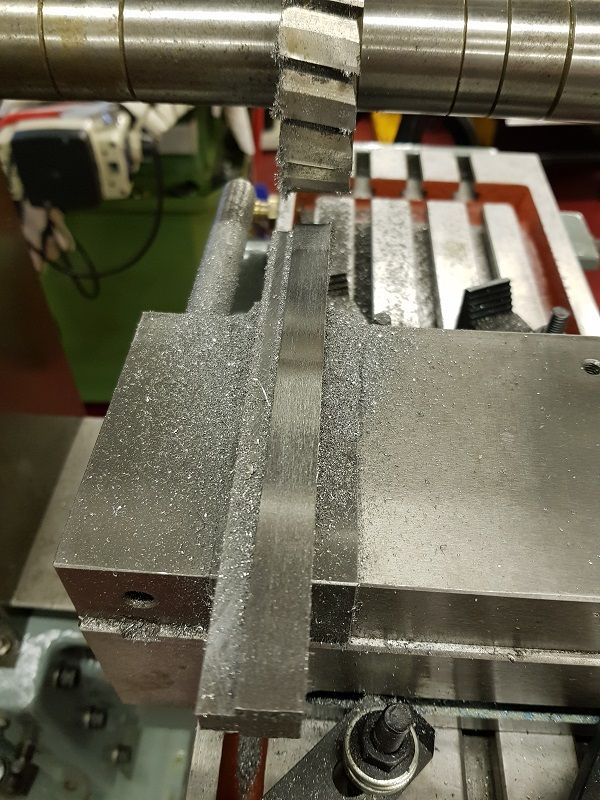

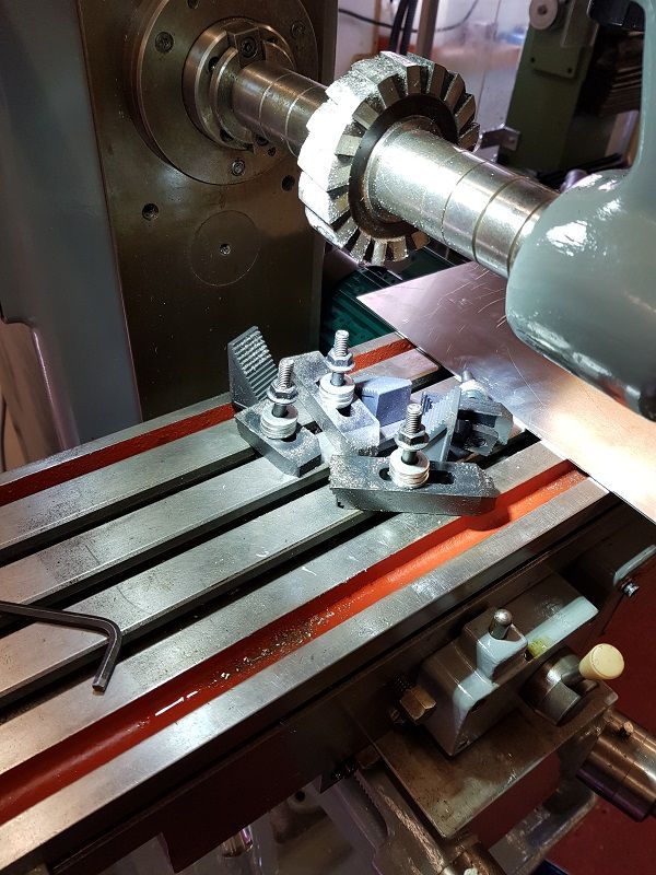

                            #411757
                            Ian McVickers
                              @ianmcvickers56553
                              Did a bit more cutting tonight with one of the horizontal cutters picked up from eBay. Definitely happy with the cut quality so far.
                              Now I need to get on with sorting out the table drive.

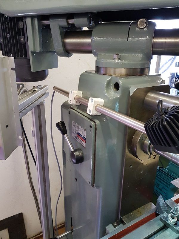

                                @ianmcvickers56553

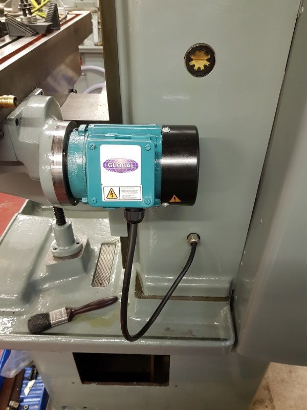

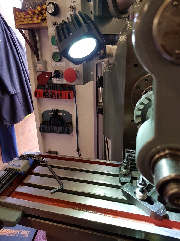

                                New table drive motor fitted. Had to alter the length of the existing opinion, make an extension shaft and fit an extra bearing inside the mounting plate to get it to fit correctly. It took a bit of time but works well now.
                                I picked up a 24v dc led lamp from eBay to give it a try as a machine light and it works well. Fitted a couple of pipe holders to the side of the mill column. An insert was glued into the bit of stainless steel pipe to drill and tap for the lamp bracket and the tube was slotted so that the cable could be run through it.
                                I may get another lamp for the other side but will see how it goes when I get started making some bits on the machine. Just got the coolant to sort out now and it should be all done.
