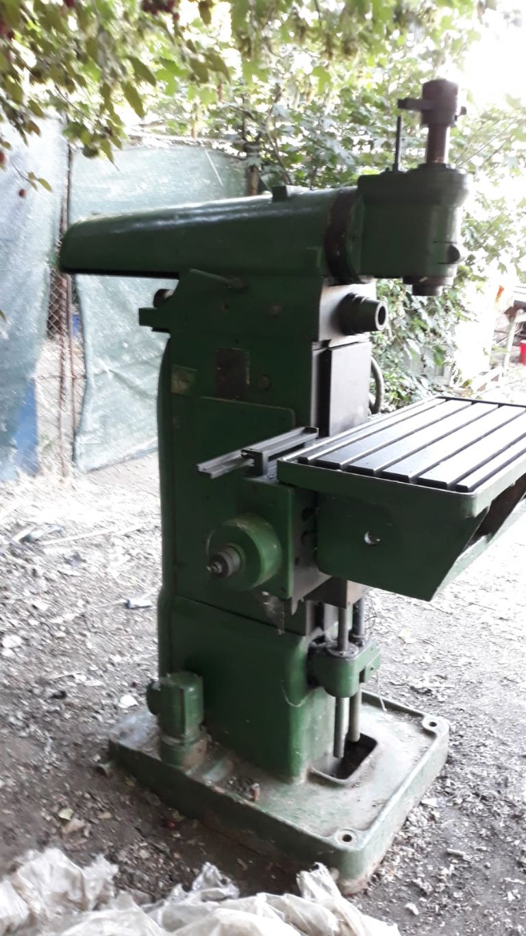

      Last winter I was looking for a milling machine. And in the end I bought a lathe
      However, last week one the seller that I was discussing back then contacted me again. He lowered the price for his mill. I didn't saw it yet, I only have some pictures. He claim that is in working order. But can't be tested. It has a 3-phase motor. One more detail, I never saw or touch a milling machine in reality.
      I wasn't planning to buy a milling machine now. I have enough fun with the lathe. But at some point in the future I'm sure I will considering to buy a new one. Something up to 2000euro and in 130-200kg range. I'm not sure if this old machine is a good deal. For sure it is more rigid, it has 800kg. But a new one is … new.

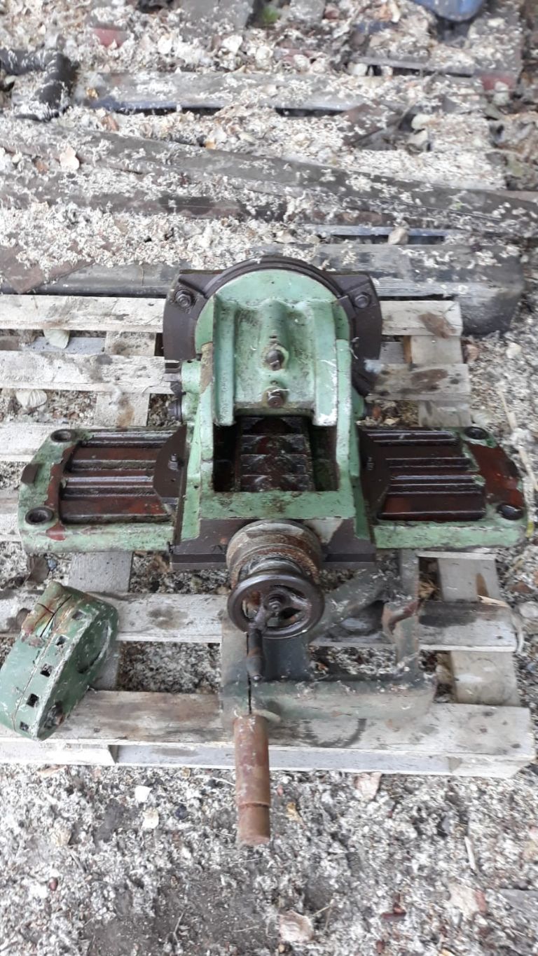

      Also in the second image I don't understand why the top part can extend to the left mote than the width of the table? And what is the table in the last picture?

          A milling machine, standing in the garden (for some time) in working order that can't be tested, is a gamble. Such a heavy machine isn't a walk in the park to take apart.
          Here in the Netherlands, these type of machines are for sale quit often so I can wait for a machine that can be tested.

            Assuming the ways and lead-screws are not too badly worn, that milling-machine looks as if it could be a very good and useful, but power-hungry, machine. It seems to have been cared for.
            In some respects the motor's condition is less important because that can be replaced relatively easily (though not cheaply) with a modern 3-ph motor and VFD.
            The extension of the "top part" beyond the table is to allow it to support the horizontal-milling arbor without encroaching on the table area. There should be with this machine, that arbor and its supporting drop-bracket, which would to have dovetails to fit those on the underside of the ram.
            What I have just noticed further, is that the head is in two parts: the ram is carried on a lower part that itself can be moved back and forth. I am guessing this is allied to using the machine with….
            …. that separate table. As I believe it is, to fit on the knee so its working surface is vertical, rather like a super-sized angle-plate. Looking at the other photos, it does seem the table on there at present is carried on a separate slide so can be swapped.
            Looking back again, there seems no in-out travel for the table itself. Instead the head is moved. I am not sure how that affects milling round an outline like a rectangle, but I've a suspicion the machine's primary use is as a horizontal mill, where all the cutting is longitudinal.
            I mentioned "the" motor. It might have more than one – the spindles, obviously, but others for power feed and table rise-&-fall.
            You'd need an overhead hoist or other handling equipment, perhaps a dedicated trolley, to swap the tables safely.
            I looked carefully but could not see a maker's name on it, but I think Deckel and Aciera are two makes with this interchangeable table system.. Try to identify it then see what Tony Griffith's lathes.co site has to say about it.

              What caught my attention is that the table has no scratch. So maybe it wasn't used too much. I have no problem to fix the machine, I actually think that would be interesting. But I'm aware that are things that can't be fixed. Or it is simply too expensive.
              Why would you need a vertical working surface? For tall workpieces?

                You know it's a Deckel right? Highly prized machine if it can be restored.

                  " Tall workpieces? "
                  Yes, but more particularly so large parts can be machined on two or more faces at right angles to each other.
                  E.g. something like a large worm-drive gearbox needing two multi-diameter bores to intersect very accurately; and too large to mount on an angle-plate on the table in the conventional way.
                  I don't know the Deckel machines in detail but it might have a knee drive arranged as a full precision power-feed, not simply as a way of raising and lowering the heavy table without wearing the operator out.

                    Not a Deckel but a Theil 158 **LINK**
                    same layout as the Deckel just a tad bigger, Stefan gotteswinter on YouTube has a Deckel and demonstrates it’s versatility, in my opinion I would prefer that over a new mill any day of the week.
                    Although I would be taking a keen interest in the accessories and most importantly spindle tooling that’s included. If I remember correctly the Theil has a proprietary design so finding tooling that fits off the shelf is a pain.

                      Indeed it looks like a Thiel 158! Or most likely a Romanian copy of it. I didn't saw the Thiel logo on the spindle. The first models were made with a custom spindle but the later ones were using standard MT5. It is a pity that the seller doesn't know this details.
