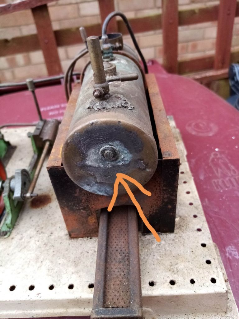

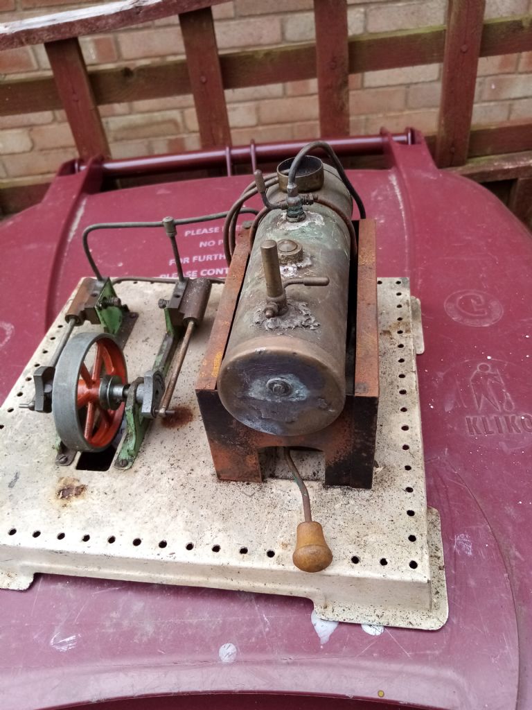

        Aquired this boiler some while back and have only just got round to having a good look at it.
        First thing I noticed was thete didn't appear to be any whete to put the wster in.
        The only thing I could find was on the end of the tank (see pic 2) where it looked like something has sheared off.

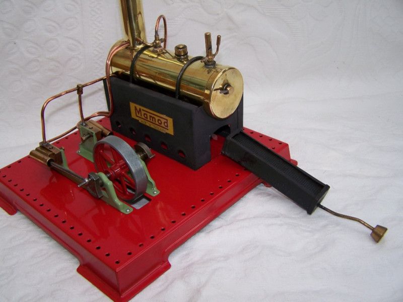

            Well this it what it should look like:-
            A Mamod SE3 twin. normally filled by removing the safety valve. I think the plug on the boiler end is removed to act as an overflow to prevent over filling.

              Plug in the end when removed, is for the water level as the boiler is filled through the safety valve bush

                If I recall correctly from my childhood some 60+ years ago one unscrewed the safety valve and used the hole to pour water into the boiler. Looking at the state of the soldering on that boiler I wouldn't want to steam it before giving it a very close inspection and run and low pressure hydraulic test, also make sure that safety valve operates at the correct pressure. Much information I would expect to find on something like the Mamod sites.

                  That looks like a Mamod set and normally you would remove the safety valve to get the water in and remove the screw in the end to establish the water level. i.e. when water comes out at the end then the boiler is full.
                  I'd be worried about the quality of the apparent repairs with soft solder along the top and the end. If it were mine I would carefully remove the existing solder followed by cleaning and resoldering with a good quality soft solder.
                  The safety valve would need to be tested to make sure it prevents over-pressure and the boiler itself would need a test just to make sure that everything is safe.

                    It is strange that the engine seems to have held on to its paint but every inch of the baseplate has lost it. I rather wonder if something other than meths was used to fire it which as well as being a paint stripper perhaps resulted in an 'interesting' steaming session.

                              The safety valve has been soldered on so I will be getting a new valve for it and re soldering it.
