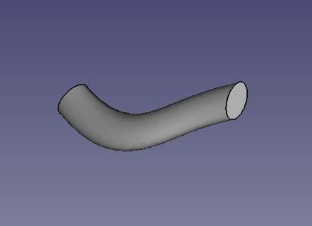

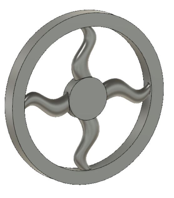

      Posted by blowlamp on 25/07/2020 13:45:32:
      Dave.
      I did a two-rail sweep (in MoI) to create the spokes.
      Draw two curves to represent the spoke outline with an elipse at one end. Sweep said elipse along both curves and it will scale in accordance with the distance between the curves.
      If Fusion 360 doesn't have that feature, then you should be able to Loft a number of various sized/positioned elipses to get what you are after.
      Martin.

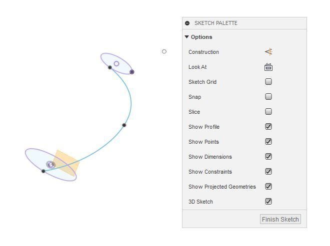

      Thanks Martin,
      Firing up my Windows 10 Laptop triggered a big update after which Fusion no doubt will also have to be refreshed. In the meantime, I tried lofting in FreeCad, similar to MOI I suspect except there's only one rail.

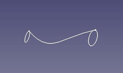

      Two ellipses on different planes joined by a spline curve, producing:
      Although the curve's not correct for Jason's Flywheel the method works as a demo I expect Fusion to be easier to use, but my Windows machine is still downloading, installing and rebooting. Oh, and the Windows mouse is missing!

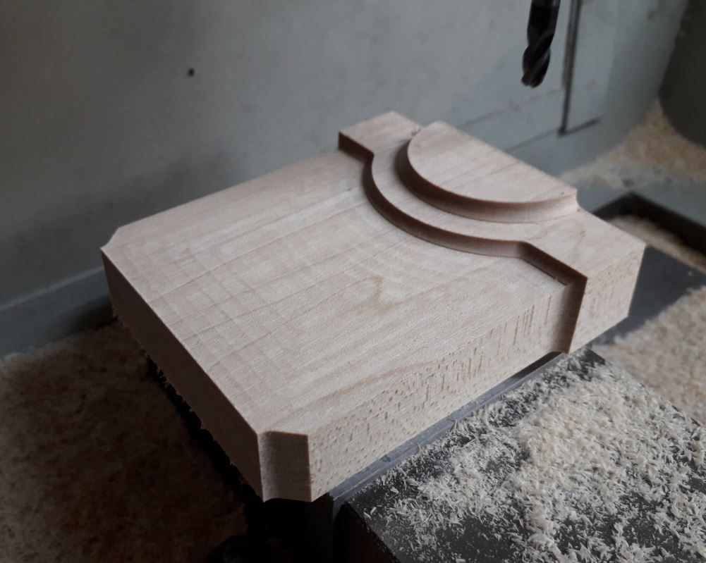

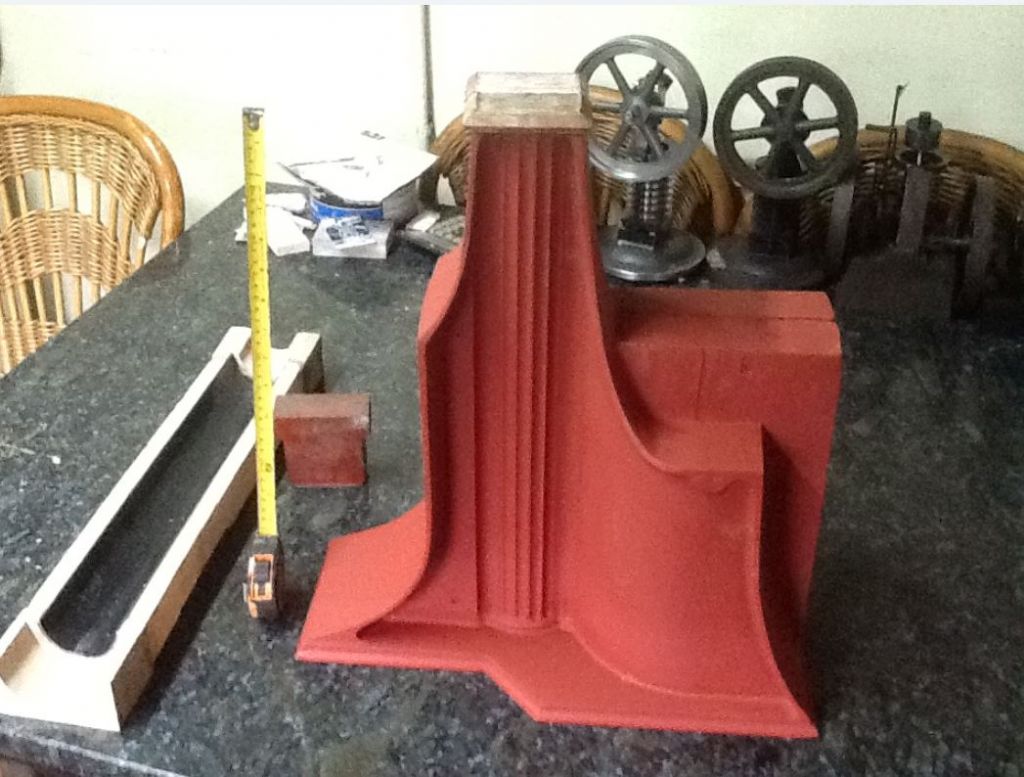

          Graham's cylinder, head and frame pattern with half a corebox along side
          part of the top bearing yoke pattern I cut earlier today
          I tend to draw to the size I want the model in Alibre including machining allowances on the faces that need it and draft angles where required then scale the model at the end to increase the pattern for shrinkage allowance. Fusion makes it a bit easier to draw the finished part then add draft and machining allowances before scaeing the shrinkage.

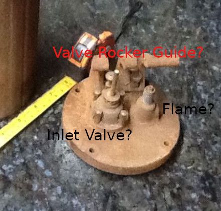

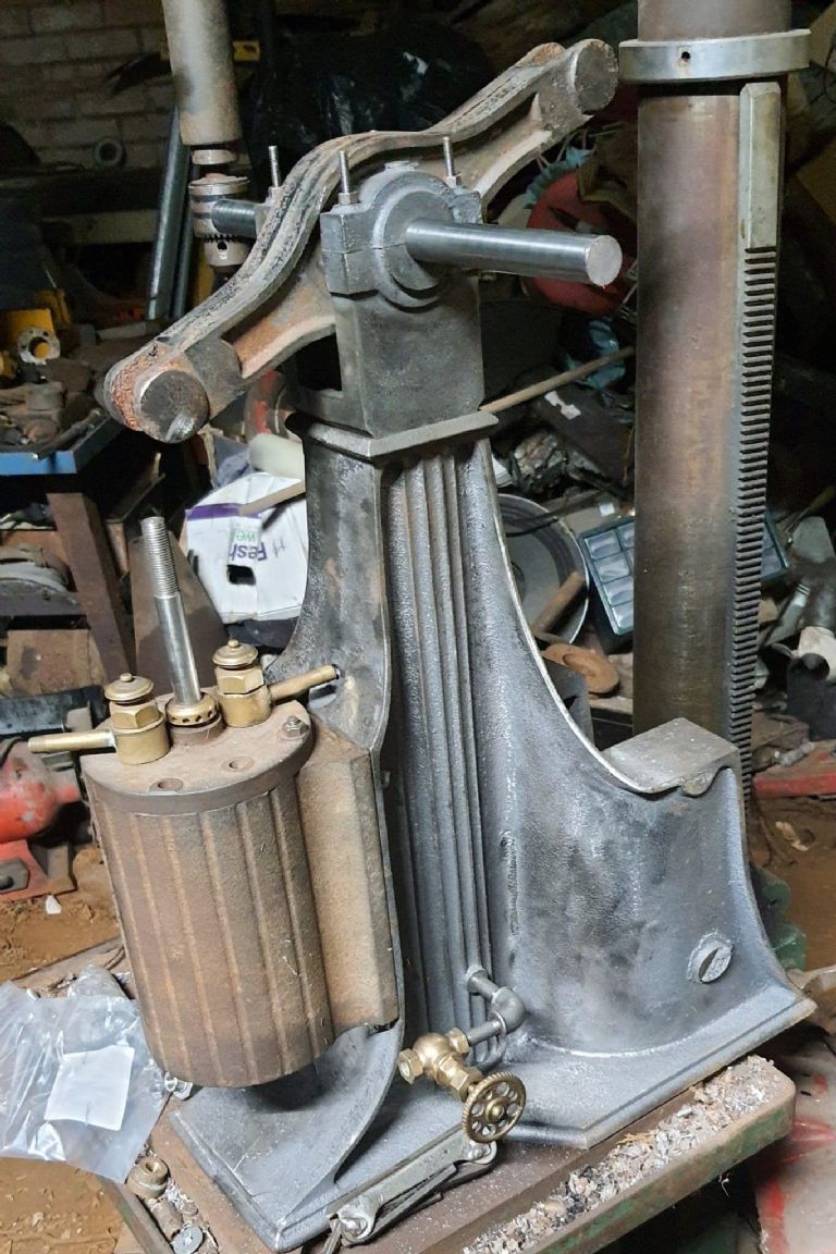

            Delighted to see I've not got it completely wrong. This bad-boy has got to be the James Dean of Internal Combustion engines! Every home should have one!
            I guessed wrongly the engine didn't have inlet and exhaust valves! The gubbins that works them must be round the back.
            This clip from Jason's photo reveals what's on the mysterious bottom of the cylinder, which I was ignoring:
            I now think the claw holds a rocker arm driven from the back of the engine, and the Inlet Valve is the spike thing. Still mot clear to me where the fuel connects, or how the flame works.
            This is a fascinating engine, a nice mix of clever engineering and genius design, but with many early imperfections. Very inventive considering it's a piston engine based on the same thermal cycle as a modern gas turbine. (I'm sure Duncan is right.) I'd pay money to watch a few of these ticking over at an Exhibition.

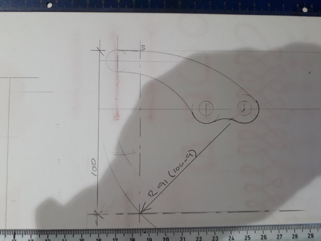

                    Point B should not be too hard to find, I've added a couple of dimensions onto my hand drawn one posted earlier.
                    First draw a line parallel to the top horizontal AB 100mm below it
                    Then set compass to 91mm (100-9) and swing an arc with compass point in the far right point so it intersects the 100mm down line.
                    The intersection not only gives you the springing point for the R100 edge but if a line is projected vertically upwards this will be the point where the horizontal top edge joins the 100R arc.

                        Full marks and a gold star to those who managed to produce an image of the flywheelstar.
                        As Dave has not handed his in yet he gets the detention project of manually writing the 27,500 lines of G-code to produce this. One down…………..
                        Edited By JasonB on 27/07/2020 13:07:24

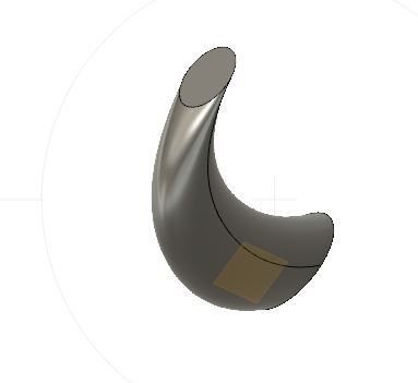

                        #487818

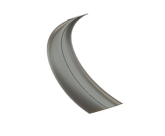

                          The reason Dave's homework hasn't been handed in:
                          Got into a fight with Fusion 360, which I have to say is messy in this department. It's easier to do in FreeCAD.
                          No problem drawing two ellipses on separate planes. Likewise, seemed straightforward to draw a spline curve as a rail connecting them, except it isn't. The issue is how to connect two ellipses in 3D space when the model has three 2D sketches in play. The sketches aren't connected automatically, nor is there an obvious 'External Geometry' button. Whilst editing an active sketch, the create toolbar (click it) has a Project/Include option hidden away. It includes projections from another sketch, making them available for snapping in the current one. The two ellipses first have to be selected by this tool, turning them purple (as above) before a rail line can snap between them.
                          I may have made life difficult by switching on the 3D sketch option because moving spline points & angles in 3D is like driving on wet ice with bald tyres. For added fun, Fusion doesn't allow spline points to be grabbed directly by the editor as I expected, instead the Move Tool has to be engaged.
                          Mostly Fusion behaves as I expect it should, but this particular feature was hard work. Maybe I'm making life difficult for myself by not doing it right! I'll try again this evening.
                          As can be seen from the images I haven't got the spoke into its correct S shape let alone set dimensions and repeat copied it into a wheel. If Sir is in a very good mood I might get a C minus for effort…
                          #487820

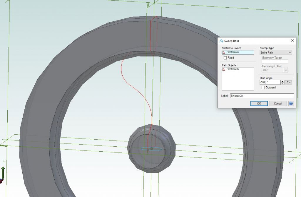

                            This is how I did it in Alibre
                            Firstly the cross section of the rim & hub were drawn and rotated about the central axis
                            Next ellipse drawn on what is the horizontal plane in the above image. (blue)
                            Then the path that the ctr of the spoke is to follow (red) was drawn on what is the plane facing you
                            Then I used "Loft" to make the ellipse follow the path and added 3degrees taper so that the spoke kept the same proportions but got smaller as it radiated outwards.
                            The single lofted spoke was then repeated in a pattern of size about the central axis
                            Finally fillets added where spoke meets hub and rim

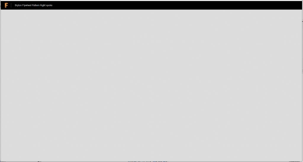

                            If you want to look a it in F360 click this link for the spoke, you can also go to manufacture if you want to look at the tool paths and simulate the cut and the g-code is there too for you to copy out as that may be easier than writing from scratch.
                            #487822
                            Gary Wooding
                              @garywooding25363
                              Hmm, the link just produces a blank screen for me.l

                                  This is all I get. It must be something to do with permissions.

                                      And my version on Fusion.
                                      Whoops, only 4 spokes, a mistake taking seconds to fix in parametric CAD:
                                      I seem to have broken the Learner Barrier – only took a few minutes to fix the S shaped spline, loft a spoke, add a hub, rotate 'n' copies and do the rim. Not as nice as Jason & Gary cos' I didn't bother to add fillets, which is rather easy.
                                      Jason's spoke is also finished as a pattern with roots.
                                      I'm supposed to be doing something else!

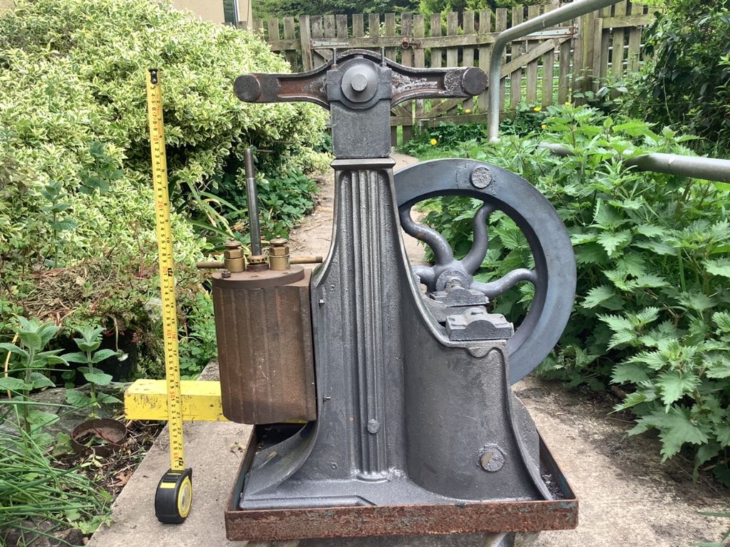

                                      #608771
                                      Alyn Foundry
                                        @alynfoundry54186
                                        Whilst convalescing I came across this thread, very interesting indeed but way over my head.
                                        I am very grateful for the amazing work that Jason has done for me of late, I started on the Brayton model way back in 2004. It’s been a mainly off and on type of project but with Jason’s help I’m nearing the finish line now.

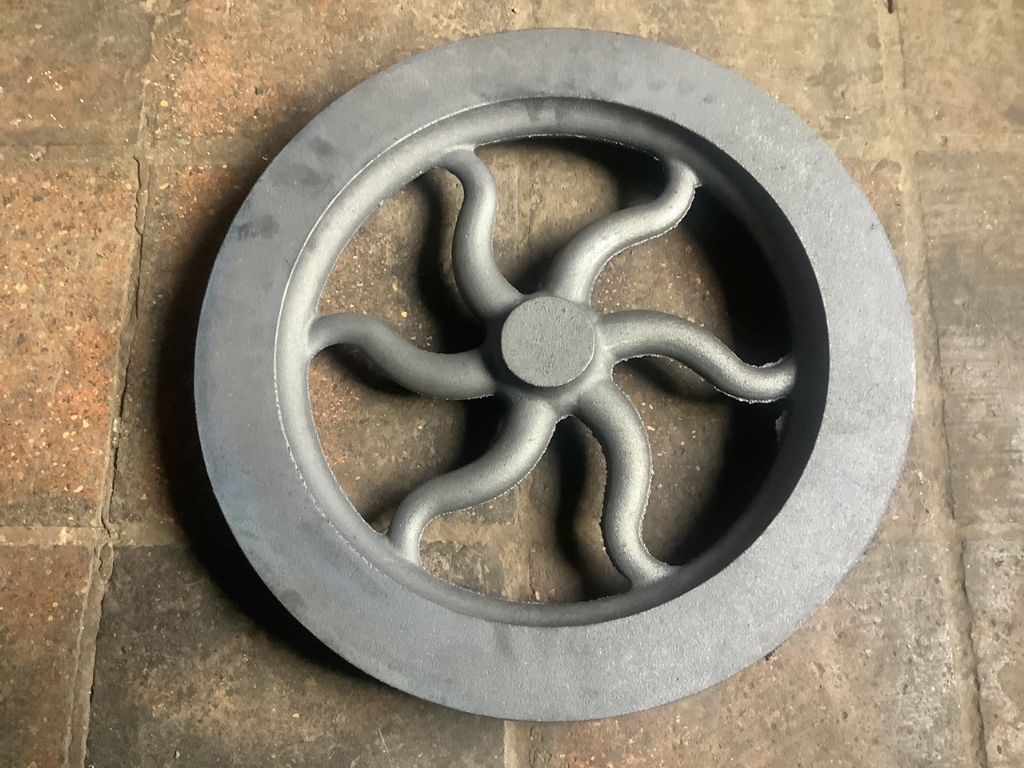

                                        The flywheel has been cast and is ready for machining, just waiting for my number 2 son to get his 8-1/2” swing Le Blond up and running. I have a few pictures available but don’t know how to post them here. The model is really taking shape now putting all my equipment to the very edges of their capabilities.
                                        The cylinder head photo, recently posted, shows the inlet valve to the left hand side with a very simple exhaust valve on the right. The inlet is mechanically pulled open to allow the fuel and air mixture, at around 60 PSI into the cylinder which will be ignited by a pilot light ( that’s the original method ) time will tell as to what I will use eventually. The inlet is then mechanically closed to allow for the expansion to occur. Just like a two stroke the exhaust is opened at TDC for the downstroke. The cycle then repeats. The top side of the cylinder is the air compressor. The fluted column is the air receiver.
                                        Please feel free to ask any questions about this project, because of the many other “ Irons “ in the fire might take a little more time to finish.
                                        Cheers Graham.

                                              It seems that my tablet couldn't handle the task. Here are a couple of photos of the Brayton Ready-Motor including the lovely flywheel casting that weighs a little over 30 Kgs.
                                              0817a131-26b0-4d96-a47d-56f812083b3e.jpega9af035c-095b-4485-90d1-d52a4344ae75.jpeg7a8f2017-8ba0-4447-b55a-917e38731484.jpeg
