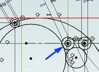

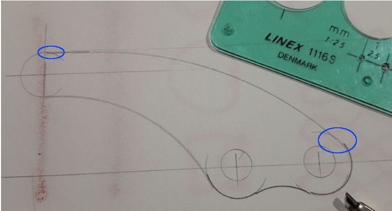

      Apologies in advance for being a churl, but I've highlighted my learned colleagues drawings in blue were I think the curves look like tangents, but are eyeballed approximations or mistaken.
      The mistake, line actually tangent with the lower construction circle rather than the target:
      By eye, zooming in suggests the lines don't actually meet:
      My painful effort shows the construction lines needed for accuracy. It isn't quite right either – one of my dimensions is bodged to 99.9941 rather than 100 in order to get the curves to meet correctly. Although done in QCAD I only used drawing board methods – circles – to position the curves. Promise!
      Although a close approximation can be sketched without too much bother, I still think this is tricky to draw geometrically, ie with tangents accurately at 90° to a radius. I might have made heavy weather of it. Any Old School professional draughtsmen out there?

        To get the right intersection point I used a parallel line offset 100mm from the horizontal line and struck an arc of 91mm centered on the lower/right circle – its radius being 9mm which, when added together gives 100mm and is the required radius to give tangency between the top line and the rightmost circle.

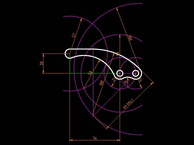

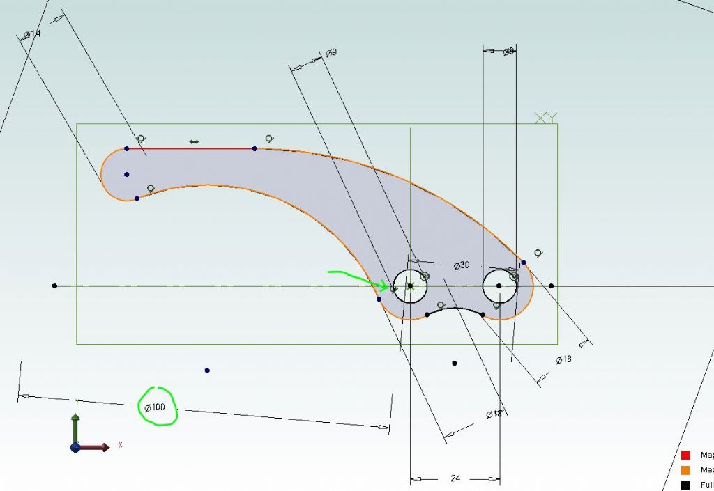

            Dave, that wrong tangent was picked up during trimming actual part is correct as you will see with a close eyeball of the rendered image posted yesterday. Yes just a quick pencil sketch to show it can be done easy enough with basic drawing instruments could spend more time on it but better things to do.
            This is the actual sketch after trimming the fat used to create the part, as you can see I got the full 100mm and the tangent symbol is there, the black dot represents end of the 50mm radius and start of the 9mm.

              Permit me please, to ask an innocent question:
              What are the XY co-ordinates of the centre of that 100mm circle ?

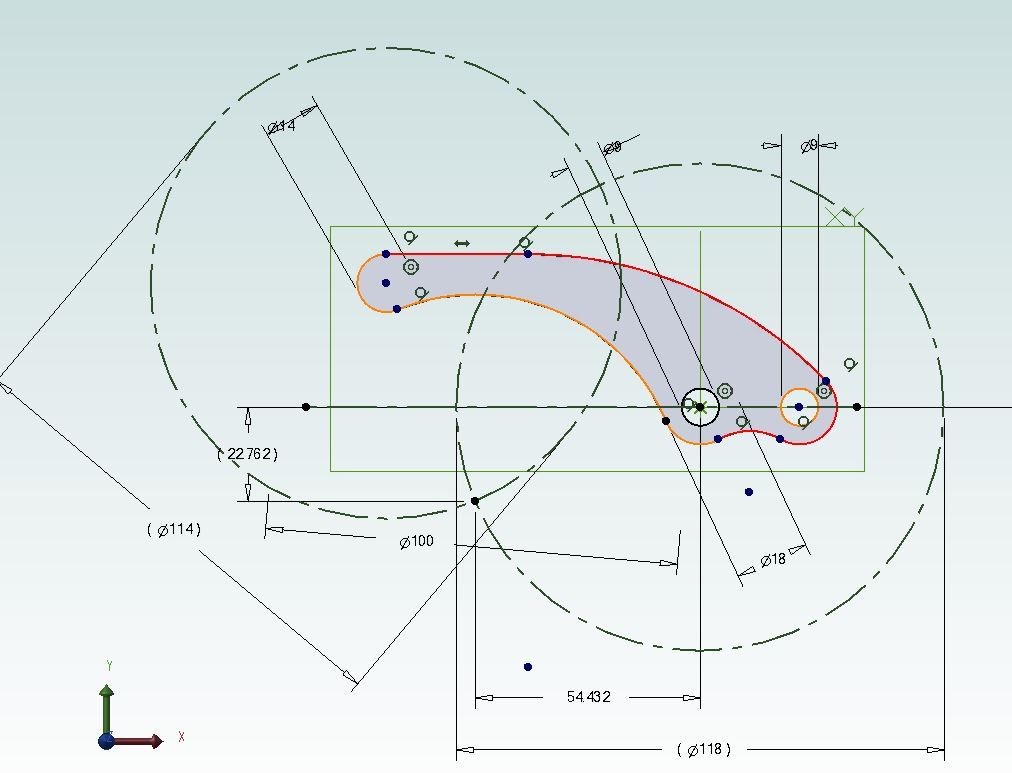

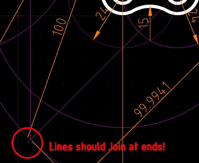

                Quite right about better things to do, for practical purposes our drawings agree, while mine took about 90 minutes to get right. (I was half watching telly at the same time!) Here we are overlaid:
                Michael's innocent question about the XY coordinates of the 100mm circle's origin has me embarrassed too. Although I derived it geometrically and drew the arc from it, the position isn't spot on:
                In theory, the purple lines inside the red circle should both be 100mm long and meet together on the circle. To get the 100mm arc to join correctly I had to bodge the origin slightly, hence the 99.9941 dimension. Something's wrong.
                Have to read Blowlamp's post carefully next. I think I'm applying Martin's method – or trying to – and may be getting it wrong. Job for this evening, I'm out today.
                Always worth asking in engineering if the effort is worth it. The rigorous geometric approach to drawing tangents is is good because it highlights errors, but bad because it takes time. When chaps discover errors in plans, have some sympathy for the draughtsman. More work if he takes pains drawing features like tangents and unnecessary gold-plating if the feature is cosmetic. On the other hand, quick methods are more error-prone and likely unacceptable when accuracy matters – cams & lens etc. Horses for courses again.

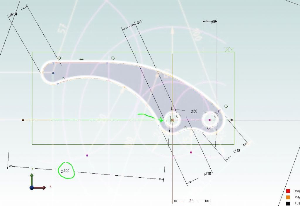

                  I made a video that I hope makes it a bit clearer than my not-so-clear post. blush
                  I start by having the basics already laid out and first show how my CAD can quite quickly do the 50mm & 15mm arcs that link the circles that are on screen.
                  I then draw the horizontal line at some random length and offset a copy of it by 100mm below.
                  Next comes the actual point of the video, in the form of a 91mm radius circle centered on the right hand circle of 9mm radius to derive the intersection point we need to centre a 100mm tangent arc betwee the top line and the 9mm radius circle.

                    Posted by Michael Gilligan on 22/07/2020 08:29:12
                    I get them at: X33.334, Y-63 as laid out in my video with the small circles centered on the XY axis lines.
                    Martin.

                      Posted by Michael Gilligan on 22/07/2020 08:29:12:
                      Relative to the centre of the top left circle, x = 34.3342, y = -93

                            Michael this is what I get if I let the CAD generate the dimensions, it moved the ctr by itself as each pair of circles where constrained by using the tangent icon. Left of the two circles is at 0,0 ctr of circle – 54.432, – 22.762
                            I have also added two dashed green circles that show how it was also done the "compass" way by swinging arcs of (R1 + R2) from the ctr of each point and then swinging R1. Where R1 is the 50mm radius and R2 the Radius of teh corner eg 7 or 9mm which gave the 118mm circle (57r) and the 114mm circle (59r)
                            Not too bad to do manually, you would either need a large piece of stock or  alarger tooling plate so that the ctrs of the various arcs could be marked . It would then just be a case of locating each ctr point under the spindle of your BCA and moving in x or y the appropriate amount +/- tool offset and then rotating the table. Ctrs could be marked out from either CAD derived ones or with scriber and dividers. main issue with doing it manually is not overcutting an arc, here is one I prepared earlier with CAD positions and manual machining, expect I would use the CNC now.

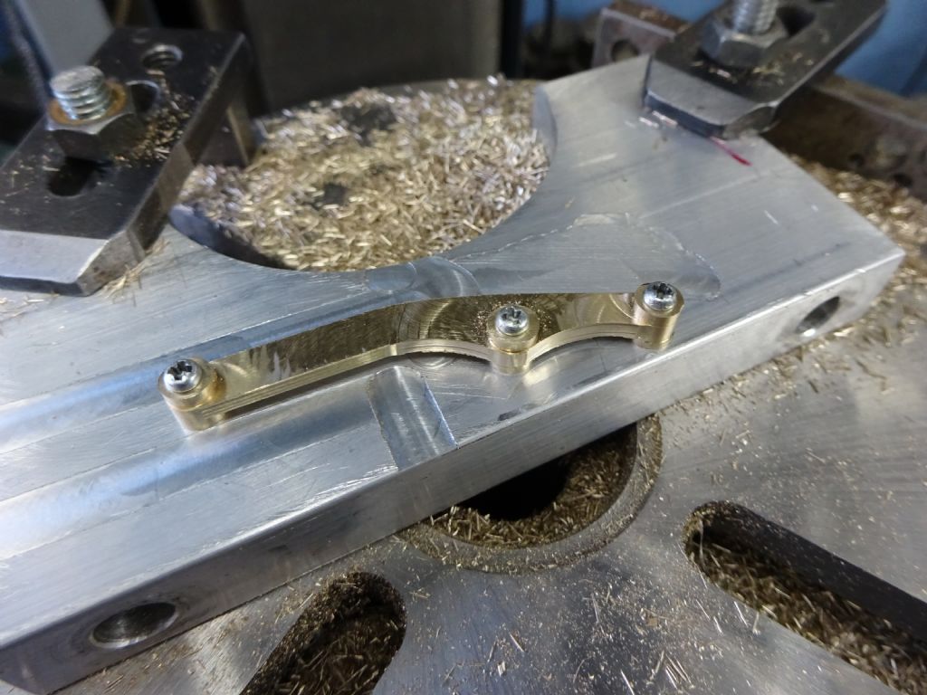

                                If doing it without marking out rather than reposition the work each time and rotating the table to do the cut the table you could move the X&Y to the required ctr and then use a boring head to swing the 50mm radius. If you did not already know the co-ordinates then maybe locate 14mm and 18mm Buttons and then set the boring head to the required diameter and gently swing by hand until the tool just kisses the buttons.
                                Would not work on the larger 100mm radius as you could not swing that as an external radius due to the straight part that joins it. It would also be quite exciting to swing a cutter at that radius!
                                I must confess that I really did make that part quite a bit earlier, a couple of years earlier infact.

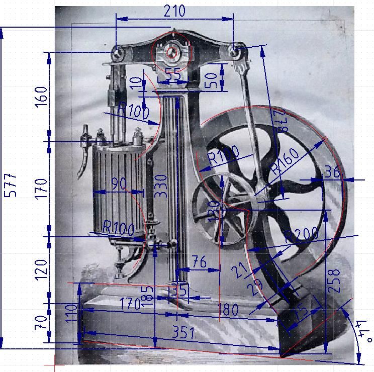

                                        So here is tonights homework which takes a slightly different form to what has previously been posted. Rather than trying to replicate a drawing here is an old etching of the "Brayton Ready Motor" that I have been helping Graham Corry of Alyn Foundry fame with by drawing some patterns.
                                        You are free to use whatever methods you like so anything from Crayon, chalk or charcoal right upto a fancy 3D rendering will be considered and can also just be a 2D side view or 3D model Only criteria to meet is that the iron flywheel will need to have a finished size of 15" dia (381mm) rim 1 1/2" wide and hub 1 5/8" wide.
                                        No cheating by searching around on the net for what I may have already posted, the third version is the one we have settled on. I'll post mine in a day or so.

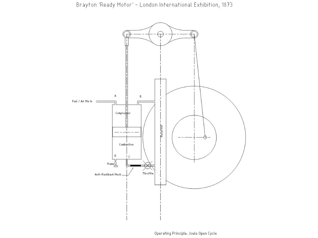

                                          Reading the blurb to the side of the drawing (which doesn't quite flow properly), I see this isn't a Steam Engine. It's an early gas engine, using Internal Combustion.
                                          If I decode the words correctly the engine is fed a pre-compressed mixture of fuel & air and the top half of the cylinder pumps it into a reservoir hidden inside the pretty fluted column. From there, the fuel passes via a throttle and a wire mesh flame trap direct into the bottom of the cylinder, where it is ignited by a continuously lit open flame underneath.
                                          It doesn't work like a modern IC engine, where intake, burn and exhaust happen inside a cylinder sealed and opened by valves in concert with timed ignition. Rather it appears fuel and air are pumped into Brayton's cylinder throughout the power stroke, and the mix is ignited immediately by the flame. It must rely on the flywheel to overcome the pressure generated by ordinary burning to push the still burning exhaust out. I can't see in the picture where the exhaust vent is, possibly exhaust just flashes out of holes in the cylinder base.
                                          The wire-mesh flame trap is needed to stop fuel/air in the reservoir igniting and flashing back to the main fuel tank, kerboom.
                                          The operating cycle was first described by Ericsson, then rediscovered by Joule, and implemented by Brayton.
                                          I notice the engine wasn't demonstrated to the Judges at the Exhibition, and suspect it was a tad too dangerous to attract paying customers! Most of the pictures I found on the web of Brayton's Ready Engine show later models which looks to have been tamed. In the 1876 version, the power and pump cylinders have been separated (ie flywheel drives a separate pump), and the pump creates a vacuum sucking liquid fuel through a nozzle into an air-stream as a carburettor.
                                          Other layouts exist though – this one shows an engine more like Jason's etching, with a clue it runs on Benzene:
                                          All this to avoid doing the hard part of Jason's homework – recreating a buildable model engine from a 19th century woodcut…

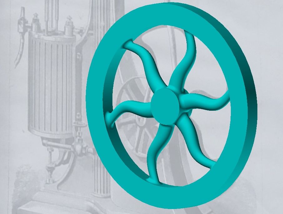

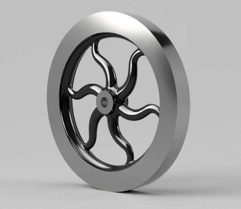

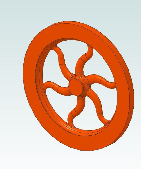

                                            Dave, good to know you enjoyed the diversion into the Brayton cycle but it's no excuse for late homework!
                                            This is my effort on the flywheel, not quite right where the spokes blend into the rim but Alibre trips up sometimes when trying to add fillets to a tapering lofted ellipse following a curved path when it intersects with another compound curved surface. Nothing that can't be sorted with some body filler on the pattern before casting.
                                            This is one half of the pattern that has draft angles and shrinkage allowance, the other is the opposite hand so that the spokes match when the two halves go together
                                            And this is a rendering of how it should look when machined.

                                                  Further to SOD's post, the top half of the cylinder sucks in air from the atmosphere mixed with fuel, and pumps it into the receiver. This air fuel mix is ignited as it passes into the bottom half, thus increasing it's volume. Much the same as a gas turbine except the fuel is introduced into the air after compression.

                                                    Jason's Flywheel has me worried. I'm not sure how to produce the 'S' shaped spokes in Fusion 360. Might be tricky. Time will tell.

                                                      Dave.
                                                      I did a two-rail sweep (in MoI) to create the spokes.
                                                      Draw two curves to represent the spoke outline with an elipse at one end. Sweep said elipse along both curves and it will scale in accordance with the distance between the curves.
                                                      If Fusion 360 doesn't have that feature, then you should be able to Loft a number of various sized/positioned elipses to get what you are after.
                                                      Martin.
