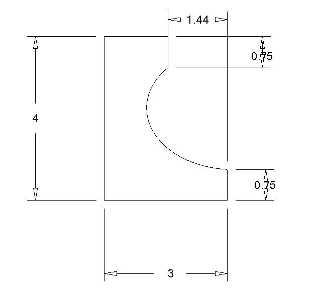

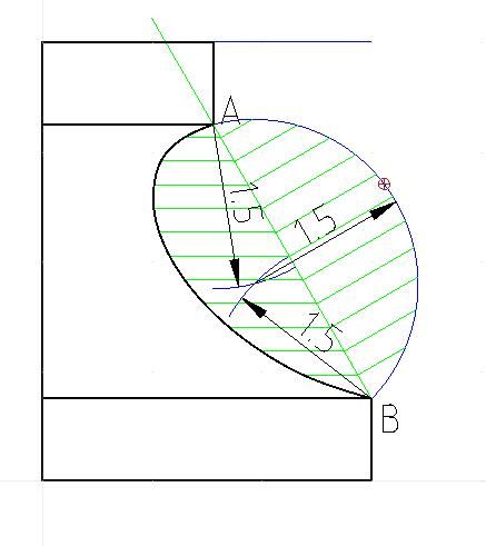

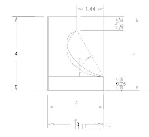

        Drawn with three arcs and it's not too far out, using SODs clue about the 1.5" arc.
        Martin.

          Hang on.. this is a moulding so to replicate it you need the negative. Release agent and plaster may do the job..(ducks and runs..)
          pgk

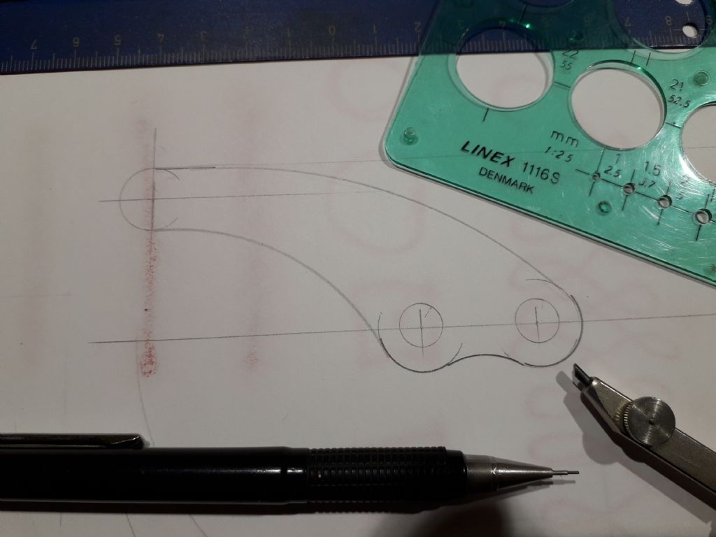

              I'm still confused, the only constraints seem to be the 2 ends of the 60 degree construction line, and that fact that 1.5" radius comes into it somewhere. There are still an infinite number of solutions.
              #483762
                How did I do? one line produced from a 1.5R semicircle

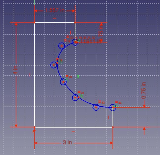

                  #483874

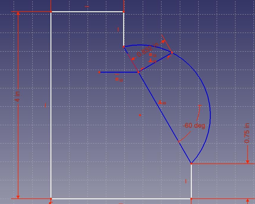

                    Posted by JasonB on 03/07/2020 19:54:05:
                    Fair effort, the curve is fuller than mine, I give it a B+, same mark I give my attempt at scaling and aligning our two drawings!
                    Here's how my book does it:
                    1. Find the origin of the blue 1.5" radius outer semicircle by drawing two 1.5R arcs from points A and B
                    2. Draw the blue semicircle and then several perpendiculars to it from the 60° line AB
                    3. Then draw connected horizontal lines of the same length, the ends of which define the required curve.
                    A CAD package should include a spline curve tool to span all the construction ends and draw a clean curve. The easiest way to join them manually is with a French curve tweaked to blend nicely by eye. Not as easy as it sounds to draw really smooth curves by hand, my attempts usually have obvious joins! And see Georgineer's post about being marked down for blending his curves too well in a City & Guilds exam!
                    Comment on the book method – unlike bending a spline, or picking a random French curve out of the box, it generates accurate reproducible dimensions for the maker. Whether or not the result more artistic than, say, Jason's fuller example is a matter of opinion. Might just be fashion, but some curves, like a Spitfire's wing, definitely look better  to most people. I've no idea why!
                    Edited By SillyOldDuffer on 04/07/2020 11:59:29

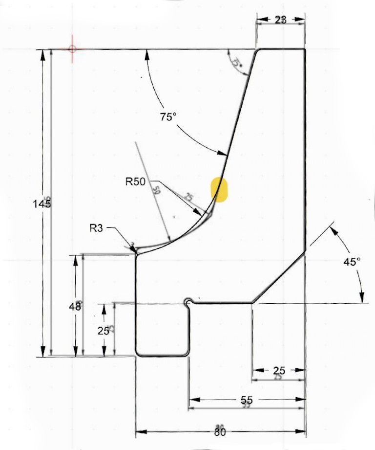

                      #483888

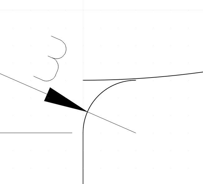

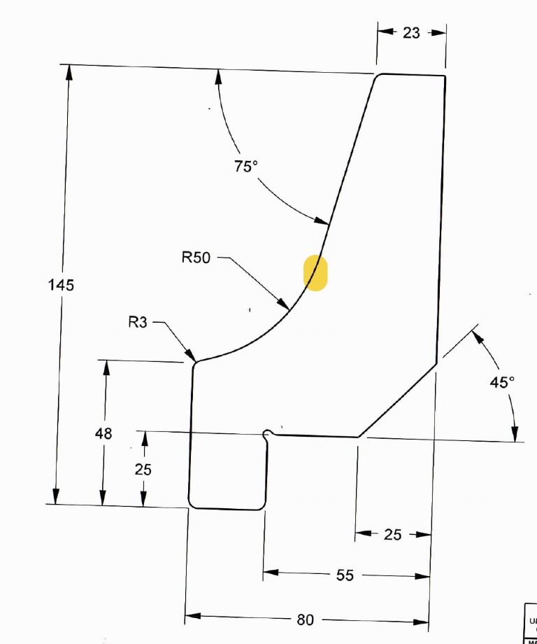

                      Gary Wooding
                        @garywooding25363
                        Here's a test that might be of interest. The yellow spot indicates a tangent.

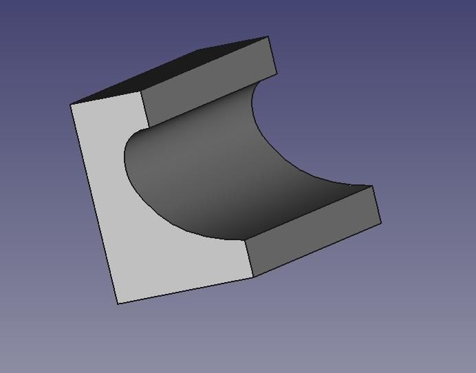

                          I did it a bit differently.
                          Drew out the shape with a diagonal lien inplace of teh curve and extruded that.
                          Added an additional plane at an angle, in this case 45deg
                          Drew the semicircle on the new plane and positioned it so the curve passes through the two points where angle meets vertical
                          Cut extrude the semicircle and the end view is what I posted, playing with the angle of the plane will alter the severity of the curve produced.
                          #483918
                            Posted by JasonB on 04/07/2020 13:21:00:
                            I like it, and there's a parallel between creating a new plane and my book's tilt a semicircle method.
                            As expected I had trouble using the book approach with FreeCAD's Part Design Sketcher. The lack of Layers to hide construction detail makes it clumsy, and the need to Constrain everything is time-consuming. It can be done, but I made an early mistake in this model that takes a lot of backtracking to fix. The top dimension has floated to 0.751" because the sketcher honours an incorrect constraint, and it can't be forced to 0.750" without undoing several steps. Lots of constraint clutter in red already with many lines still to be added:
                            FreeCAD's sketcher makes a poor general purpose 2D drwaing aid. Of course it's not meant to be used as one! It has an easy to use Spline Tool. The draughtsman just adds a spline curve and shapes it to look pretty. The whole moulding can be drawn in a few minutes provided Old School exactitude isn't demanded.
                            and seconds later:
                            One more small step and my 3D printer could be churning a moulding out while I enjoy a glass of wine!
                            Edited By SillyOldDuffer on 04/07/2020 15:13:31

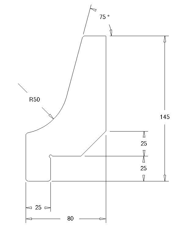

                            #484098

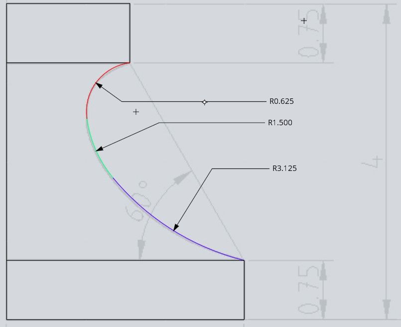

                              Posted by Gary Wooding on 04/07/2020 12:50:20:
                              Certainly is, and I've awarded myself a 'C-, could do better'.
                              My version:
                              Not bad at first glance, but there are a few problems. First my R50 curve doesn't match Gary's, nor does my blend. Differences emerge when our drawings are overlaid:
                              Thought logical at the time I've not positioned the origin of my 50mm radius curve correctly: it's too high. A second mistake pops out when the junction between R3 and R50 is zoomed into, the curves don't meet.
                              On a hand drawing, the two curves failing to join wouldn't matter much; a human reading the drawing might not notice the gap or care. Fatal to 3D CAD and CAM though. That tiny gap is a serious error because the geometry described by the broken drawing is impossible. A 3D object can't be created from it. Drawings that look perfect are a common cause of 3D beginner frustration.
                              Not sure why my 50mm radius is wrong, I need to have another think. Gary can bask in glory while I retreat in confusion…
                              Edited By SillyOldDuffer on 05/07/2020 15:56:12
                              #484105
                                You should not need to place the origin of the 50mm radius. You just need it to be tangental to the angled line and intersect with the end of the 48mm vertical line. once that is do radius the junction.
                                Edited By JasonB on 05/07/2020 16:27:52
                                #484134
                                  Posted by JasonB on 05/07/2020 16:15:49:
                                  Thanks Jason – I've been overthinking it!

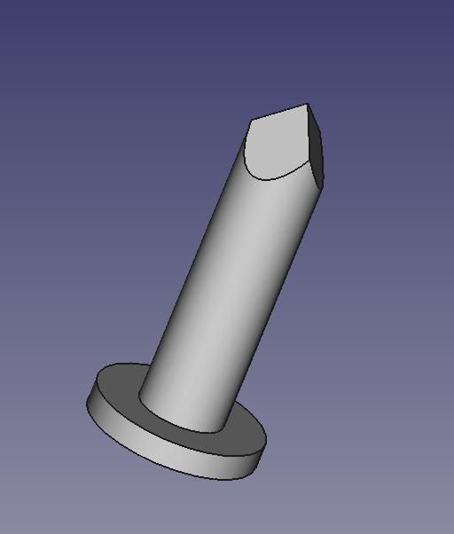

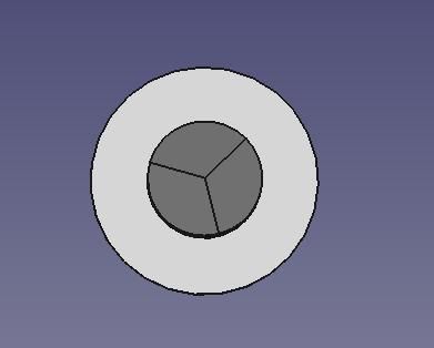

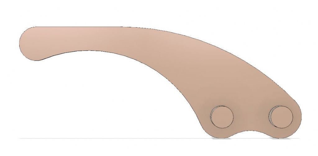

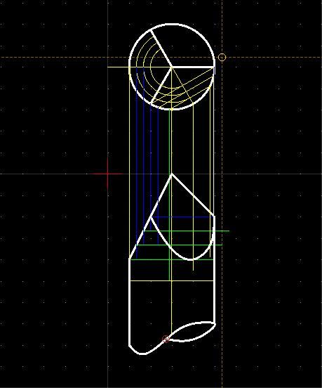

                                    A new challenge for 2D Draughtsmen is to produce First or Third Angle drawings of the sharp end of this tin-tack:
                                    Dimensions: tack is 10mm in diameter and 30mm long. The tip has 3-facets at 60°.
                                    The hard part of this one is correctly developing the curves where the flat facets meet the round body of the nail.
                                    I think it's an example of an object easier to make in the real world than it is to model in 3D, and considerably quicker to model in 3D than it is to formally draw in 2D. Hardest of all on a drawing board rather than CAD because of the multitude of construction lines that have to be erased to finish the drawing neatly.
                                    Trainee Draughtsmen were set many exercises like this and took years to become fully proficient. Old time engineering required immense skills and patience, it makes their work even more impressive.

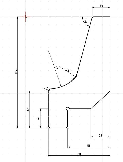

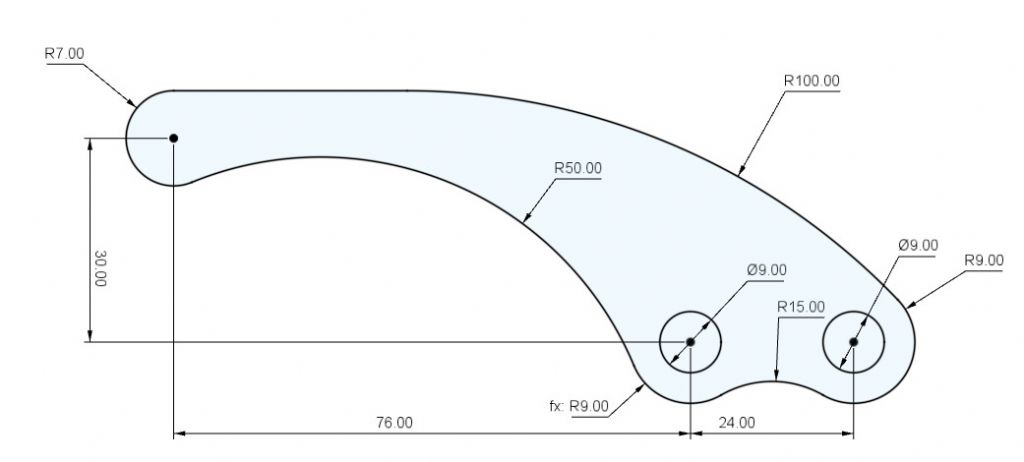

                                        Here's another challenge for you. All transitions are tangents, and the top line is horizontal.

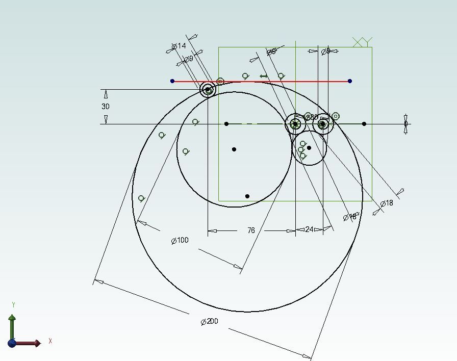

                                            Garry, don't you have anything more taxing as that one is quite easy. Just establish the 3 points draw some concentric circles then a few larger circles and a straight line before going to work with the tangent icon. then just trim away the excess.
                                            The only unknown are the two 9mm circles which being shaded may be a recess or projection the extent of either being unknown.
                                            #486925

                                              Gary Wooding
                                                @garywooding25363
                                                Posted by JasonB on 21/07/2020 13:37:38:
                                                Sorry, no.
                                                CAD simplifies things like this, but it's rather challenging with a manual drawing board.
                                                #486949
                                                  With construction lines, done in different colours to highlight the intersections.
                                                  CAD makes it easy to draw the curve along the construction, but I don't see any way QCAD might automate working out the intersections.
                                                  Gary's July challenge is easy in QCAD because the software does tangents at the click of a button, whoo hoo. Much harder with a Drawing Board I think.
                                                  #486957
                                                  duncan webster 1
                                                    @duncanwebster1
                                                    Posted by Gary Wooding on 21/07/2020 16:14:27:
                                                    Sorry, no.
                                                    Why? you know the distance from the centres of the smaller circles to the bigger ones, so just strike arcs and draw circles tangential. (I'm so old I have used a spring bow pen and Indian ink to draw on linen sheets. Only to modify old drawings to be sure)
                                                    I wouldn't have done it like Jason, just draw the 3 smaller circles and the horizontal line and use the fillet tool
                                                    #486960
                                                      Posted by SillyOldDuffer on 21/07/2020 16:34:34:
                                                      No really, just a case of swinging a few arcs
                                                      Fillet won't do it in alibre as you can't select two complete circles
                                                      Edited By JasonB on 21/07/2020 17:12:46
