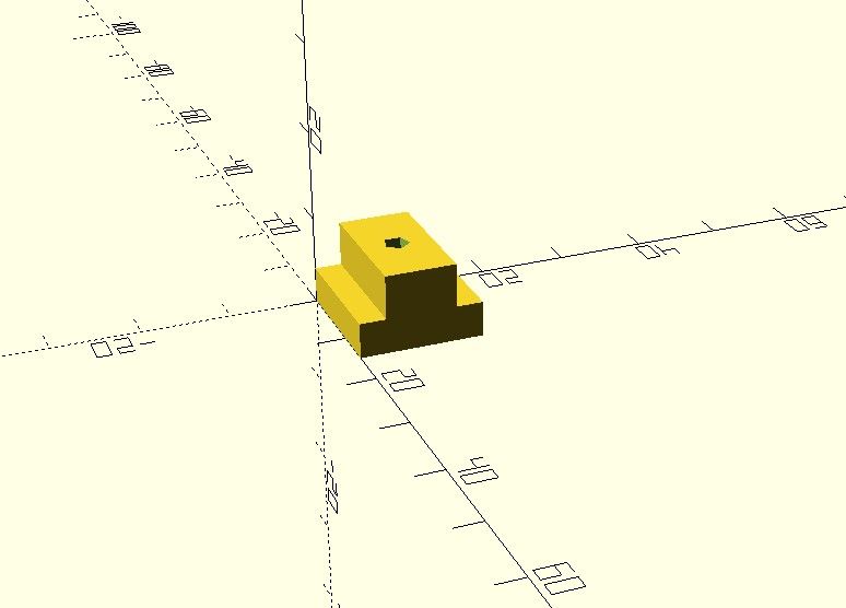

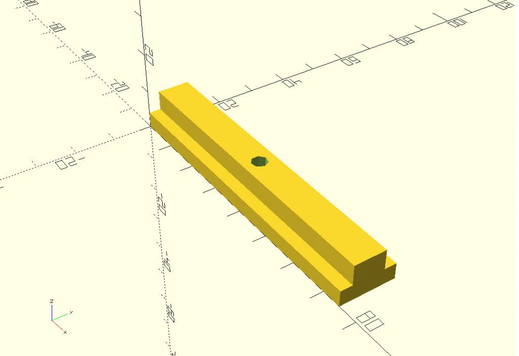

        It's a rainy day outside (at least that's my excuse) so I've been amusing myself with Open SCAD.
        There was a post recently about 3D printed T-Slot fillers. A nice simple thing to draw in 3D CAD (just sketch & extrude he says with new found confidence) but I thought I'd do it in SCAD (a much better use of coffee-time than Suduko!  )
        Here is the script:
        // T-Slot Filler – IanT
        L = 75; // T-Slot Length
        HR = 2; // Hole Radius
        BW = 14; // Bottom (of Slot) Width
        TW = 8; // Top (of Slot) Width
        BH = 4; // Bottom (of Slot) Height
        TH = 9; // Top (of Slot) Height
        difference () {
        union () {
        cube ([L,BW,BH], center=false);
        translate ([0,(BW/2-TW/2),0])
        cube ([L,TW,TH]); }
        translate ([L/2,BW/2,0])
        cylinder (TH,HR,HR);
        I've used arbitrary dimensions above, so just change the variables to what you need. I've not printed this myself (I think it might actually be quicker to just cut some wooden strips and glue them together?) but it should be fine.
        You'll need to download Open SCAD and then just cut and paste the 'script' above into the Editor. For anyone not wanting to go "full-on" 3D CAD – Open SCAD can be learned in small steps and is pretty simple once you've got a few basics (it looks more complicated than it is) – and it also helps keep the little grey cells ticking over.
        Regards,
        IanT
        Edited By IanT on 02/07/2020 17:18:16
        #483548
        IanT
          @iant
          It also occurred to me that a printed T-Nut might be useful for holding things in place (where no or low loads were involved) – such as DTI mounts etc…
          I just changed the length to 15mm and hole radius to 1.5mm (but would use tapping size in practice)
          Regards,
          IanT

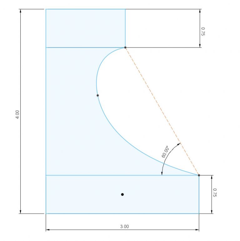

                          #483666

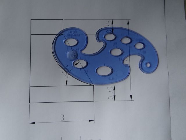

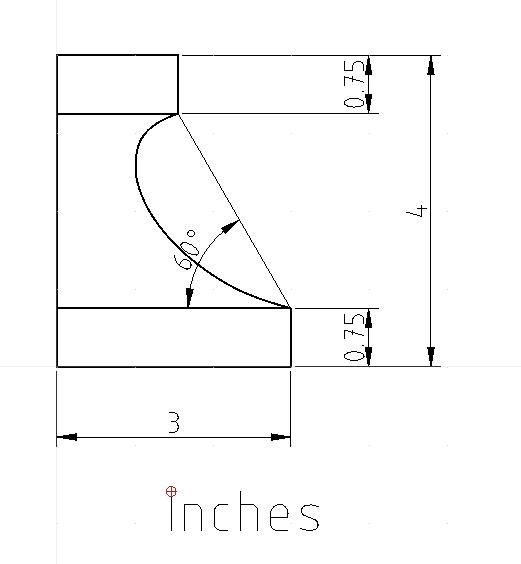

                            While I ponder Michael's problem and worry from his video if Thales is pronounced Thay Lees or Talez, here's another hard one. Well I think it's hard!
                            Replicate the curve of this moulding by whatever method. Clue – it's generated from a 1.5" radius semicircle, but the semi-circle's origin isn't on the 60° line. Whilst a CAD package can draw the spline curve given relatively few points to follow, producing a 'fair curve' manually needs several.
                            Nigel complained about hard-to-make drawings and this might be a good example! But shapes like this are common in the real-world. Streamlining and decorative work demand tricky curves, and made cheaply too! My stair bannister is an example, and dining room coving is another. No sympathy for the poor old tool-maker – the curve has to look right!
                            #483667

                                  Posted by SillyOldDuffer on 03/07/2020 12:23:07:
                                  With CAD the curve is best done as a simple bezier with a control point at each end. Trivially simple.
                                  Manually just as easy using French curves, the hard bit being finding mine if they turn out not to be where I put them years ago…

                                    #483676
                                    duncan webster 1
                                      @duncanwebster1
                                      SODs latest:
                                      assuming we are to use 2 arcs, unless both radii are specified there are an infinite number of solutions
                                      #483681
                                      blowlamp
                                        @blowlamp
                                        My best guess for the centre location of the 1.5" rad arc is at about 2.5" to the right & 1.5" down from the top/left corner. I'm suspecting a 0.625" rad arc at the top and a 3.125" rad arc at the bottom to join all three together tangentially.
                                        Martin.
                                        #483685
                                        Gary Wooding
                                          @garywooding25363

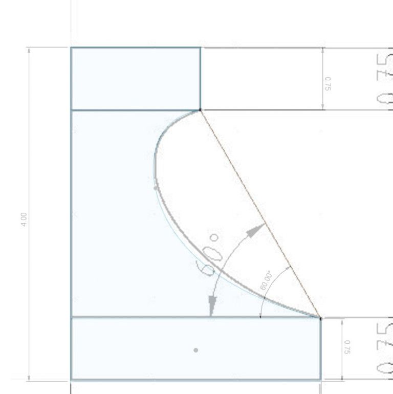

                                          How about this?
                                          #483688
                                          Gary Wooding
                                            @garywooding25363

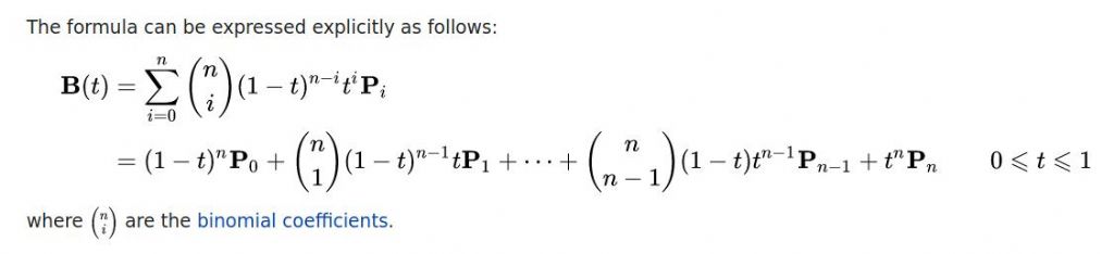

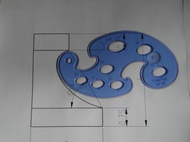

                                              CAD may make drawing Bezier curves easy thank goodness, but are they trivially simple?
                                              Doing this manually, I'd use a French curve at different angles to fair the curve, but it would be lucky to find an exact match. One of mine comes close, but not at both ends:
                                              And someone designed that French curve on a drawing board in the first place! How was it done?
                                              Re Duncan's comment, I'm afraid the curve isn't drawn with arcs. (Maybe it could be?)
                                              Once the approach is explained, easy enough to do manually, with Qcad, or with any other competent 2D CAD package. Not sure about FreeCAD & Fusion360's sketch tools for this particular job. They might not have the 2D primitives needed to construct the curve. (I haven't checked.) They can both do spline curves, but in this example it might be easier to construct the outline in 2D CAD and import the answer rather than sketch it.
                                              #483692

                                                Posted by SillyOldDuffer on 03/07/2020 13:55:13:
                                                My effort was done with Fusion sketch. What's wrong with it?
                                                #483693
                                                  Posted by Gary Wooding on 03/07/2020 13:45:41:
                                                  How about this?
                                                  Pretty close, your curve goes slightly deeper than mine:
                                                  I'm not complaining!   Fusion did better than I thought it would!
                                                  Edited By SillyOldDuffer on 03/07/2020 14:16:39
                                                  #483694
                                                    Not sure … but I think it is literally a spline curve, so created with a suitably springy flexible strip and some pins.
                                                    #483699
                                                    Martin Connelly
                                                      @martinconnelly55370
                                                      To me it looks like the curve produced by rotating a circle 45 degrees in two planes. At 1.5 radius this would produce an oval 3 high 2.12 wide. Rotate this 45 degrees anticlockwise to produce the example given.
                                                      Martin C
