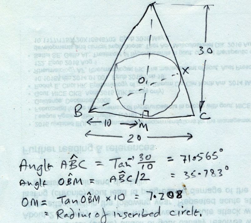

              Gary Wooding
                @garywooding25363
                No CAD, no compass, no ruler, just pencil and trig.
                Do I get double points?

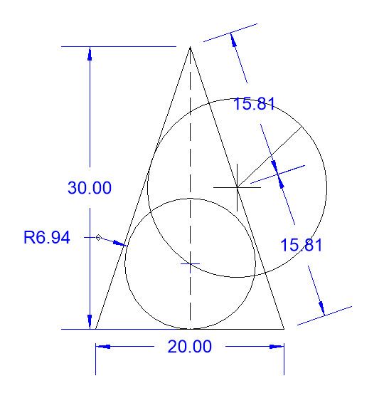

                    The triangle problem is simple, learnt that in maths at school. Bisect one of the base angles and project the line to the centre line. Estimate by eye gives 7, trig gives 7.2 if I remember yesterday's result correctly.
                    Martin C
                    #483468
                      Bisect two angles of the triangle, three arcs per vertex.
                      Centre the triangle where the bisecting lines cross.
                      Draw a circle tangential to the sides of the triangle.
                      Blimey must be remembering that from school.
                      Edit: (Works with all triangles and strictly you only need to bisect two angles, thinking about it!)

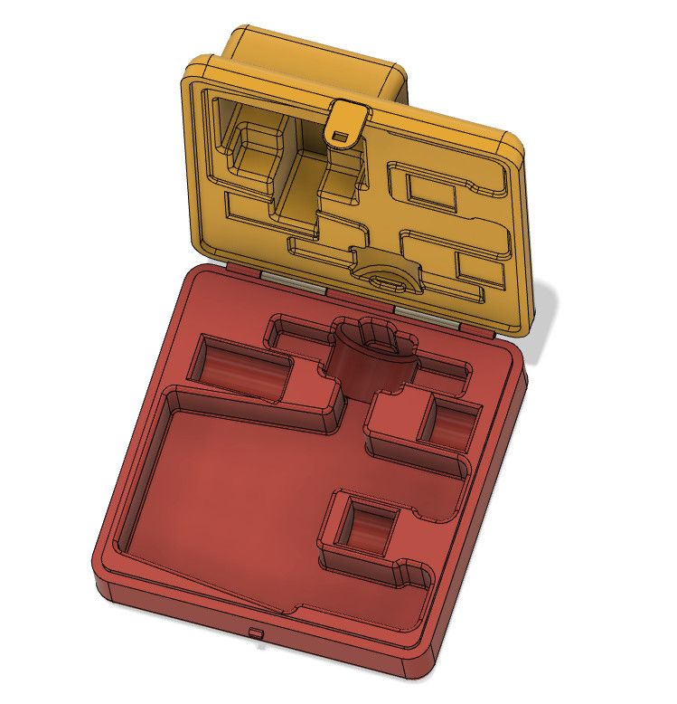

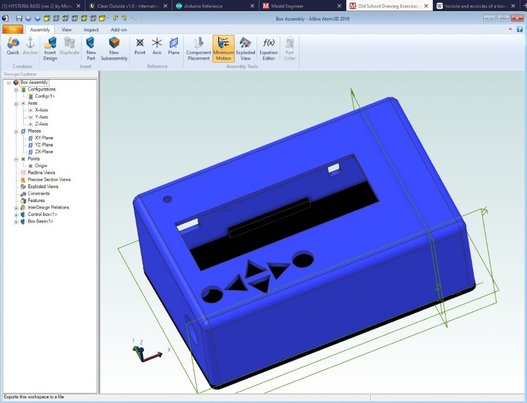

                              I think the values of 3D CAD is very much in it's flexibility to meet the different needs of different people.
                              It goes without saying that those of us who use CAM or 3D printing would be lost without 3D CAD.
                              The sector for my equatorial platform (below) has curves in two intersecting planes, as a result of the bottom surface being an inclined slice of a cone. Not only is it elliptical, but curved and tapered too. Tricky to draw in 2D but with significant advantages over the traditional circular (the load is borne vertically, not at 38 degrees to the horizontal) and elliptical (the load bearing point moves back an forth) designs. It also needs to be reasonably accurate to work well, although any errors are mitigated by the large radii ( about 383mm and 500mm).
                              Making it in wood or metal would require CNC or a very large jig. 3D printing, it's almost as easy as making any other shape (just some thought about support placement and orientation needed).
                              For me, then, 3D Cad opens doors that would otherwise be closed.
                              Another example is this control box. Aside from 3D printing it it would not be hard to draw it on paper in 2D, but I would have had to construct an isometric view to get a real feel for how it would look. When aesthetics as well as function are important, 3D CAD win hands down.
                              Incidentally, most of the making of this box was effectively working in 2D, but being able to create angled planes and project of existing surfaces greatly eases tasks like creating the close fitting tabs on the angled base.
                              I do use a very basic 2D CAD (a ~20-year-old version of Corel Draw) for some tasks, like setting out telescope optics. When I made a telescope with a Crayford focuser, although 2D (actually in TurboCAD) was useful for calculating the overall dimensions, I switched to 3D to get the proportions right before cutting metal. It this case my 3D 'model' wasn't very developed at all, but without it most of the work would have been 'cut and try'.
                              I think people often forget that 3D CAD and do anything 2D can do, with the advantage of instantly viewing results in 3D, if desired.
                              Many of the uses and advantages of 3D CAD I've found are not obvious and you tend to discover them through your projects, rather than being led by the capabilities of the CAD. The other thing is how you learn by doing. My designs are much more efficient now – for example I've learned to create one feature then mirror or pattern it rather than drawing them all individually. This means if there's a change you just edit the original, a huge timesaver.

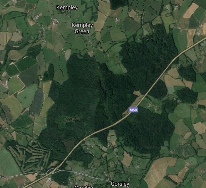

                                Posted by SillyOldDuffer on 02/07/2020 11:30:30:
                                In the history of railway building, it was common for lines to be routed cheaply at first because money was short. They put up with slow tight curves, gradients, weak bridges, and long diversions even though these hack profits down year on year. When money was available later inefficiencies were often eliminated by building cut-offs. A good way of getting rid of a reverse curve is to connect both sides with a direct tunnel or viaduct, but these have to pay for themselves by increasing the railways efficiency. No place for practical men in this type of engineering either – it's all about cost estimating. Practical men have the skills needed dig tunnels, but the hard part is making the railway pay.
                                Move onto to motorway and major road design and construction up to the 1970s and 80s… woodland had a lower cost per acre than farmland so planning could be a sort of ecological 'join the dots'.
                                Look at this example on the M50 where the planners managed to neatly align a couple of miles of the motorway just inside the woodland…

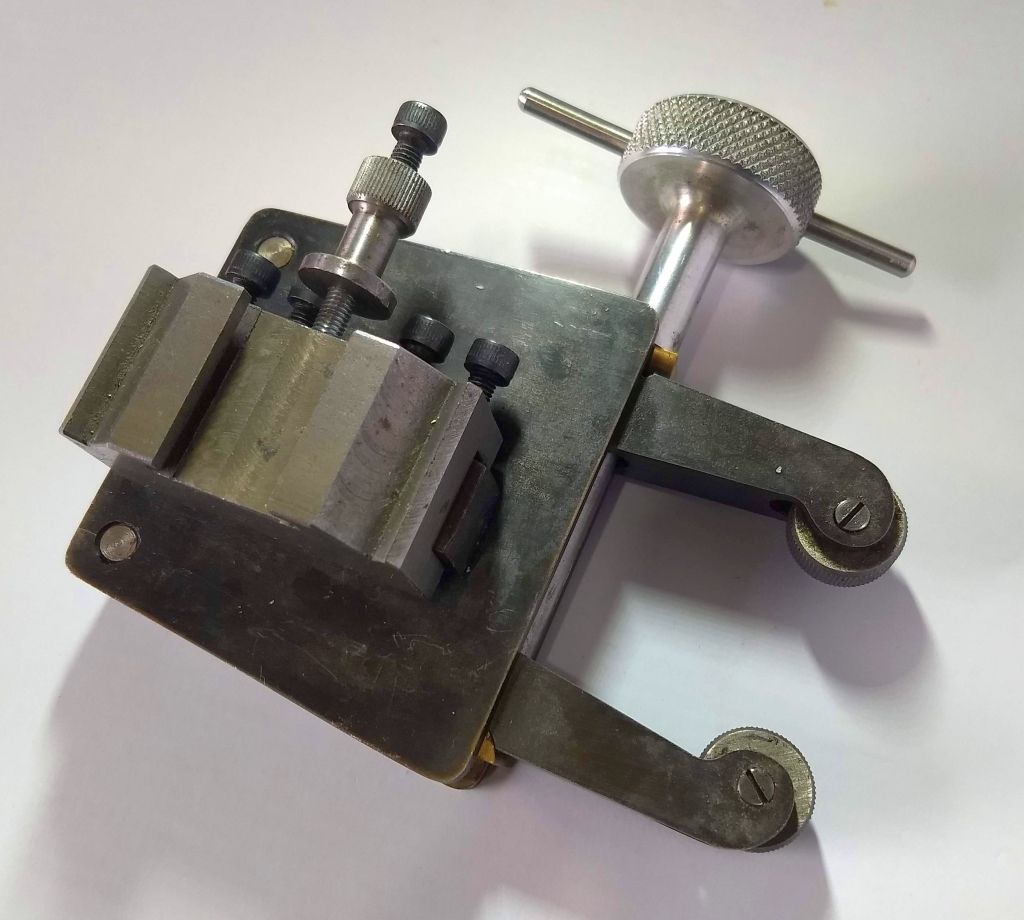

                                  Gary Wooding
                                    @garywooding25363
                                    I made this knurling tool some years ago and kept it in a cupboard together with 4 pairs of different knurls in a plastic bag. I often toyed with the idea of making a fitted box for it, but was put off by the awkward shapes. Eventually I bit the bullet, designed the 3D model in Fusion and am about to 3D print it.
                                    2D CAD would have been very difficult.

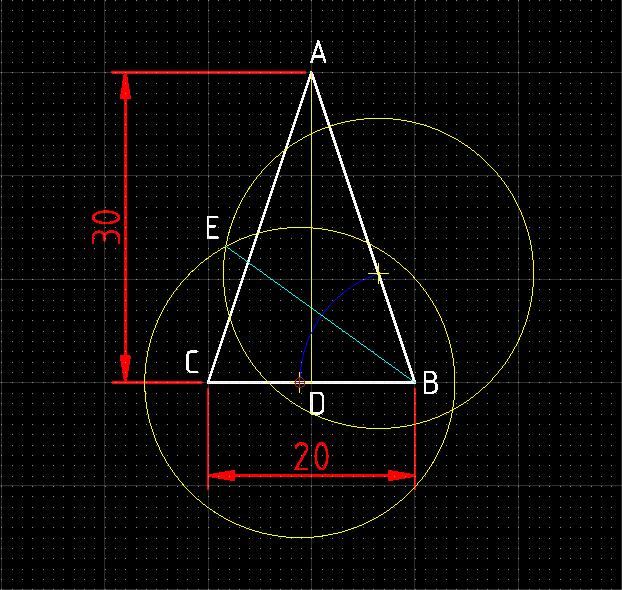

                                      Apologies for complicating the circle in a triangle question by allowing folk to assume they had to draw the triangle itself with only a compass! No, it's the radius of the circle I was after – 7.207592
                                      Gold star to Gary for solving it with trigonometry, but I have to mention he's used maths tools provided by someone else! Was it a calculator or a set of trig tables that delivered 71.565° ?
                                      Some lessons learned:
                                      1. The key to solving the problem is bisecting an angle, with luck this is remembered from school!
                                      2. Need to know how to bisect an angle with a compass, or
                                      3. Understanding a 2D CAD package will almost certainly have a tool for bisecting angles, in which case there's no need to remember points 1 & 2 above. CAD wins because it's quick and doesn't make mistakes, but the operator has to know which button to press! Beware of easy to use arty drawing software – it may not do techy stuff like this.
                                      Can the entire problem be done with just a compass? Someone did in the distant past. Imagine a flat damp sand beach, a few sticks, a home-made compass and a length of string. The corners of the triangle can be found with the compass and fixed with sticks. A straight line can be marked on the sand by pulling the string tight between two sticks and twanging it on to the ground. Builders use much the same trick with chalky string to this day. No need for a hinged pair of compasses either – the 'compass' can be two sticks with a length of string held taut between them.
                                      Here's bisecting done with a compass:
                                      Steps:
                                      1. Drop the vertical line AD
                                      2. Draw an arc from the corner ABC that crosses AD (in Blue on Diagram)
                                      3. Draw two circles from the each end of the blue arc where it meets AB and BC (Yellow on Diagram)
                                      4. Draw a line from B to the intersection of the yellow circles. (Light Blue on diagram) This line bisects the angle ABC, and where it crosses AD is the centre of the biggest circle that will fit inside the triangle.
                                      Comment – problem looks easy, but has hidden depths! More to technical drawing than CAD buttons or pencil and paper, but CAD hides a lot of underlying complexity.
                                      Edited By SillyOldDuffer on 02/07/2020 12:33:57

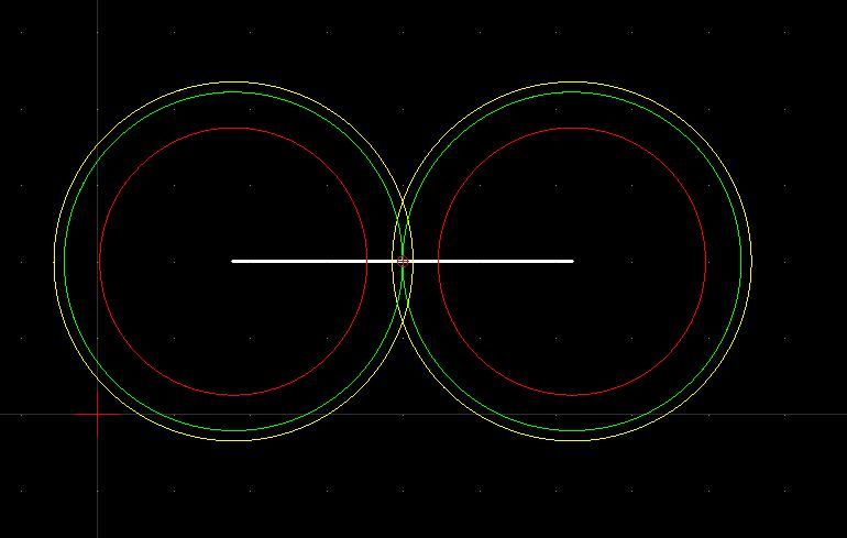

                                          Gary Wooding
                                            @garywooding25363
                                            Sorry Barrie,
                                            I don't see how that works.
                                            I tried it in CAD and the final circle, whilst tangent to the base, doesn't touch the other two sides.

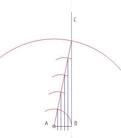

                                              Yeah, sorry about that! My bad entirely – I'm in the dog-house again!
                                              Going back to first principles again, a compass can determine linear distance by using it as a divider or a doubler. Quite easy to halve a line by setting a compass until the intersections it draws match exactly, and dividing can be repeated until the human eye can't cope.
                                              The two red circles are obviously too small, and the two yellow circles equally obviously overlap. The two green circles are either spot on or pretty close.
                                              Good eyesight can divide an inch down to 1/128ths, and dividing from another line at an angle to the target amplifies results allowing even finer graduations. Most struggle to read a 1/64" scale in practice. These days 1/32" is as good as this poor old duffer can do without a magnifying glass.
                                              Dividing scales by factors of two is useful, but decimal scales are even better. Another drawing challenge is how to divide by 5 with a compass to make a decimal scale, and then a vernier? At this rate, engraving micrometers tomorrow!

                                                That seems a bit complicated to me SoD.
                                                I'd just draw two circles the same (but overlapping) size and then draw a line between their intersection points. That would give me the exact mid-point I'm sure.

                                                    SOD's divide by 5 problem:
                                                    Draw a horizontal line AB 1 unit long. Erect a perpendicular from the right hand B.
                                                    Draw another line 5 units long by repeatedly stepping your compass. The set the compass to the length of this new line (5 units). Stick the point into A and swing an arc crossing the perpendicular through B at point C.
                                                    Then reset your compass to AB ( 1 unit) and mark off the diagonal line into 5 sections. Drop a perpendicular from each of these new points to AB and you've done it.
                                                    All sounds a bit long winded, but it can be a useful way of making an odd scale ruler.

                                                      Posted by IanT on 02/07/2020 14:46:02:
                                                      IanT
                                                      You're right Ian, easier to do AND it would be more accurate! blush
                                                      Meanwhile, following Duncan's divide by 5 instructions:
                                                      You chaps are all too good at this…
