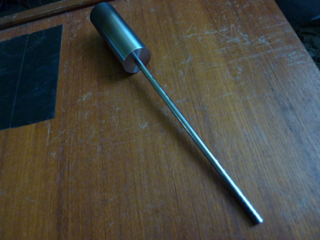

                        There are quite a few useful parts in old printers , when I junked my last one I got a couple of 6mm rods which were chromed and precision ground , I used one for the displacer rod on my rhombic drive hot air engine , it was solid so to reduce weight I drilled it through from both ends to give 0.5 mm wall thickness , it drilled very easily so must have been a freecutting steel and stayed dead straight so has worked out perfectly for this engine.
