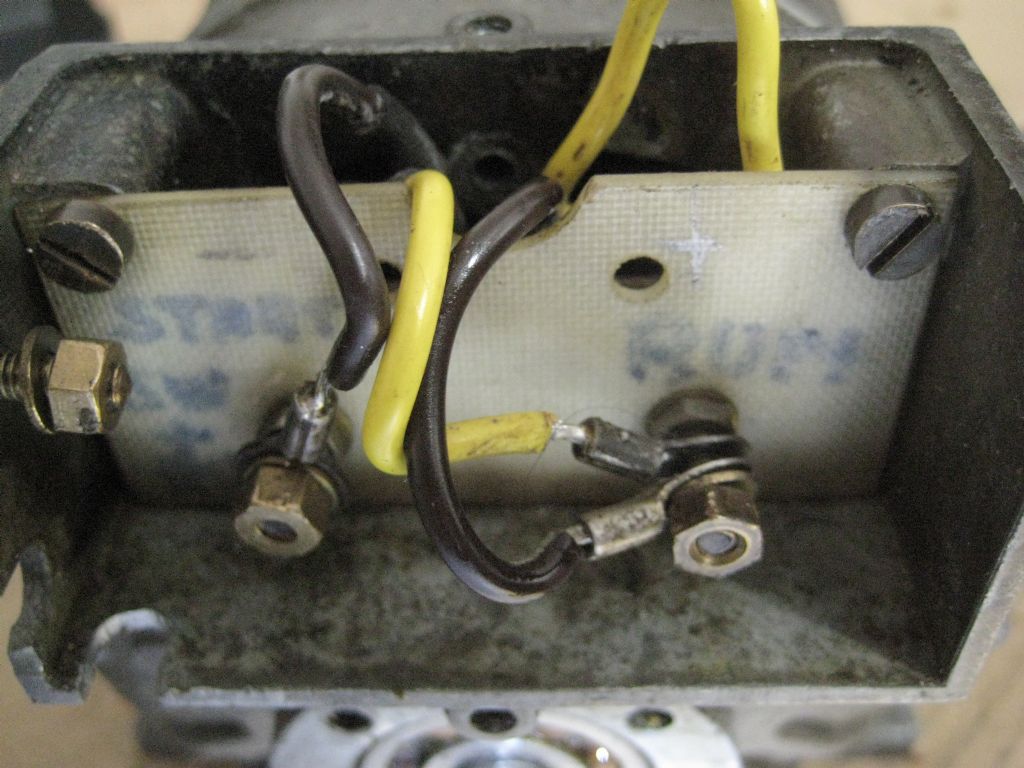

      That looks like a resistance split phase motor. Instead of the capacitor providing starting torque, the start winding is wound of much thinner wire. The altered reactance/resistance ratio (called ‘Q” factor) causes the phase shift for starting.
      Isolate the motor wire pairs and measure resistance and check operation of the centrifugal switch.

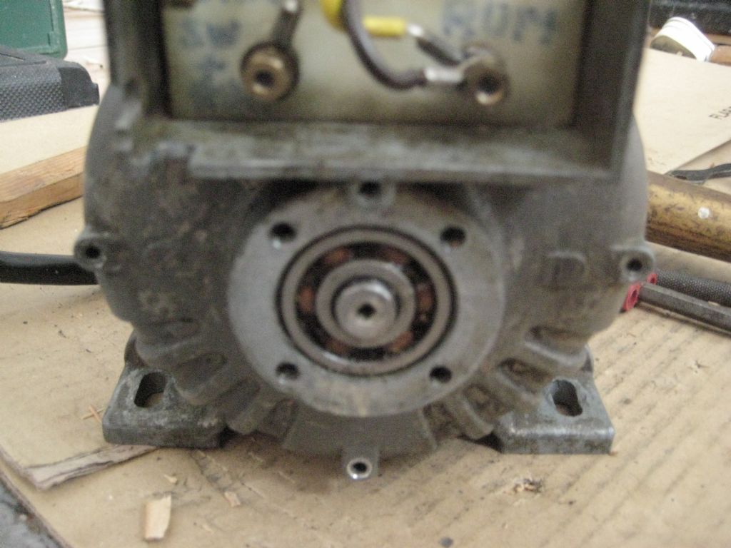

          #661905
          Victor francis
            @victorfrancis52958
            img_5524.jpgTry as I might, the motor won't split. Maybe the shaft is deformed.
            The starting and attempt to run is cyclical, the motor kicks in, fails to run and kicks in again. This happens every 5 seconds or so. It happened under load and with load removed. It basically does this as long as power is going through it on a continuous loop.
            After reading about the centrifugal switch I thought that might be the issue, but would the motor start at all if that was the problem.
            The connection "plate" is marked, start on the left wire and run on the two right ones.
            Not been able to get into the motor is frustrating, with the bolts removed there is nothing else which would hold the parts together.
            Looking at the protruding part of the spindle visible with the bearing cover removed, I can see some marring to its edge. Someone has obviously been there before and might have deformed it.
            #661906
            Victor francis
              @victorfrancis52958
              The strangest part of it all is the lack of any information about old Parvalux motors online. There must have been enough people taking these things apart.
              This happens more and more often with vintage turntables and tonearms, years ago there was a wealth of information online, now just a mass of commercial entities trying to flog something.
              Is there a way to split to motor apart which is eluding me?

                #661909
                Emgee
                  @emgee
                  Victor
                  I guess the Start and Run refer to winding ends so you should be getting the winding resistance if you measure between the end of each winding and the Neutral post with a multimeter.
                  If you don't have continuity on the Start point and N you will need to investigate further.

                  #661910
                  Victor francis
                    @victorfrancis52958
                    Posted by Phil Whitley on 28/09/2023 10:06:23:
                    there appears to be a centrifugal switch in your pic of the connection box, you need to check the contacts are clean and the switch is operating cdorrectly, it sounds from your description that the motor is trying to start, but the contacts, which are closed when the motor is stopped, are not making contact properly and are not allowing sufficient current to flow to the start winding. , Can you see and clean the contacts (with an emory nail board) without stripping the motor? If not you need to remove the rear cover from the motor, not the shaft end. are there three screws in the centre of the rear cover, near where the shaft would be? these are bearing retainers and need to be removed before the end cap will come off!
                    Phil
                    Phil, you are right, that is the centrifugal switch. Unfortunately the only visible part is its top. No contacts are visible.
                    #661914
                    Victor francis
                      @victorfrancis52958
                      I am useless with a multi-meter but have a cheap one here. Not sure whether this means anything, there is continuity between the yellow run wire and the post where the brown start wire attaches with brown wire removed.
                      There is no continuity between the brown run wire and the start post, but there seem to be continuity between the brown run wire and the brown start wire. The continuity is intermittent and wiggling the brown run wire seems to affect it.
                      Still trying to split the b…. thing apart.
                      #661921
                      Macolm
                        @macolm
                        It can be easy enough to bypass a centrifugal start switch. Assuming the terminals are accessible, it needs a momentary push to make mains capable switch connected across the start contacts. While the motor is powered and trying to start, press the switch for a couple of seconds. If it gets up to speed, it is bad contacts. If not, it is something else. Make sure to release promptly in either case.
                        I used to have an E Lutz (before ELU) sander with an induction motor, and a double toggle switch. One side was power to the run winding, the other was sping biased to off for the start winding. Simply press both to on, then release, leaving the motor running.
                        #661923
                        Victor francis
                          @victorfrancis52958
                          The brown start wire, which showed intermittent continuity with the brown run wire, has come undone where it was spliced. I removed the heatshrink and it just came off. Maybe it was me messing around with it or maybe it just happened due to vibration and crap soldering.
                          Might have been the reason for the attempted starts, maybe it was not receiving constant power and kept going back to the start phase.
                          Biggest problem is that the wire is too short to allow for it to be spliced on again without taking the motor apart.

                            #661926
                              Hate to recommend anything without seeing the motor, but my guess is the housing and shaft are held firmly together by the bearing: These are often a tough press-fit onto both shaft and housing.
                              I'd make or perhaps buy something like a harmonic balance puller, the example below being about £15 from Machine Mart:
                              The bolts go through the spider into the 4 holes in the motor case near the bearing. Then the black bolt is tightened against the end of the shaft. Tightening puts an enormous pull on the housing and it and/or the bearing should shift.
                              I take no responsibility if the motor breaks! As this is tough love the bearing may have to be replaced. A press or large dead-blow hammer may be needed to refit it.
                              Might be cheaper and easier just to replace the motor. Symptoms suggest the centrifugal switch is malfunctioning, which could be anything between an easy fix or a hopeless search for an unobtainium spare part/ At minimum I'd assume it will cost new bearings.
                              #661927
                              Victor francis
                                @victorfrancis52958
                                Dave, thank you.
                                I did think the bearings were holding everything together and planned a visit to a local mechanic for a puller.
                                The issue now seems to be the two run wires, looks like they have come apart where spiced together. It's either happened due to me messing around with the casing or that was the original issue causing an intermittent contact.
                                The bearings are probably pressed on hard to begin with and got tighter when the last owner attempted to hammer the spindle deforming it in the process.
                                When I first bought the lathe I intended replacing the motor's bearings, I gave up when I realized the interference fit was too tight for the tools I have.
