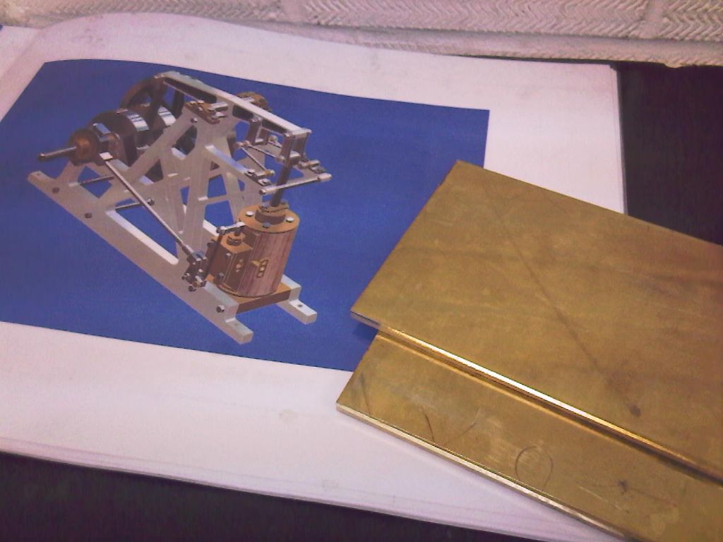

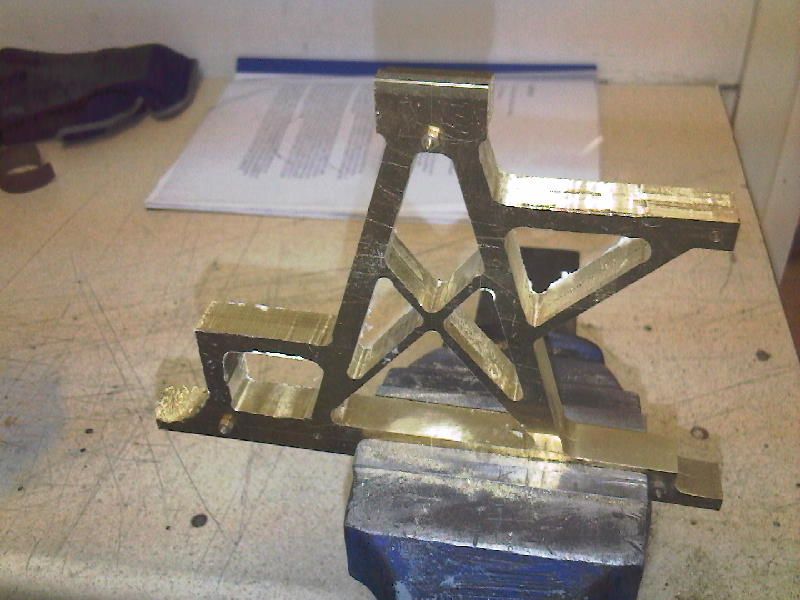

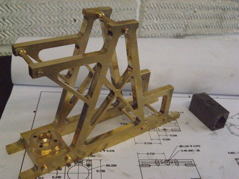

      Printed the plans off, including the missing pages. making this 1:1 scale as per the plans as I had some 1/4 brass plate just the right size.
      A bit of milling, sawing and filing………….
      Plans show tapped holes as 2-56 UNC ~ mine are 8BA. Cylinder in cast iron

          that’s looking good.
          as you can see from my avatar I made one only I used aluminium and made it 1and a half scale.  more pics in my album.

            Hi David, the brass frames look smashing. I made one with aluminium frames in 2x scale – my eyesight couldn’t cope with the tiny fixings. I also changed to metric fixings. I built mine as a sort of learning project to give me a focus for trying to learn all the various techniques needed. Seemed to work although my engine shows many of the mistakes I made along the way! Video of it running on youtube at http://www.youtube.com/watch?v=gRhHejzFmnA

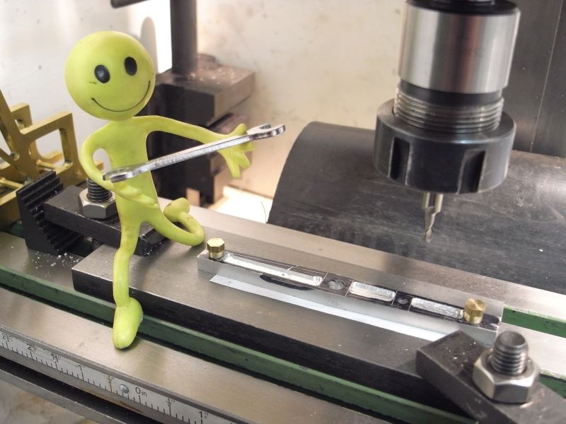

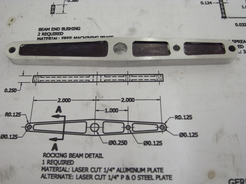

                  Got a little friend to help me keep motivated, seems along time since doing any of the “OldBoatGuy” beam
                  Just one little mistake in the second cut out “bling” ~ oh well hopefully it will blend in with a little riffle file

                    I must admit, the beam looks a lot better with the recesses in it. I might take mine to bits one day and have a go.
