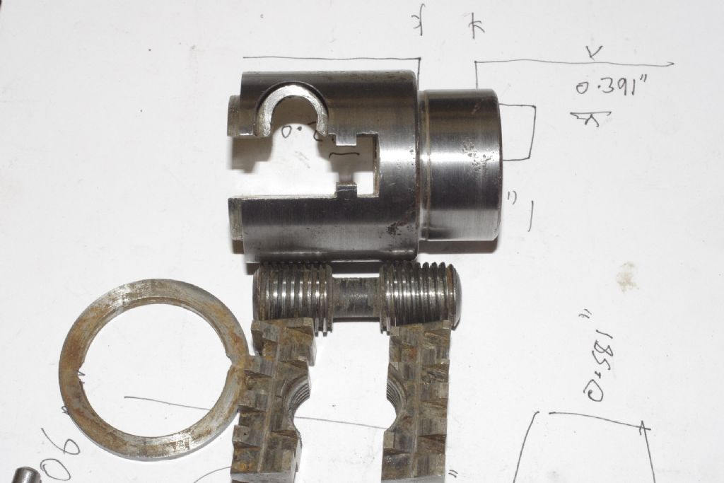

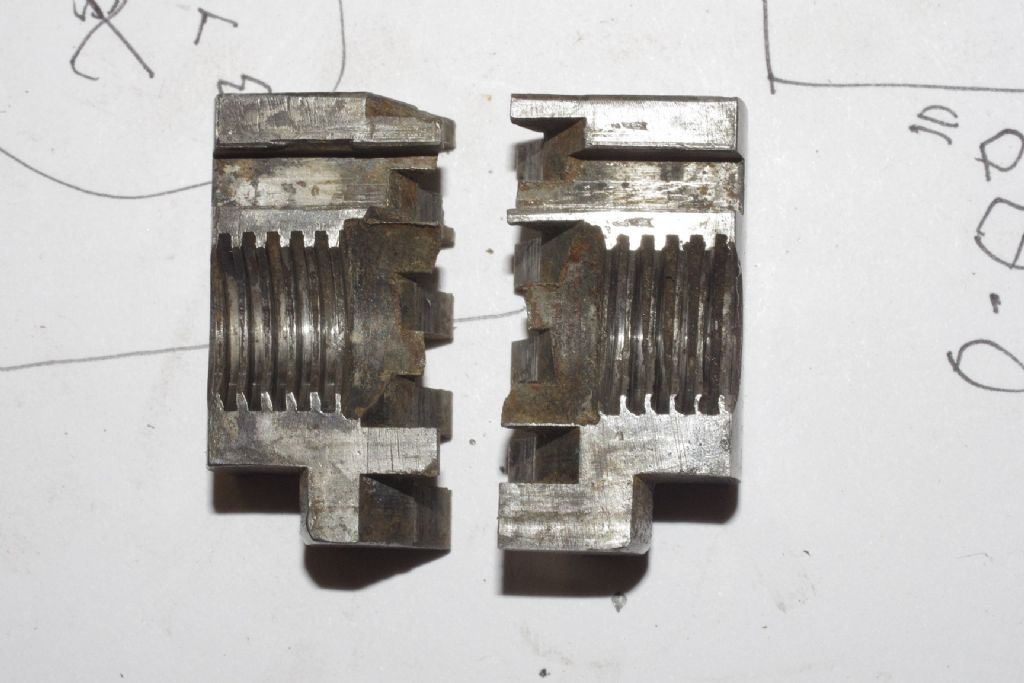

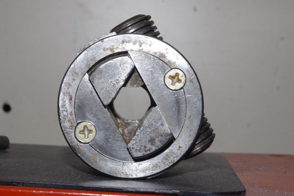

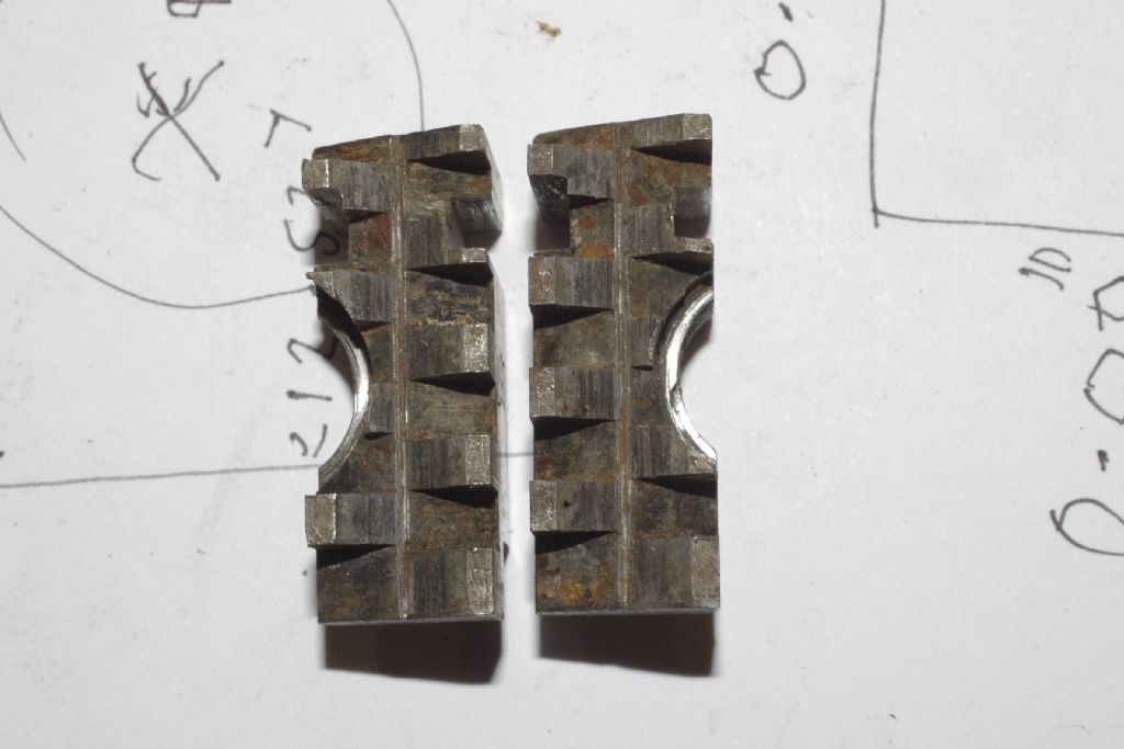

      _igp2835.jpg_igp2830.jpg_igp2829.jpg_igp2827.jpgOne of the unusual items left to the museum with other tools is this little 1/2" two jaw chuck. It was on a MT1 arbor which I removed to find out which Jacobs taper it had. It looks like it is intended to hold round stock up to 1/2". I took it to bits and cleaned it up a bit to find out whether it is worth getting a J33 x MT2 arbor for it. I fitted it onto a 12mm ground steel bar running 0.0005" tir and it runs about 0.004" tir on the body (the original MT1 arbor may be bent). I initially thought it was for holding taps, but the jaws make more of a hexagon shape.
      I have some pictures, but have forgotton to add them to my album before posting this thread.

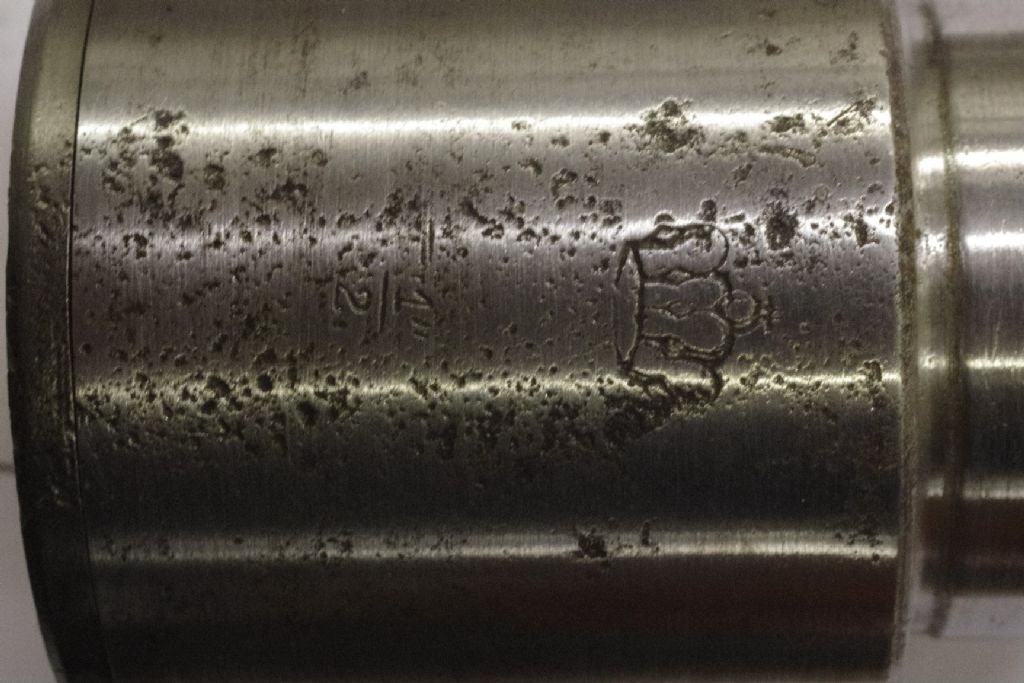

          An old boring head with a similar symbol popped up in my ebay feed a few hours ago 'Crown' brand
          Crown Boring Head Ebay
          #567107
          old mart
            @oldmart
            I have a 100mm 4 jaw independent chuck in a cupboard at the museum, marked Crown, and foreign. You reminded me that this 1/2" chuck has foreign marked next to the MT arbor. The screws are 8-32, replacing the original slotted ones which had seen better days, I had expected 4mm, or 3BA, but the 32 tpi gauge was the best fit and they screw in nicely. The design would work with hexagonal bar stock, but 1/2AF would be too big on the corners.

                          An update on fitting a MT2 arbor with a JT33 end. I bought one from Myford LTD, a good price and fast delivery. It was a failure. I had runout of about 0.020" tir. After removing the arbor, there were witness marks at the large end of the taper and I could feel the mismatch. That meant that JT33 had too steep an angle. After some investigation, the only candidate left would be the B16 which is based on the MT2 angle, and has a large end of 0.6195"
                          The JT33 angle per side is 1.80422 degrees.
                          The B16 angle per side is 1.43055 degrees.
