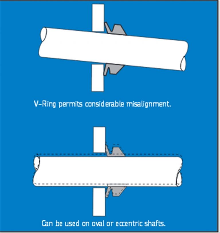

                                  The normal rotary shaft seals do not allow for much side-ways movement. It may be better to use a Vee ring seal. They are inexpensive and easy to fit and available from most bearing suppliers. No special machining required. Just press over the shaft.
                                  Paul.

                                    Paul- thanks for that, V ring. I've been searching and could not remember what they are called. Used a lot in the past on agricultural stuff, keep dirt out, also at speed will "fling" out so less friction on the face.
