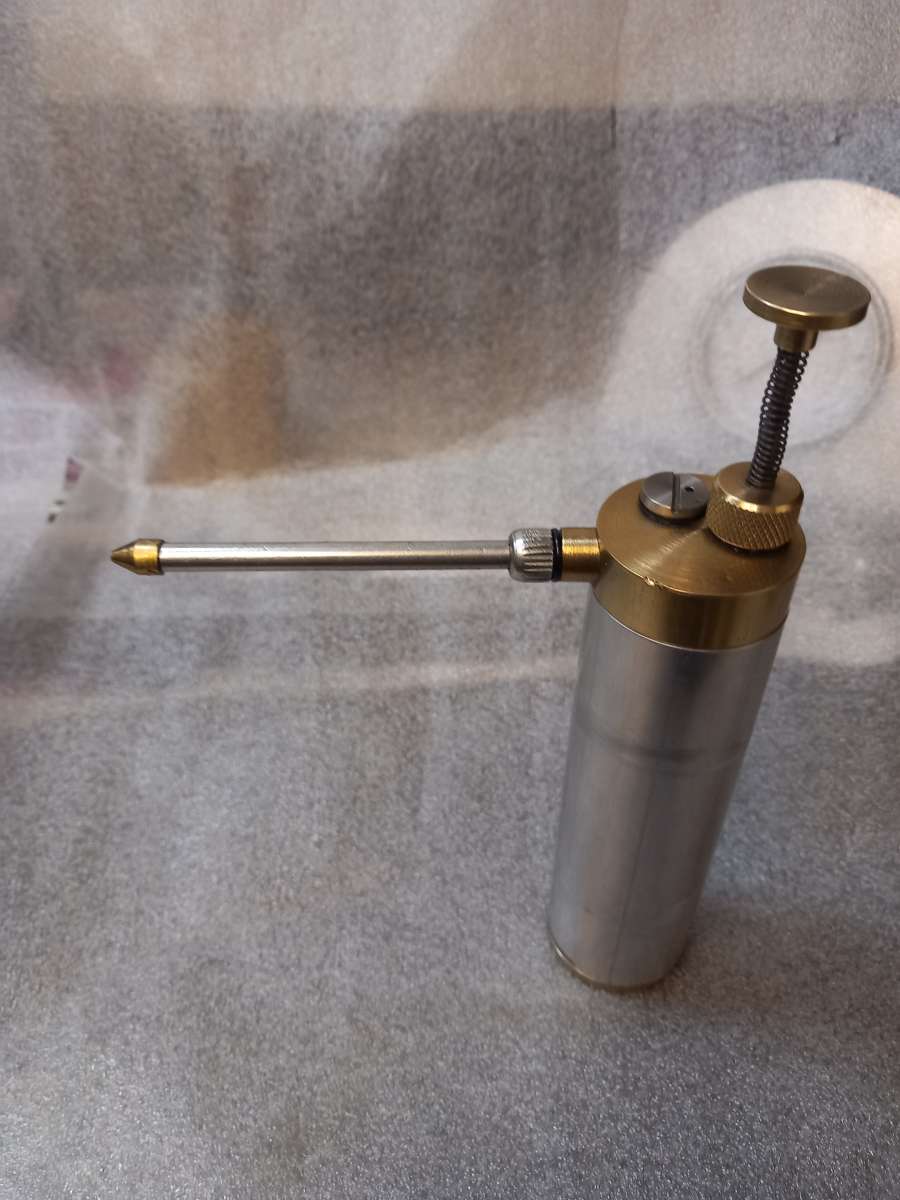

      I have bought 4 different types of new oil cans recently all of which leak when just sitting there on the shelf, any recommendations for one that does its job with leaking on its own ?

          I had the same issue and ended up making my own. O rings used to seal the top and bottom, the piston has a drain hole above it so any leakage past it drains back into reservoir. No more leaks, even when I use it to pressure lube.

          David Deaville
            @daviddeaville66164
            That looks good, I can’t believe you just can’t buy one though that doesn’t leak !
