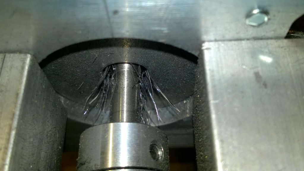

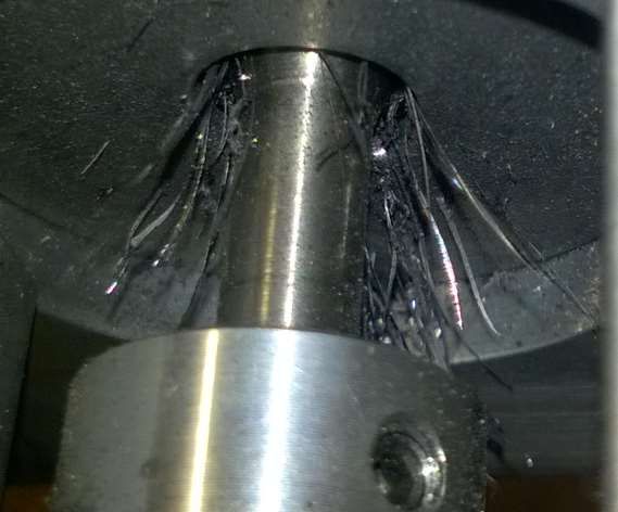

      recently I've been ignoring my poor CNC conversion and using the handles as I was working on some stuff that needed fiddling with rather than know accuracy.
      Yesterday, I got the PC out and prepared to make some accurate holes. First, of course, a dry run!
      This was not a success. With lots of grunting and growling, the beds moved erratically.
      My first thought was that I'd tightened up the jibs a bit much and that I would have to do this bit by hand.
      BUT. When I came to turn by hand I got some horrid grunting and grinding and the handles moved erratically! This did not seem like good news.
      When I had a closer look, here is what I found.
      X Motor
      X Motor rear
      Y motor close up

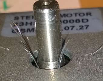

      This did not seem good.
      However, I've taken the motors off and inside and pulled off the splinters (generated by cleaning up the end of a 20mm square steel bar with a carbide rod) and the motors still turn (by hand) judderingly (though perhaps less so0).
      Before I try and open the motors, I thought I 'd seek advice. 'Whatever you do, don't open the motors….' most likely!
      The other thing is to understand what's happened here and how I can prevent it.
      The CNC bit has run nicely for a while, then a few weeks hand turning and now, graunch .
      Iain

          Putting the motor in an enclosure, with a shaft seal in the box-wall, might be a good move.

                  The splinters are mildly magnetic – they are attracted to my pnicers more than the motors. However it could be that the motors grabbed them when they started running with fields being generated.
                  I would not have expected a stepper motor to have such poor shields that swarf could get in. Perhaps I'm wrong on this.
                  I'm aware of the cogging as each pole is passed when turning by hand. This is different. There is a distinct catch at certain points in the rotation. I've only played with my X motor so far. The catch location seems to move around a little bit so it does sound like some muck inside.

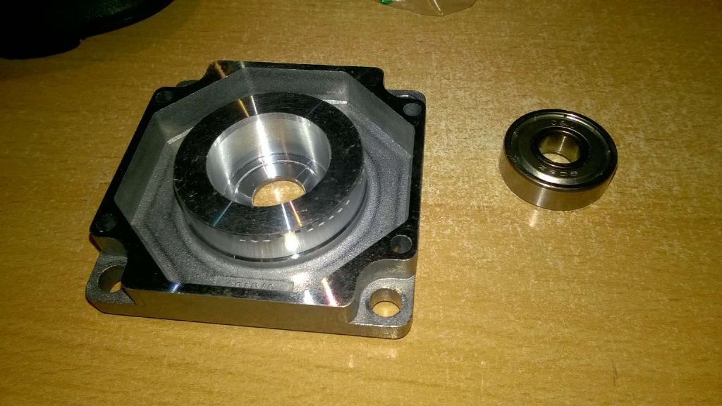

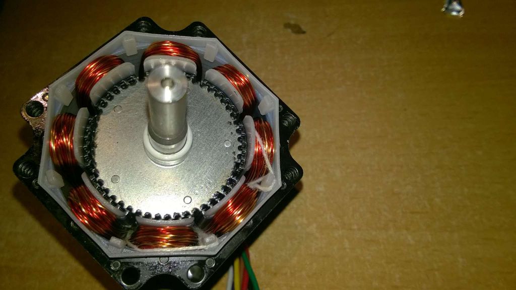

                        So I've taken it apart, cleaned the turny but and put it back together. It's still not right. What's baffling is that it's erratic. it will turn smoothly in one direction for while (clockwise). It does NOT like turning counter clockwise and once it's done so it can 'catch' turning the other way. When I had it apart, the bearings seemed to turn OK by hand, but perhaps that's because there was no load on them? May be I need to put some load on?
                        I did find some swarf inside, but in hindsight, I'm not sure my work area was clean (I've gone inside to my computer desk, but of course I took the outside swarf off here so it could be a bit dirty).
                        So as to get something out of this mess, here are some nude photos of a stepper motor…
                        The topless motor
                        The top bearing
                        The turny bit is magnetic and hard to get out of the ferrite case. I improvised a press out of a piece of 1/4 in brass rod.

                        and the innards
                        I think the next step would be to either try the bearing rotation under load or to just replace them. To be honest, there's not much else in there.

                            If you do replace the bearings [a wise move, I think], it's probably worth getting '2RS' equivalents.

                              I've just realised that the bearings are the same size as the 'skateboard' bearings I used to upgrade the X and Y leadscrew action in my mill!
                              Excitedly I swapped out the front bearing…. No apparent change. I should do both really, but not tonight…

                                Still looks to be turnings in the gap on the rotor. These things are a bitch to clean out and when put back they work but you will have lost some power
                                If we strip them we press the rotor out into a clean, close fitting steel tube to act as a keeper.
                                As regards getting crap in there in the first place, buy an oil seal same ID as the shaft, fit it to a thick alloy ring and araldite onto the end cover. Very rare we do this though as when we fit steppers to converted machines the front shaft is always inside a solid machined block and the rear is covered by a 3D printed cover off thing inverse. Never fit hand wheels, use a pendant or keyboard MDI commands.

                                    I stripped out the first motor again and attempted more cleaning. I think I'd done a pretty good job the first time, but I also went heavy handed on the blu tack (white tack, actually, but tack is tack!).
                                    I replace both bearings (including the one I'd put in yesterday and re-assembled. Spins smooth as you might hope! Well, there is the 'cogging' every 1.8 degrees, but that's to be expected.
                                    Next the other motor which went smoothly and now also turns nicely. I've ordered some oil seals from Lancashire Seals which I will glue on before re-assembling.
                                    What I'm seeing as the cause is not the splinters from the steel I referenced initially, but more the dust from the cast iron slitting and milling. I think that that was on and around the motor (gets everywhere!) and when the motor was actually turned on and thus the other shell magnetised strongly, the dust got pulled into the bearing, despite the metal shields. That fits with the erraticness of jerking as the bearings rode over and moved around the dust.
                                    Well, it's a theory anyway.

                                        Taking stepper motors apart WILL ruin them for sure, the core will loose a lot (but not all) of it's magnetic strength. Not a good idea, unless you know something the manufacturer does not.
