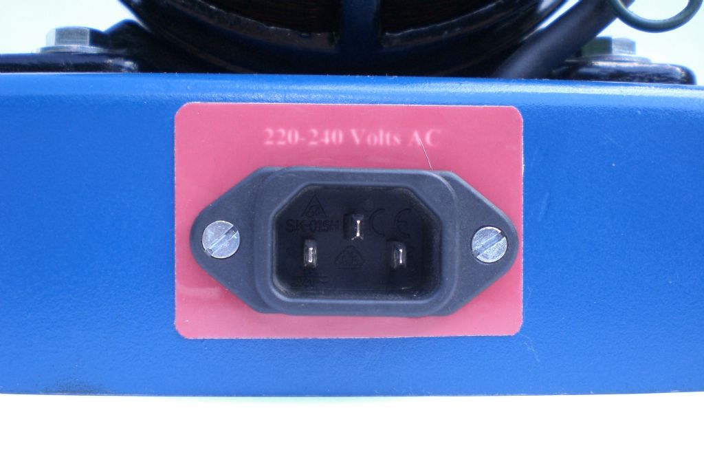

                    Nicholas Farr
                      @nicholasfarr14254
                      Hi, laminators are also useful for making home made information plates and the like, for your machines etc., like the one in the photo below.
                      This one was made with a credit card size pouch, and fixed with double sided tape.
                      Regards Nick.
