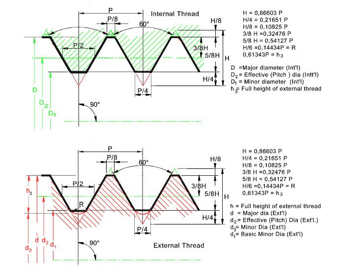

                          #517189
                          Alan Johnson 7
                            @alanjohnson7
                            ISO Metric Threads
                            In Machinery's Handbook. I was reading a couple of days ago that the crest of the male thread is rounded to an amount of H/8. H being the pitch.
                            I was making M10x1.00 male threads (in brass). I calculated, using H=1.00, that the outside diameter should be 10.00mm – 1.00/8 – 1.00/8. or 10.00mm – 0.125mm-0.125mm. Answer is 9.75mm. It worked!
                            Not having the Handbook with me right now, I cannot check, but M4 x 0.75 should yield 4.00 – 0.75/8 – 0.75/8, or 4.00 – 0.09375 – 0.09375. Answer 3.8125mm outside diameter.
                            Happy to admit that my memory is not so good, but the new diameter is 91.325% of 4.00mm, which seems to agree with previous posts.
                            #517193
                            Howard Lewis
                              @howardlewis46836
                              Chris,
                              I merely quoted what had been said a few days ago, on another thread on the Forum. However, your apparent disbelief prompted me to check.
                              Kempes Engineers Yearsbook, 1982, quotes the proportions for Metric threads as:
                              H (Depth of thread ) as 0.86603P where P = Pitch.
                              Truncation is quoted as H/8
                              If you use your calculator, you will find that 0.86603 / 8 = 0.1082537.
                              This, as long as you ignore the 4th and subsequent decimal places, matches the 0.108P quoted by Tubal Cain in his "Model Engineer's Handbook"
                              So the 10% quoted previously is probably close enough for most purposes.
                              If you can find any BS or ISO standard which changes these proportions, please feel free to tell us which they are.
                              Howard

                                #517199
                                Howard Lewis
                                  @howardlewis46836
                                  Alan typed whilst I was checking..Machinery's Handbook appears to quote the same proportions as Kempe's.
                                  So, a standard 4 x 0.7 thread would be truncated by 0.075 mm, (0.7 x 0.108 ) reducing the diameter by 0.1512, to give a dimension over the crests of 3.8488 mm, or 96.22%.
                                  So, your 3.7 mm threads are undersize compared to the generally accepted standard
                                  Howard

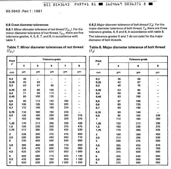

                                    #517241
                                    Clive Brown 1
                                      @clivebrown1
                                      My Machinery's Handbook tabulates BS upper and lower tolerance sizes for "medium fit" metric threads. For M4 on the major diameter these are 3.978mm and 3.838mm resp. ie 0.14mm spread.
                                      Effective diameter is also tabulated, having a closer spread of tolerance of 0.09mm. but on minor diameter the spread is again 0.14mm.
                                      Another table gives larger, "free fit" tolerances but sizes less than M5 aren't quoted. Perhaps "free fit" becomes "drop through" in the smaller sizes.

                                          #517278
                                          Martin Connelly
                                            @martinconnelly55370
                                            These are the relevant tables in the 1981 standard for metric threads.
                                            Martin C
