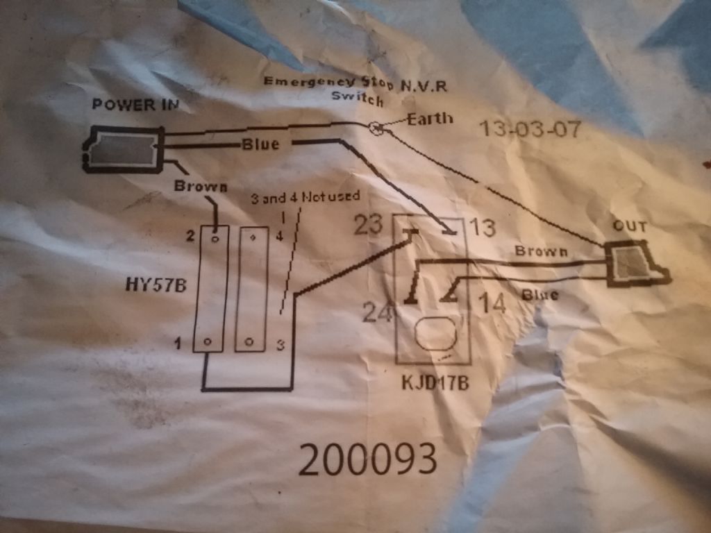

      I have just bought a new NVR switch.
      It has 6 terminals. One row is numbered 11. 21, 31.
      The other row is numbered 12, 22, 32.
      I would like to know what these numbers mean so I can wire it correctly.
      Just to save anybody asking, because somebody will – No it did not come with any instructions.
      Thank you for your help.

          A photo would be nice along with a model number….the numbers are meaningless unles accompanied by a sketch or drawing….
          But in essence, you need to determine which two connections are for the coil and the other four for the two poles of the switch….Easy with a multimeter if you have one…
          The typical chinese nvr unit has 5 connections marked 12-13 for AC in, 14-24 for AC out and A1 for the coil connection used in series with further interlocks via the Live side of the wiring….there is an internal connection within the switch for the Neutral side of the coil….

              Thank you – I am familiar with the numbering you gave, hence the question, Having now had a good look at it, it is not an NVR switch as claimed but a plain push button on-off, which explains a lot.

                As per John except this may be a mechanical 'NVR' with no coil, ie a straightforward Emergency Stop Switch without no-volt protection. If so the terminal codes might mean:
                11 = 'Switch 1 on side 1' – connects to 12 = 'Switch 1 on side 2'
                21 = 'Switch 2 on side 1' – connects to 22 = 'Switch 2 on side 2'
                31 = 'Switch 3 on side 1' – connects to 32 = 'Switch 3 on side 2'
                But beware; I'm guessing! Your switch may be a combination of Normally Open and Normally Closed contacts. Or John is right and one pair is for a NVR coil. Any clues on the box like a website. (I've had a few things recently where the buyer is expected to know the documentation is all online.)
                Pictures, type no, where it came from etc. might help . Do you have a multimeter?

                    I would check that you have 3 normally open contacts on there, many devices use the 1 and 2 as indicating a NC contact and 3 4 for open contacts. It is near certain that 11 12 is one contact 21 22 the next etc. A continuity check is the most certain way to get it right.
