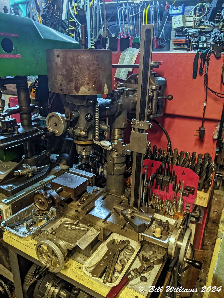

              I’ve only speed read the above replies, but haven’t seen my proposed solution to the issue, as I also currently lack the line of sight to a wall for the laser in my current setup for the Dore Westbury.
              I will go down that route eventually.
              Height Gauge makers go to great lengths to ensure the column is vertical with respect to the base.
              My plan is to use a height gauge on the mill’s table when required, with any easily removable clamp.
              On the sliding part, affix a suitable DTI/Clock.
              Set it to impinge on a particular vertical flat bit of the mills head.
              Raise/lower the head to the required position, slide the DTI up or down  the column, and then reposition the head accordingly.
              A cheap height gauge off ebay won’t break the bank, and if it comes with enough bits, it will have other uses anyway.
              Also, don’t discount the possibility of swinging the head about the column during a machining operation.
              I occasionally do that with the DW mill, when table traverse is too short to accommodate the job.
              Bill

                Not the best of photos, but I nipped out to the garage with the phone as a camera, just in case my explanation above isn’t clear.
                I will make a bracket, so the height gauge is turned through 90°
                Swing head away from a zero’d DTI, raise head, raise height gauge, swing head back.
                PXL_20240905_202559805_DxO-Facebook-s
                Bill

                  I totally understand your proposal and was looking at similar but using a drill rod as they are super cheap and straight.  And then use a dti against it to dial it back in.  But I think if it’s to pick up a feature again having a little locating hole on table or vice that you can use to realign to afterwards, between that and maybe using the edge finder which is very close it could probably deal with 99.9 percent of feature work where I did need to move.
                  The small cases where I work on small clock wheels or accurate parts, z travel isn’t an option as even spindle extension can cause issues. So they just all get done in the same close up setup.
                  For now all of the above are great options especially the ones at length from the column to give better accuracy.
                  Thanks everyone for your input, and I’ve got my immediate answer which is don’t change within a given setup.
                  Short term I am also fixing the rack to the column as it simply allows a stupid amount of ration for any head move and stopping this will actually help my z travel by another and hopefully with only a very small deviation.
                  If the rotation is important I can then decide if it’s a part that I am happy simply to pick up the vice edge or drilled hole on, or do I need more accuracy.
                  Most cases I will be happy to edge find or pick up the hole I’m usually accurate enough doing this as I still have no vice stop, so I hole find regularly enough lol.
                  Otherwise for edge cases the entire list gives me loads of simple solutions that can be setup in minutes and allow the head move without a permanent solution that needs fixing to the mill.
                  Thanks again to everyone for pictures, welcoming support and participation in this request.
