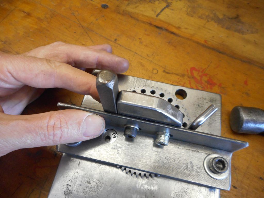

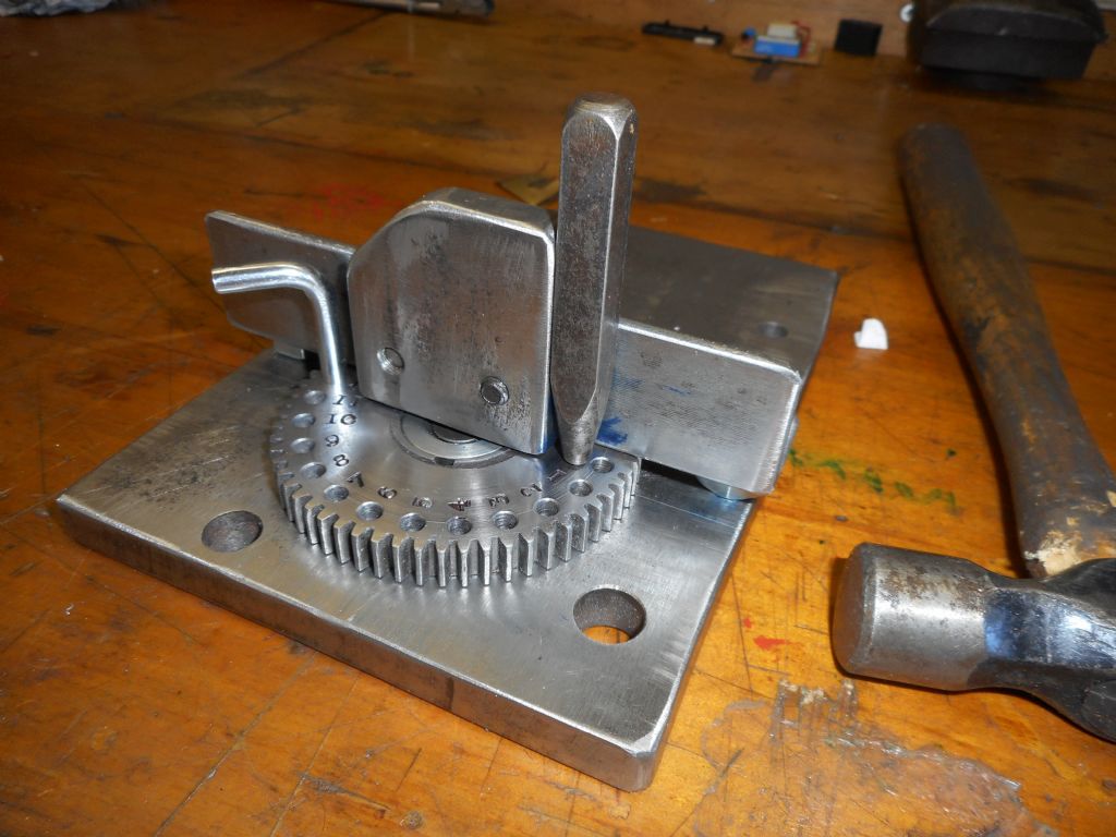

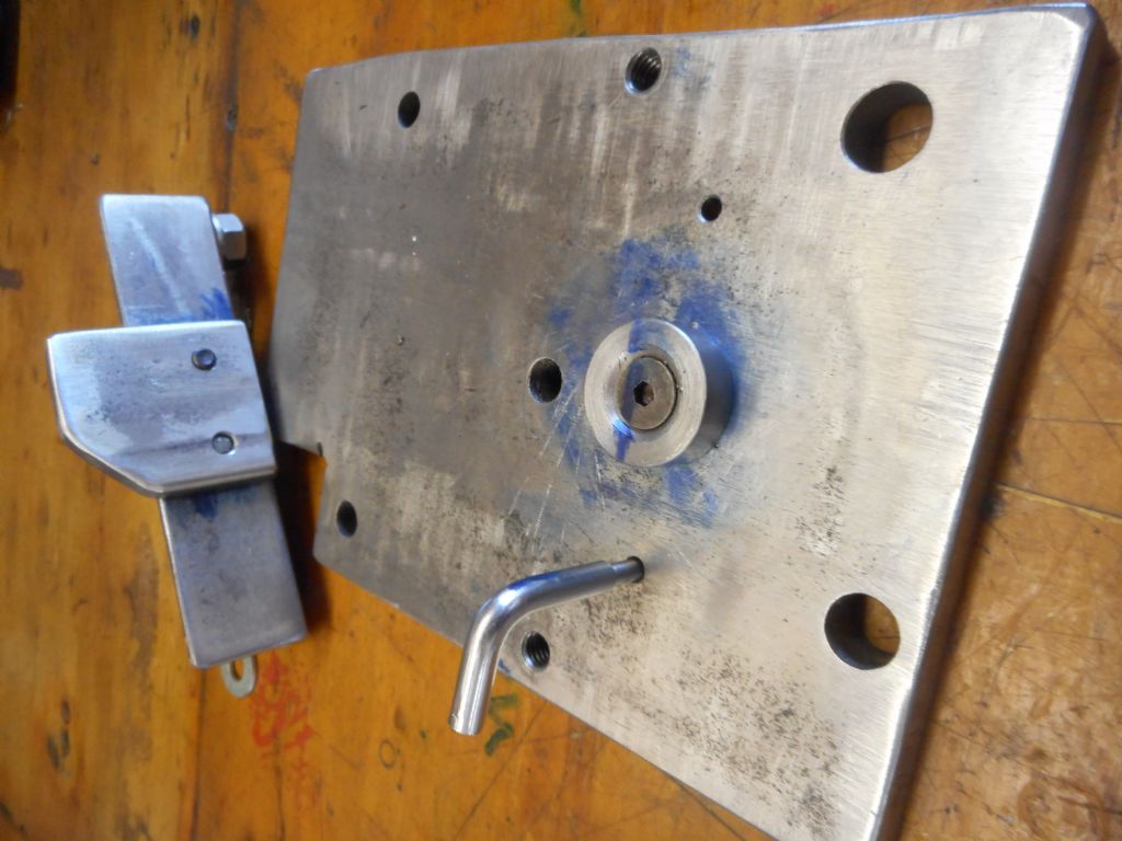

                          Depends on what you want to stamp the numbers or letters on to. GH Thomas's Universal Pillar Tool uses a holder for the punch then has the round lathe cross slide dial he is numbering held on an angle bracket below it.Bit more on it here LINKK
                          But if you are stamping on a flat surface there are other way too. One is to clamp a length of 1.5" angle iron on to the job and hold the punches against the angle iron one at a time as you whack them. You still have to use your own judgement for the spacing between letters or numbers. If you just line all the punches up at once, the spacing looks too wide.
                          Another way is to run a piece of masking tape along the job then you can feel when the raised letter or number on the punch hits the edge of the tape and so ensures a straight line. But unlike the angle iron, you have to hold the punch square so the letter or number is not lying over at an angle etc.

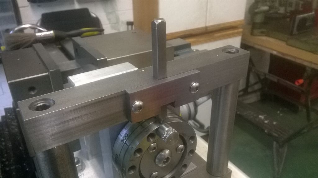

                          I've made up various special jigs for special jobs. For stamping numbers on the face of the indexing gear on a GHT Versatile Dividing Head I made a stub to hold the gear flat on a piece of plate, then a piece of angle iron went over the gear to hold the punch in place, with a vertical piece of steel screwed to the angle to hold the punch dead upright. Took longer to make the jig than to stamp the numbers!
                          #466885
                          Hopper
                            @hopper
                            Pics of jig mentioned in last post:

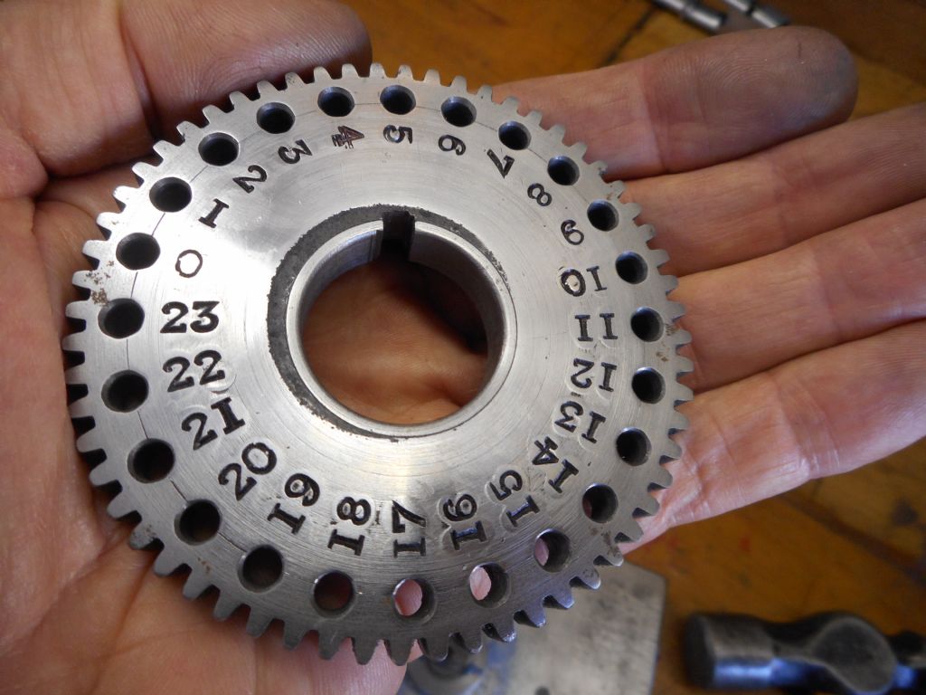

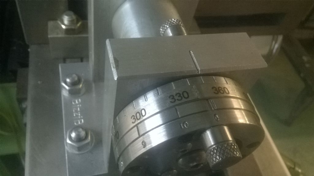

                                Hopper, counting fron zero to 23 appears to be an unusual way to mark a 24 hole dividing plate. Why did you do it that way?
                                #466910
                                  Posted by not done it yet on 25/04/2020 08:25:31:
                                  dont know
                                  It seems eminently logical to me
                                  The ‘o’ is just a marker, which can represent zero, or can represent 24
                                  … it may help if you think of it as numbered from 1 through 23
                                  … much like the 24 hour analogue clock dial
                                  Edited to improve clarity

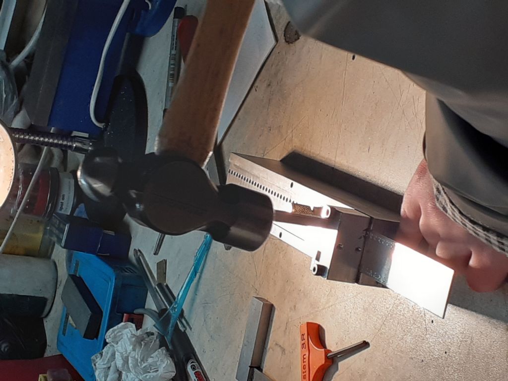

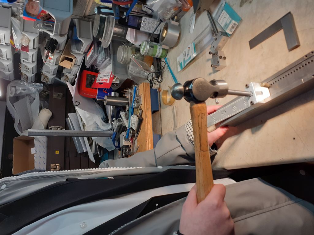

                                              Just to show that there's more than one way to skin a cat ….
                                              I had need of a means to stamp a lot of numbers on a couple of circular plates and made the jig shown below to acheive that. (The picture is a photo set up, not how it was actually done!)
                                              Number stamping jig
                                              I wasn't entirely (at all, actually) satisfied with the results, so ended up remaking one plate and redoing the marking. Instead of engraving or punching the numbers, I tried drawing the scale in CAD on a strip of self-adhesive decal film such that the scale exactly fitted the circumference of the plate and the number positioning was "spot-on". Result:
                                              Numbers stamped-printed
                                              The decal film won't be as durable as engraving or stamping but has the advantage of being readily replaceable when it has deteriorated sufficiently. You can compare the difference betwen the two methods for yourself.

                                                  #467122
                                                  Hopper
                                                    @hopper
                                                    Just easier to use that way because it is numbering the spaces rather than the holes. (The gear is for direct indexing on the Versatile Dividing Head) AFAIK it's standard procedure on commercial spin indexers and the like.
                                                    For example, if drilling 3 holes in the job, I set the indexing pin for the first one at 0, move it to 8 for the second hole and 16 for the third.
                                                    If I started the number stamps at 1, I would have to drill my holes with the index pin at 1, 9 and 17, which makes it harder to work out and harder to remember. Or I would have to remember to start on hole 24 then go to 8 and 16. Seems easier to me to go 0, 8 and 16.
